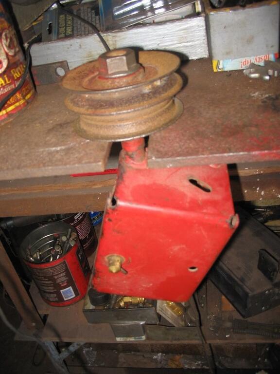

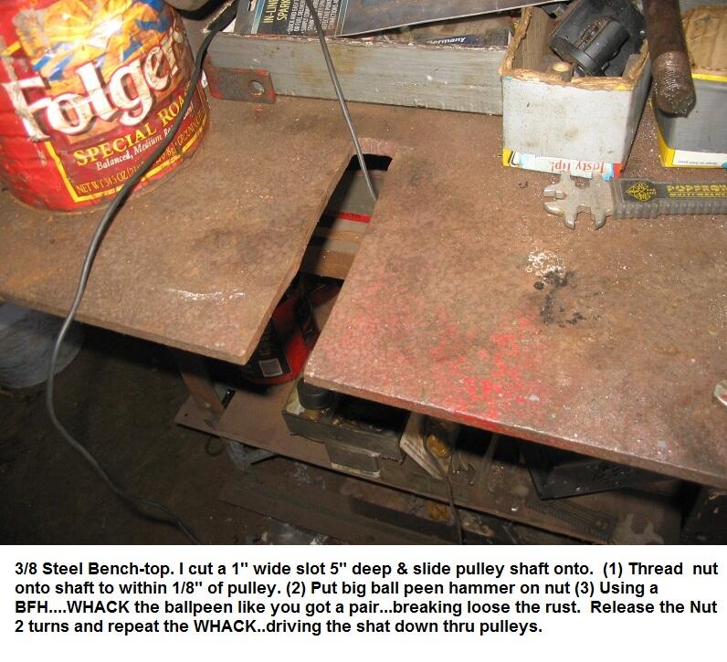

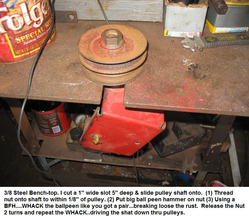

daveoman1966 3,768 #4 Posted September 11, 2024 I know the pulley get stuck on the mule drive---very tough to get off without damage. Here is my method. I cut a 1" wide slot 6" deep in the top of my workbench made of 3/8" plate steel. (1)Take the mule drive cover off. (2) slide the mule assembly inner pulley into the slot so the pulley lays flat on the surface. (3) thread the big cover retaining nut back on to where it is flat with the end of the shaft. (4) hold a ball peen or brass hammer on the flat of the big nut (5) whack that brass or ball peen with a bigger hammer. This hasn't failed me yet... 2 Share this post Link to post Share on other sites
