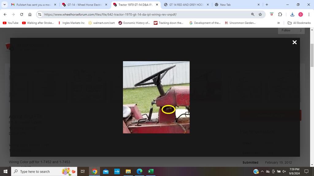

953 nut 57,453 #6 Posted September 8, 2024 (edited) @cumminscook, as Garry said we need a bit more information to provide a correct answer. The model number tag is on the right hand side of the dash tower, we need to know that number to know what electrical system you have. First, are you sure you need a new ignition switch? What is or isn't happening that leads you to think a new switch is needed? What trouble-shooting have you done? Looking at the hood decals on your GT-14 it may be a 1970, here is a link to information on it. https://www.wheelhorseforum.com/search/?&q=GT-14 1970&type=downloads_file&nodes=8&search_and_or=or&sortby=relevancy Edited September 9, 2024 by 953 nut Share this post Link to post Share on other sites
