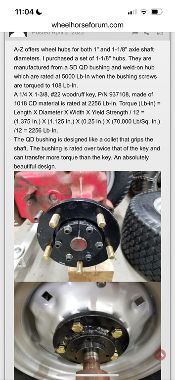

Rockcrawler69 15 #27 Posted September 17, 2024 (edited) So my plan is to use this strictly for a 2 stage snowblower and the occasional garden rototiller, when I find one. Obviously my axle is shot. I’m wondering if something like this from A-Z will get me by or am I stuck replacing the axle? Edited September 17, 2024 by Rockcrawler69 Spelling error Share this post Link to post Share on other sites

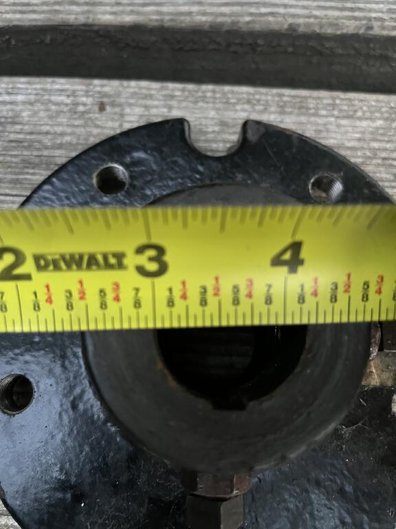

Ed Kennell 40,477 #28 Posted September 17, 2024 3 hours ago, Rockcrawler69 said: Well Ed Kennell called it. 1 1/8 hub on the one inch axle. With the amount of movement in your video, that was a gimmi. 1 Share this post Link to post Share on other sites
Ed Kennell 40,477 #29 Posted September 17, 2024 4 hours ago, Rockcrawler69 said: So my plan is to use this strictly for a 2 stage snowblower and the occasional garden rototiller, when I find one. Obviously my axle is shot. I’m wondering if something like this from A-Z will get me by or am I stuck replacing the axle? I think you have an excellent chance using the A-Z collet hubs. You may need to move the hub inboard more than normal to make use of the better axle surface. Spacers could be used to move the wheel back out. The hub should span and strengthen the damager area of the hub. You could also weld up and hand grind file the damaged area. I have had success in rebuilding bad keyway 1 Share this post Link to post Share on other sites

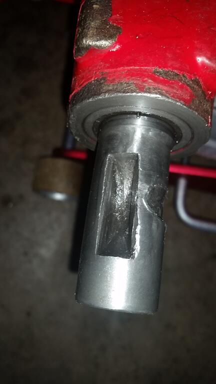

lynnmor 7,559 #30 Posted September 17, 2024 You need to replace the axle(s) and hub(s), the tapered hubs offered by A-Z won't have enough travel to clamp on your junk axle(s). The left side axle isn't too hard to replace, the right side is a bit more work. Axles on a 520H have no extra length for moving a hub, so that is not an option. Apparently the expert "mechanic" ran that thing with a missing key till it cut the axle down like it was in a lathe, pop that damaged seal out so you can measure the actual axle diameter, maybe he did swap the transmission but I doubt it. Makes me wonder what else the numbskull knackered. Just so you know, a hydro tractor is a very poor choice for rototilling, it is impossible to control the forward speed. Share this post Link to post Share on other sites

Ed Kennell 40,477 #33 Posted September 17, 2024 7 hours ago, lynnmor said: Apparently the expert "mechanic" ran that thing with a missing key till it cut the axle down like it was in a lathe, pop that damaged seal out so you can measure the actual axle diameter, maybe he did swap the transmission but I doubt it. I gotta disagree Lynn. Looking at his axle picture, you can see the key is clearly in place and undamaged. You can also see the perfect axle gouge created by the locking screw that he kept tightening in a feeble attempt to hold the wheels on until he sold his screw up. The lock screws slipped and turned until the they contacted the axle metal that was supported by the key. I don't know if Eaton ever made a 1100 with 1" axles or if it is possible for 1" axles to be installed in an 1100, But I do think this PO probable replaced or rebuilt his bad 1100 with 1" axles and was too cheap to buy the correct 1" hubs. Then patched it together long enough to sell it. 1 Share this post Link to post Share on other sites

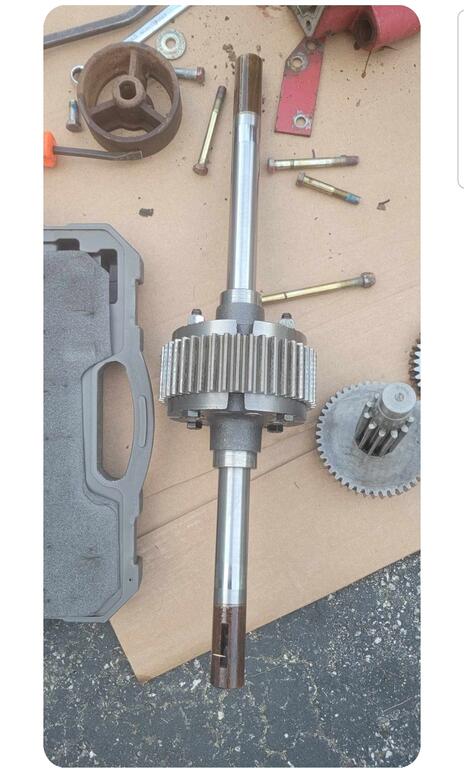

Handy Don 13,340 #35 Posted September 17, 2024 9 hours ago, Bill D said: Not sure where you are in NY, but you might try looking online for a replacement transmission. There were some listed in the classified section awhile back. It might be easier than opening up that one and changing the axle. If you do decide to change the axle cleanliness is paramount. If you get dirt in that transmission you'll wipe out the hydro pump. I just recently extracted the hubs and axles/diff assembly from a 400 hour 518-H rear end. I suspect these are the same as the 520-H. If you decide to go with a repair vs. full replacement, drop me a PM. 3 1 Share this post Link to post Share on other sites

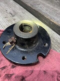

Rockcrawler69 15 #40 Posted September 28, 2024 Well, after further investigation I stand corrected. Sorry Ed, I was wrong. It is a 1 1/8” axle and the hub just wore the snot out of it. 🙃. Got the right side hub off, everything looked good, put it back on, tightened it up and no more wobble. I’ve got a friend willing to tear into the it with me who says the machine is nice enough to fix it right so as of right now, going that route. It is half tempting to just weld it as Wallfish suggested… If we tear into it I’ll post some pix. Share this post Link to post Share on other sites

Rockcrawler69 15 #43 Posted October 11, 2024 I lucked out and found some parts from a great guy in New Hampshire! I bought a hub, and the rear axles, no housing. I was only wanting the left axle and fortunately he offered to leave the two together for the price of the left side. Should have time to rebuild it in a couple of weeks. 1 Share this post Link to post Share on other sites
