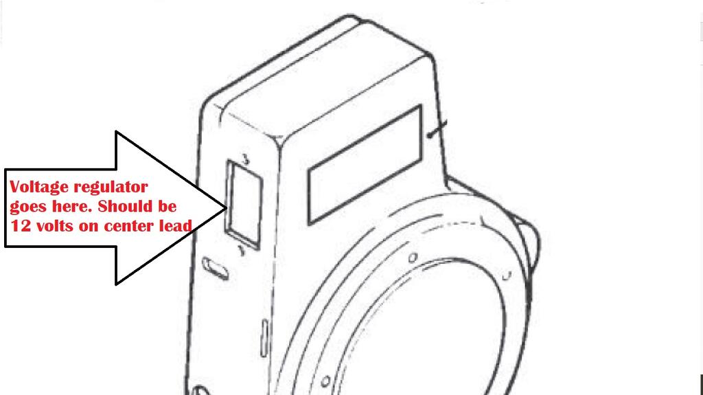

953 nut 57,839 #8 Posted September 7, 2024 5 hours ago, Dgilmored said: plenty of room for the 3 wire version. Not all three wire voltage regulators are created equally. You need the larger voltage regulator with a bid heatsink unless you will be mounting it in the fan shroud where it will have a cooling flow. Share this post Link to post Share on other sites
