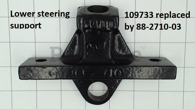

gwest_ca-(File Mod) 11,205 #2 Posted September 6, 2024 This one? Used by many models so a good used one should be available. Place a wanted ad in our classified section. It is no longer available from Toro. https://www.wheelhorseforum.com/classifieds/wanted/ Use [Add new classified] in red box. Include your approximate location. One may be not far away. 1 Share this post Link to post Share on other sites

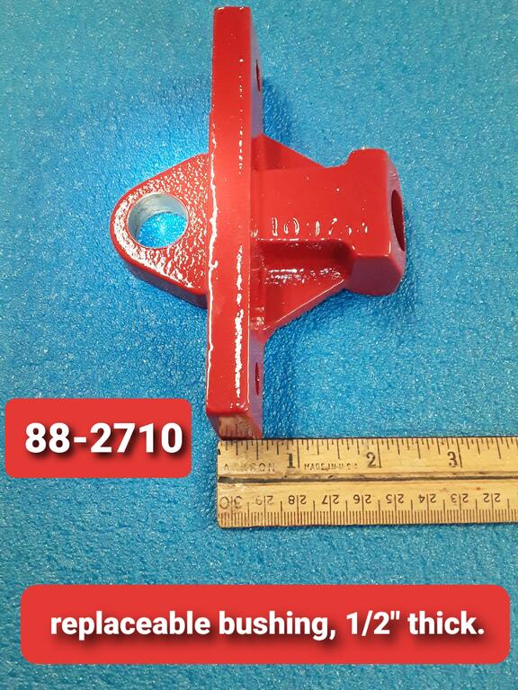

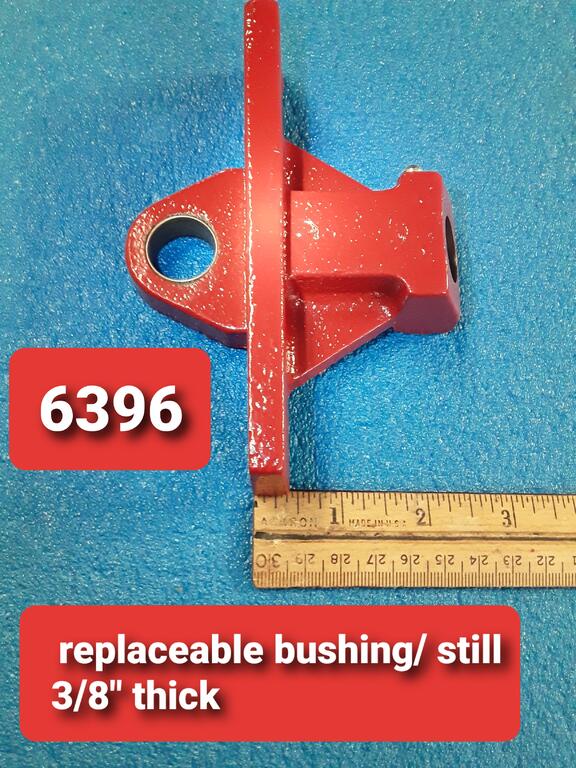

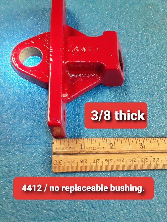

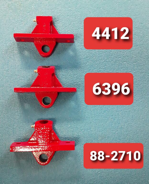

ri702bill 8,894 #3 Posted September 6, 2024 Just a note - there are several variations of this block - early ones had thin mounting tabs that are prone to breakage and no thinwalled bushing in the lower hole. Next they added the thinwalled bushing in the lower hole to the same casting. The latest(?) is the best choice - it has the bushing and the mounting tabs are thicker....... Share this post Link to post Share on other sites

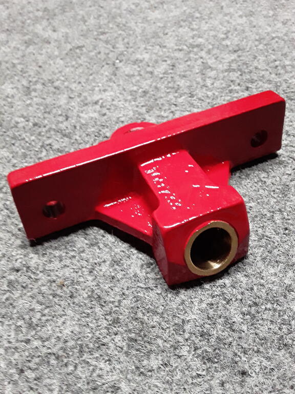

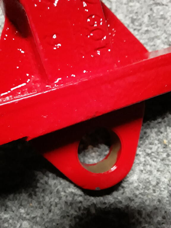

76c12091520h 3,747 #5 Posted September 6, 2024 (edited) New and reconditioned are in stock, private message sent. All our reconditioned supports have been rebushed top and bottom and range from $45-$55 depending which one you choose. Edited September 6, 2024 by 76c12091520h 3 6 Share this post Link to post Share on other sites
ri702bill 8,894 #6 Posted September 6, 2024 Excellent pictures & writeup to what I said earlier..... Share this post Link to post Share on other sites
