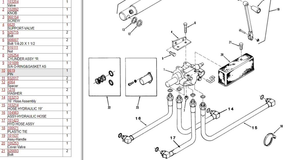

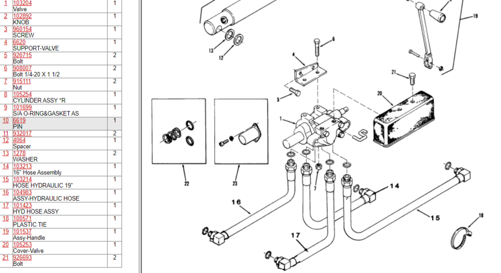

daveoman1966
There are O-rings in the 'cup'--- item #22 in this schematic, although a part # for item #22 is not given. These O-rings are on the shaft in the body of the hyd valve.

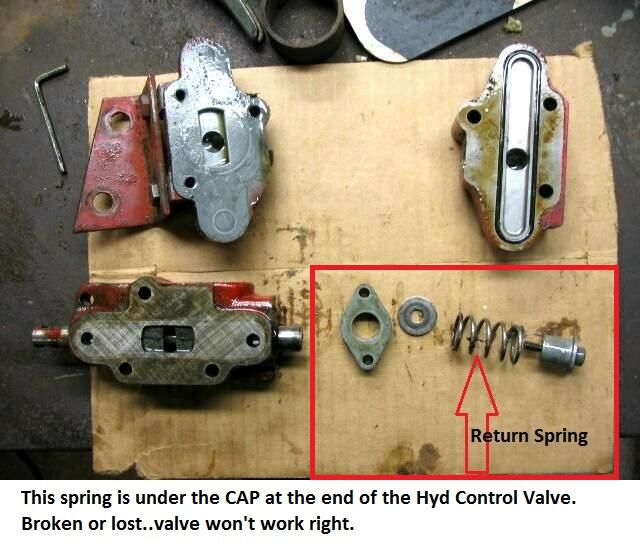

daveoman1966
This is a better pic of what the control valve look like.  121422046_CTRLVALVE(3).jpg.4a2d83b67bcfb619a0a55920186b6bee.jpg
