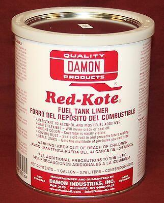

Racinbob 11,449 #3 Posted September 3, 2024 I highly recommend Red-Kote tank liner because I know it works and after many years it gives me no reason to think it's not permanent. But whatever you use cleaning is the key. I use several methods from what John does to solvents and others. The actual coating process takes no time but cleaning will take days. 1 3 Share this post Link to post Share on other sites

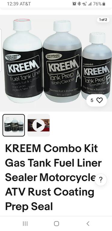

gt14rider 814 #4 Posted September 9, 2024 Red-kote works very good or Kreem's kit works well on small gas tanks, preparation is the key, clean, rinse, clean rinse, air dry, had good results in the past. 2 Share this post Link to post Share on other sites
