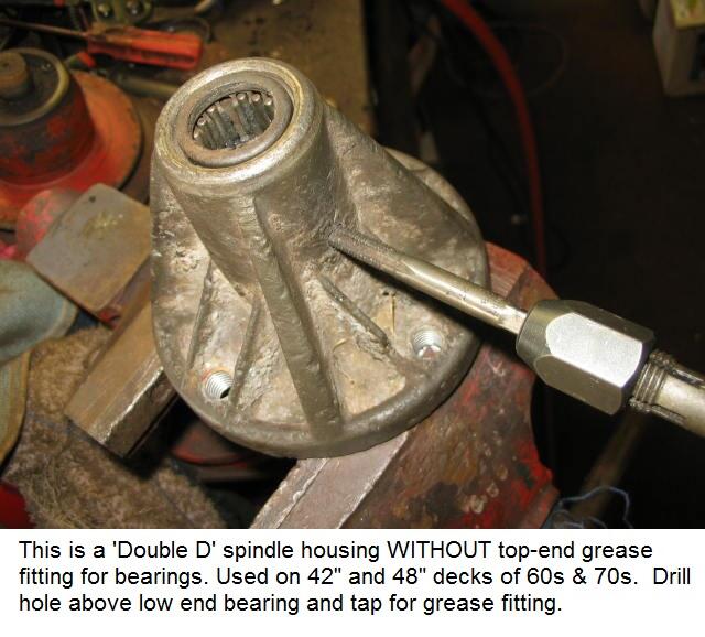

daveoman1966 3,752 #4 Posted September 1 I put a grease zerk in the old 'Double-D' style spindles. Here is a pic of what I did. Worked out well and I sold the 42" side disch deck a few years ago. Share this post Link to post Share on other sites

jamesfranklincollins7@gma 2 #6 Posted September 1 8 hours ago, daveoman1966 said: I put a grease zerk in the old 'Double-D' style spindles. Here is a pic of what I did. Worked out well and I sold the 42" side disch deck a few years ago. The bearings in my deck are solid not double so I will have to drill a hole in the race first then drill a hole for tap. They are dry now and will hardly turn. I'm hoping to save them. I'm a poor man and can't afford 140 for new ones. Share this post Link to post Share on other sites
