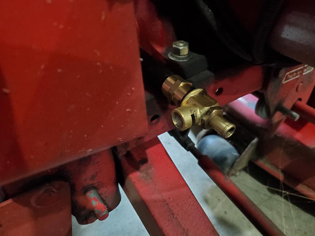

All my tractors have either a Fumoto or EZ Drain valve. This one is a Fumoto.  A piece of plastic tubing into a jug makes for clean draining. Most are 3/8" NPT.

There are different styles of 90° fittings. Some of them, especially brass, will fit in tighter spaces. You may have to lift the engine a little bit to spin it on. I've never seen one yet where it can't be done. Whatever it takes it's worth the effort. :)

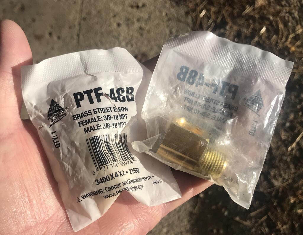

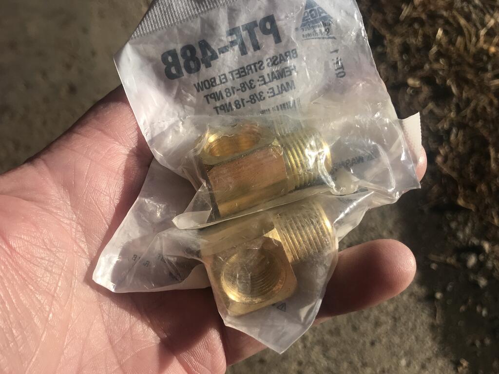

Turns out the Ace at my location doesn't stock anymore. Found another supplier AGS Co. out of MI I think. Ace wanted 9.00 bucks,C0FD09B9-7805-4EF4-9DA2-45F1B78520F9_1_201_a.jpeg.eff058e9ec1639b274d8d6a759012b76.jpeg AGS had them for little over 2.00 I got two at that cost plus shipped UPS free. Have under 5.00 bucks in the pair. Just thought i'd pass the info on. Now to the EZ drain valve....

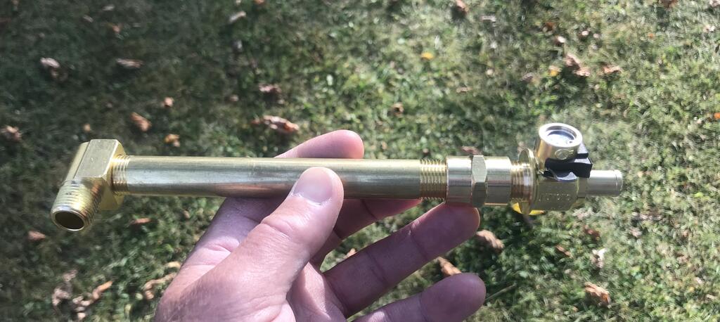

Decided to go with the Fumoto, found a site which had them for 33.99 no tax shipped. https://industrialtecsupply.com/
Going all brass, should there be a thread sealant used and if so what would be recommended ?

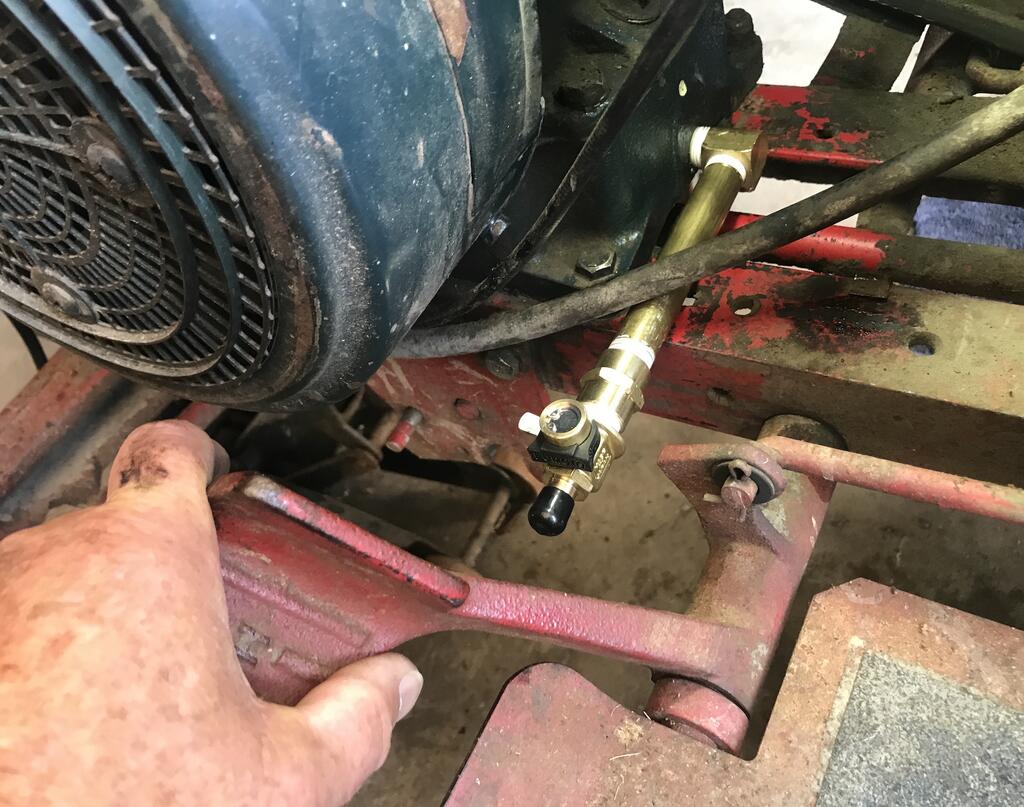

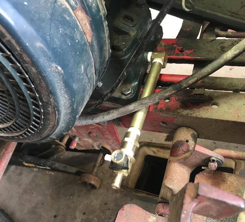

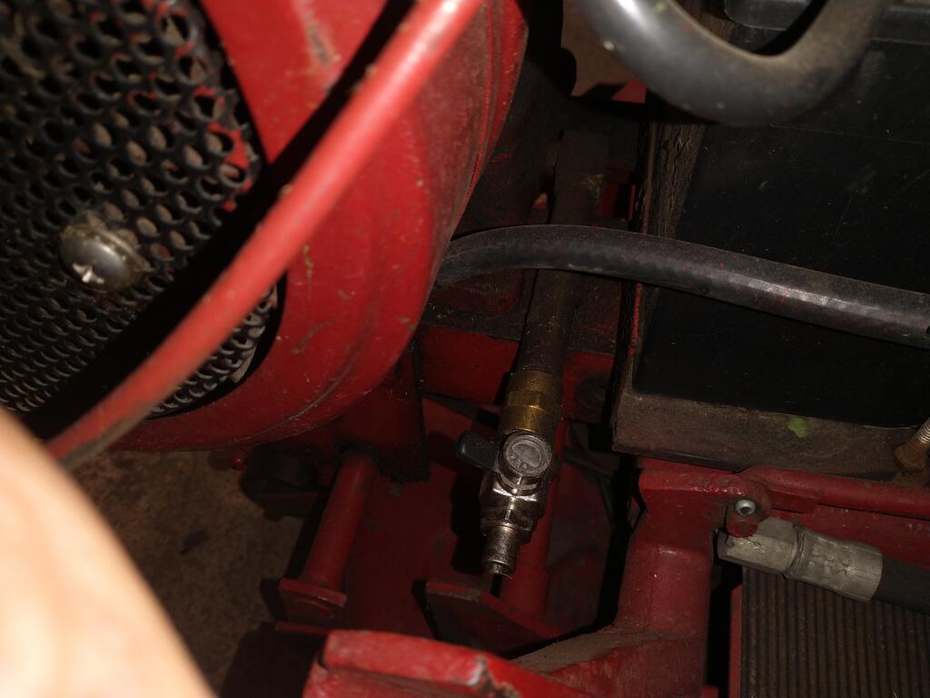

All is ready for next oil change. Think I’m going to like this set up.
WHX??
Any quality pipe dope or tape will do. Like penetrating oil everyone has their favorites.
rustyedge1
Glad I bought both 6" and 5" nipples the 6" puts you too far out and bumps the clutch peddle arm after assembled, the 5" in my opinion is just right.
