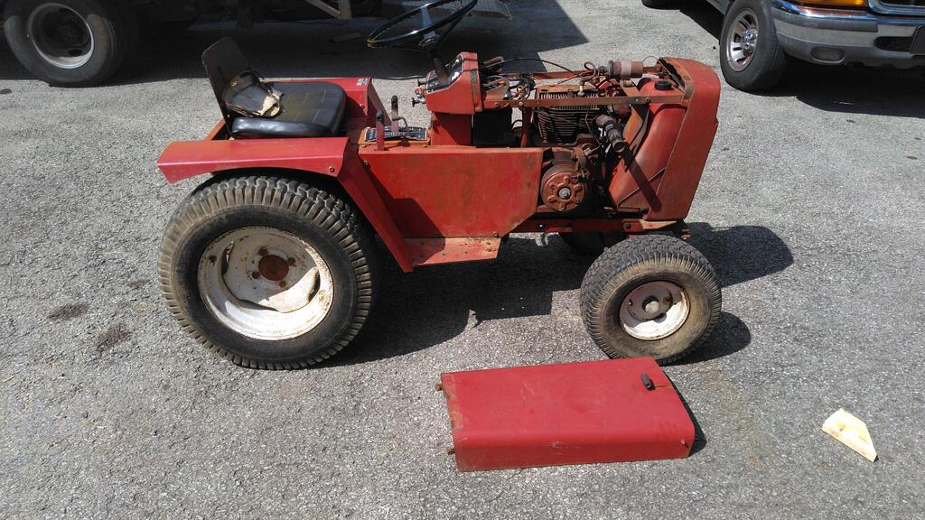

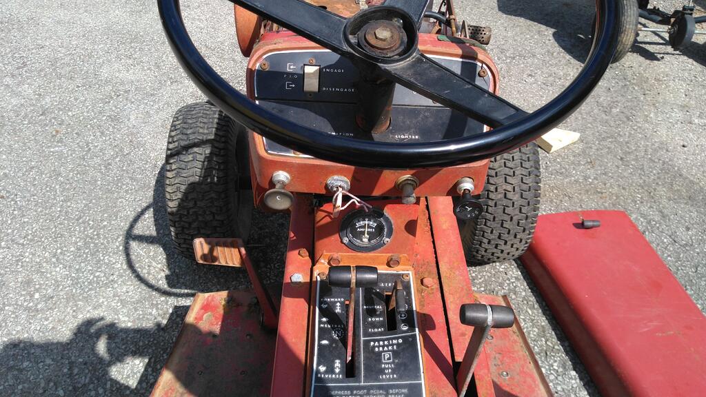

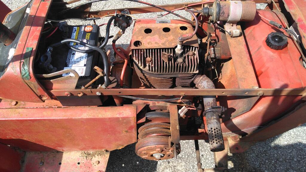

BurtB 88 #32 Posted August 23, 2024 Forgot to post pics of my GT-14. We changed battery, oil, fuel filter, trans filter, and trans fluid today. Forgot to grab an air filter. Tractor will now spin tires if rider-less against a tree. Right wheel spins if I'm sitting on it. Doesn't sound great, it will need engine and trans rebuild. PTO clutch is stuck on. Electrical is a mess, have one wire with a break that I have to jiggle with to get it to start. Will throw a wire nut on it until I redo electric. 2 1 2 Share this post Link to post Share on other sites
Sailman 1,299 #33 Posted August 23, 2024 That GT 14 is a real beast. As others mentioned the attachments are different than what most other wheel horse models will use. PTO staying on is likely a bad switch. Its an electric switch so likely needs replacing. 1 Share this post Link to post Share on other sites
