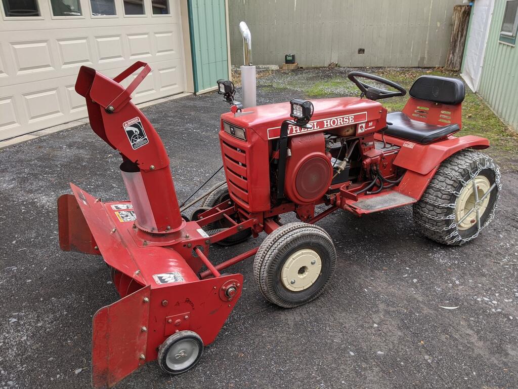

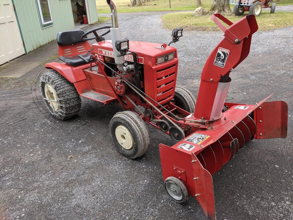

cumminscook 60 #1 Posted August 17 have a c-125 looking for pics on how to hook it up its a single stage blower Share this post Link to post Share on other sites
rjg854 11,399 #2 Posted August 18 (edited) Hope this helps you. If you can enlarge the pictures you should be able to see things better. Edited August 18 by rjg854 Sp 1 4 Share this post Link to post Share on other sites
cumminscook 60 #3 Posted August 18 Dude that helps a lot thanks so much 1 1 Share this post Link to post Share on other sites
Ed Kennell 38,395 #5 Posted August 18 Be aware the early blowers could have the quick attach mounting kit like shown in Randys pictures or a frame mounting kit that uses a long bolt thru the two front holes in the frame. 2 Share this post Link to post Share on other sites
