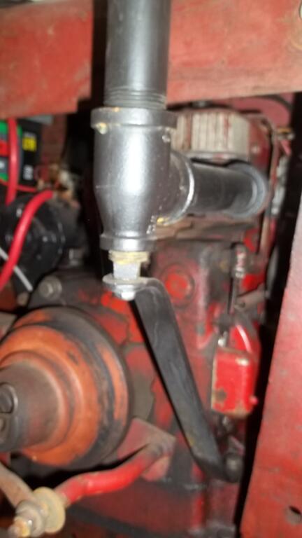

953 nut 57,834 #10 Posted August 18, 2024 You will end up having a fair amount of weight hanging off from a few threads on the pipe. I have used a black iron "T" with a plug at the bottom which is drilled and tapped to 1/4-20 to brace the stack. Properly supporting the weight will prevent problems later on. 3 1 Share this post Link to post Share on other sites
ebinmaine 70,662 #11 Posted August 18, 2024 @tallen4392. @953 nut makes a very good point. Here's what I did on my 1974 C160-8 Cinnamon Horse. 1 Share this post Link to post Share on other sites
