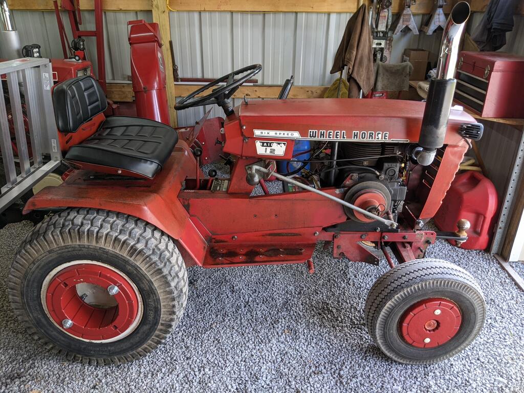

Anyone put a stack muffler on their machine  that has a ! inch threaded nipple onto a 12 hp with a 1 1/4 pipe coming out of it the elbow I have found are 1 inch  both sides .THANKS
rjg854
1 1/4" X 1" reducing elbow.
Ldr Industries 1-1/4" x 1" Black Reducing Elbow
tallen4392
yes that is what i ordered on hd online only part  i think that it what i need  u would think there would be more people that could use it nice and clean set up ..Thank You
