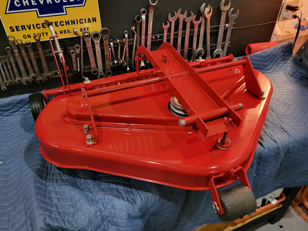

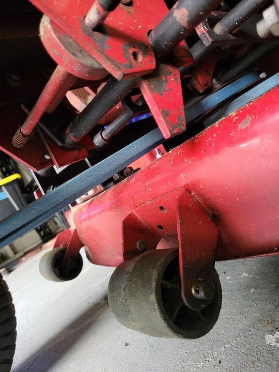

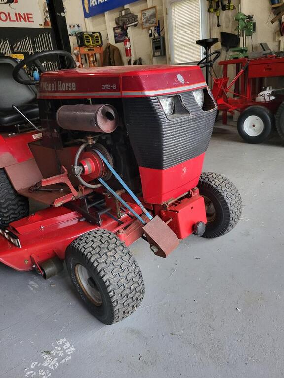

matt monte 132 #1 Posted August 16, 2024 Im finally at ropes end regarding this issue. I have a 312-8 that was primarily used for snowblower use but decided to use her more often when a deck came up for sale local last year. I like it alot better than the RD 36in on my 308-8. The 42in has mulching blades that produce very little clumping of grass on lawn. Ive read up countless articles here as well as manuals on height adjustment. My chief complaint was at 1st deck height. was cutting at 2.5in....little short for my liking. Spent 2 days messing with it. got blade height to 3in by changing rear wheels, good enough i guess. now im noticing its not cutting 100% even, meaning i feel there is like a 2in strip of lawn not cut level, if that makes any sense. If i make a second pass i get it acceptable, but i shouldn't have to. Things ive done to attempt to remedy issue: Set tire pressure with deck on level surface in center setting, adjusted rear rod with a level on deck, got it level then back off one turn to pitch front a little as per manual. Sharpened blades changed deck belt greased spindles,checked for wear,make sure bar with spring moved with pressure to it changed pto belt from here im at a loss, i dont suspect bent deck, its not rusted either. Anything thing anyone feels i missed by all means, let me know Share this post Link to post Share on other sites

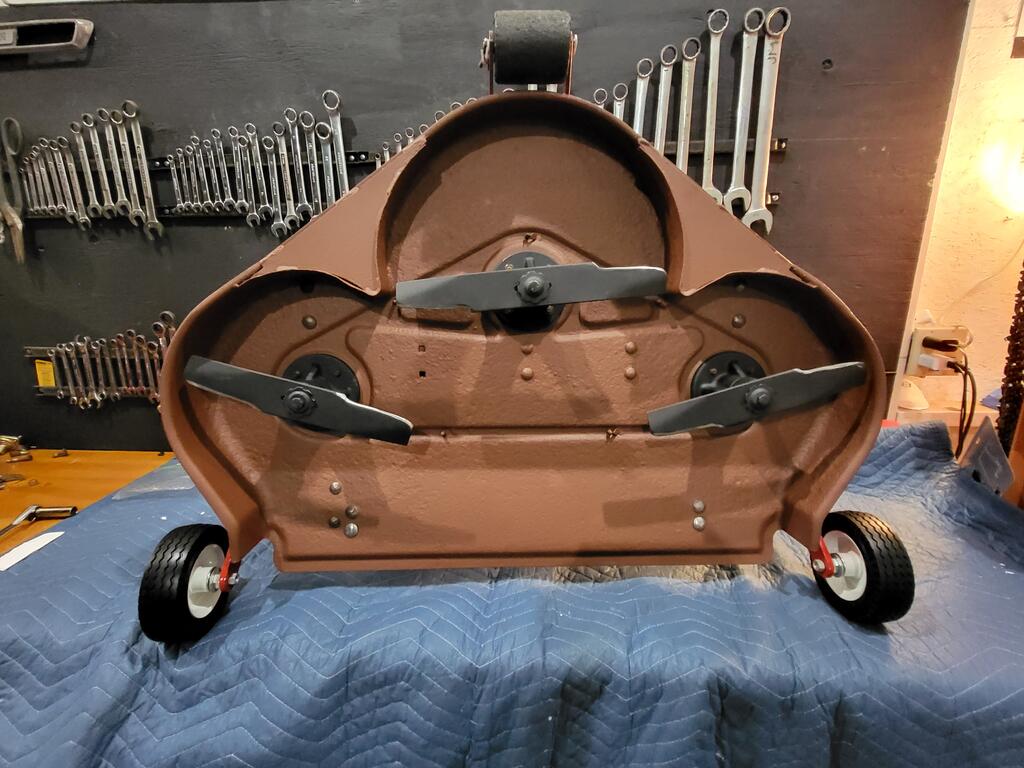

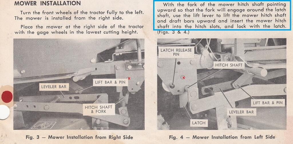

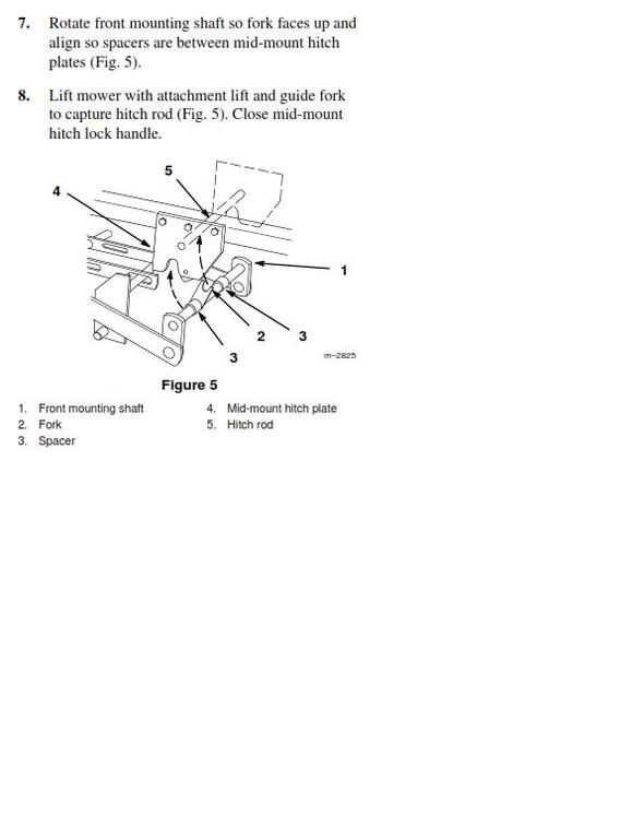

daveoman1966 3,768 #2 Posted August 16, 2024 Maybe deck is tilting.... you have it mounted correctly. Look at these pics... 1 Share this post Link to post Share on other sites
oliver2-44 10,082 #3 Posted August 16, 2024 Look for any excessive wear on the attach-a-matic parts or the corresponding attachment area on the deck. Also don't rule out a bent deck or bent area where a spindle attaches. When when i refurbished the 42" SD deck for my sons 312-8 I had to do a bunch of heating straightening with a rosebud torch. The PO had hit something and while there wasn't a big dent, the whole deck was bowed and the blades were not even due to the spindle area being bent. 1st try checking all blade tips to be the same height above a flat surface check with the blades side to side and front to back. You can shim a spindle with a washer if needed, but best to try and straighten. 2 1 Share this post Link to post Share on other sites
Rick3478 433 #4 Posted August 16, 2024 So to clarify, you put 7" wheels on it to get up high enough? It all sounds a bit odd. You are letting it ride on the rear (gauge) wheels and using them to set height, right? Not trying to use the lift handle to set height? Lift mechanism is off-center and doesn't work for that. It IS possible to put the PTO belt on wrong in such a way that the blades spin backward, and they don't cut worth a darn if you do that. It IS also possible to put the blades on upside-down, which makes them cut poorly and shorter than expected. There also can be airflow problems with some of the three blade decks. The left blade only has to handle its own clippings, but the middle blade has to pass the clippings from the left blade plus its own, then airflow makes a sharper turn and the right blade has to handle the flow of all three. So if the right blade can't handle all the flow, clippings or airflow may knock down grass in front of the blade gap area before the blades can cut it. Your mulching blades could make this worse. I've experimented a bit on a couple of my own decks, and what I've settled on is to make sure the right, final blade is the sharpest and has the best wings. I also had two blades on the right spindle at one point tack welded at right angle to double the cutting and blowing surfaces, and that seemed to work okay but not a whole lot better than a single blade in great condition. Don't know which if any of these apply, just putting it out there. 1 Share this post Link to post Share on other sites

matt monte 132 #6 Posted August 16, 2024 the rear deck wheels were wore down to 5 1/2. I grabbed used but not worn wheels measuring 6in. from a parts deck that somewhat helped. I never thought to measure all 3 blades in search of a bent one, never thought mount hitch could be wrong or pto belt as well. I will check all above mentioned things as well as snap a few pics to post. Maybe u guys will pick up on something im overlooking. To clarify the lawn cut doesn't look absolutely terrible but want this deck perfect. Im building a C-120 and want this deck for that. Want to put snowthrower back on the 312-8 and not do this deck swap every spring. I also have 308-8 & B80 with RD 36 decks, both run and cut out but afterwards i gotta break out the leaf blower dealing with pesky clumps. I never have that issue with the 42 SD. 1 Share this post Link to post Share on other sites

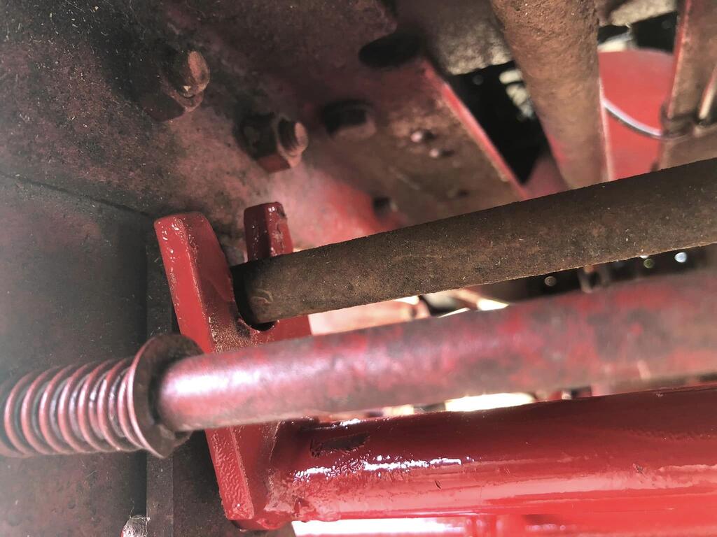

8ntruck 7,256 #8 Posted August 16, 2024 Check the shaft that the 2 brackets that the gage wheels bolt to for a twist. If those 2 brackets are not parallel when looking at them side to side, one side of the deck will ride a bit higher than the other. 1 1 Share this post Link to post Share on other sites

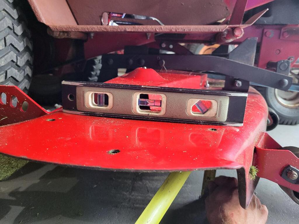

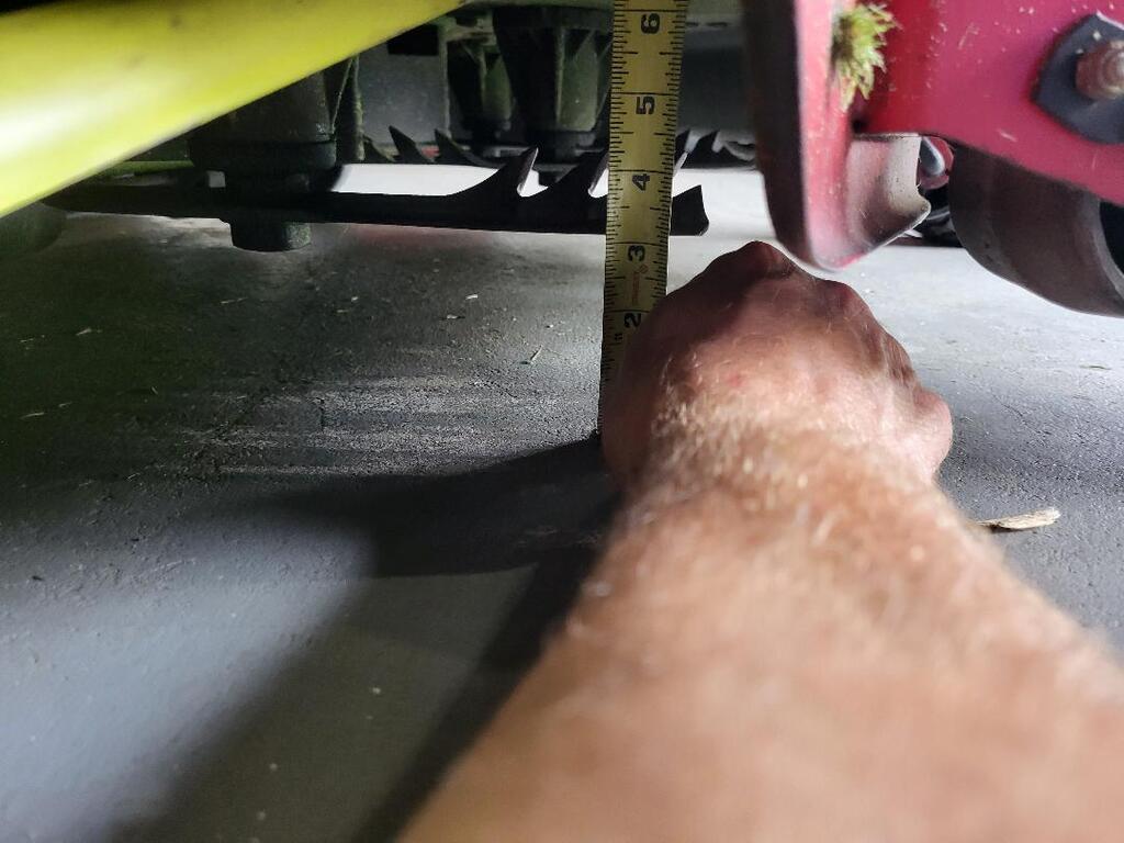

matt monte 132 #11 Posted August 19, 2024 so i definitely got something going on here. All 3 blades while close, are not in alignment. Far right is the lowest on, coming in roughly 3 3/16, far left coming in at almost 3 1/2 and center one slightly in between those. I noticed a decent size dent center of deck. I had to have done that. I media blasted and painted this a few years back, i would have remembered a dent. no clue what i hit. Lawn isn't terrible. cut wise but i want looking like Yankee stadium. i just ordered a deck leveling gauge like lynnmor suggested. getiing under there with a measuring tape is ghetto, probably not very accurate. I never even knew that existed,lol. Its looking more like a dent deck. i checked out that gage bar pretty good, seems level. once i get this tool i can more accurately determine what is the problem. ill most likely deal with this until the winter Share this post Link to post Share on other sites

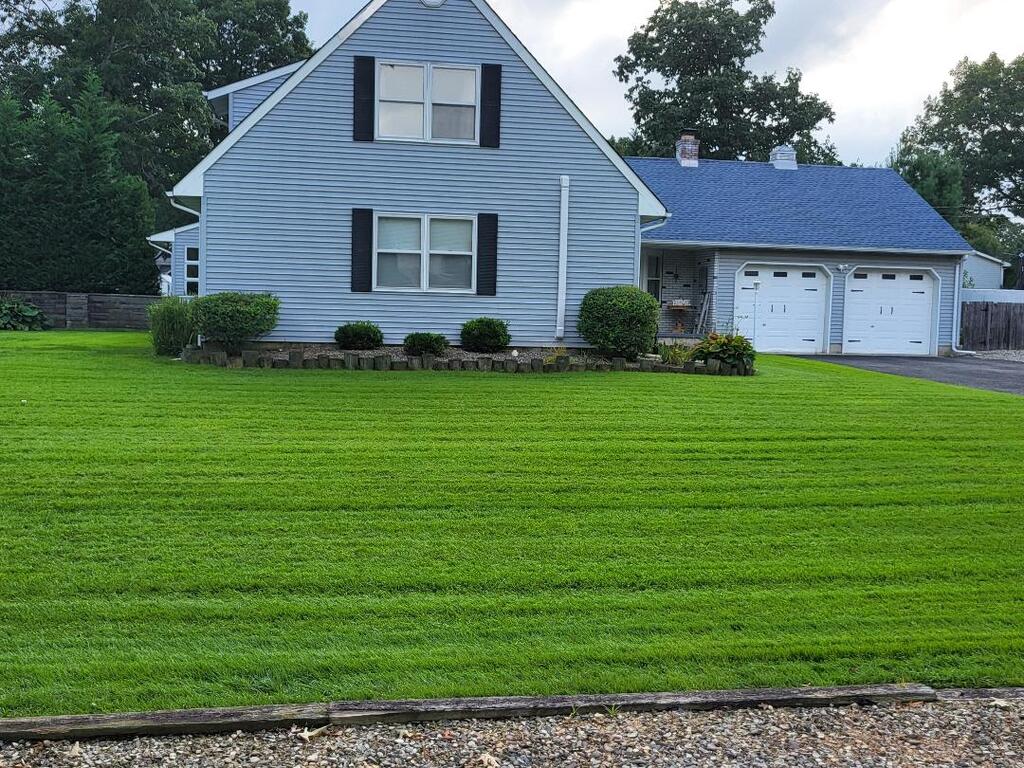

Lee1977 6,922 #14 Posted August 19, 2024 That looks like tire tracks in tall grass to me. Your lawn could be a lot softer then what we have down here. My lawn is as hard as concrete when dry and not much softer when wet. I had a new deck that cut lower on one side but the height wheel bracket was either welded wrong or was bent. The dealer replaced the wheel bracket. Share this post Link to post Share on other sites
matt monte 132 #15 Posted August 20, 2024 your correct about the wheels compacting the lawn, im guilty of watering a tad much, producing a soft environment but i have well water so i dont care, not getting a bill! pic doesn't show the small roughly 2in patch thats roughly 1/4 in to 1/2 higher i guess in the middle. as i make the next pass i over compensate to get it but sometimes miss. Around me most decks that come up for sale look like they came off the deck of the Titanic,lol. As soon as i get that tool to measure ill mess with it a little more and report back Share this post Link to post Share on other sites

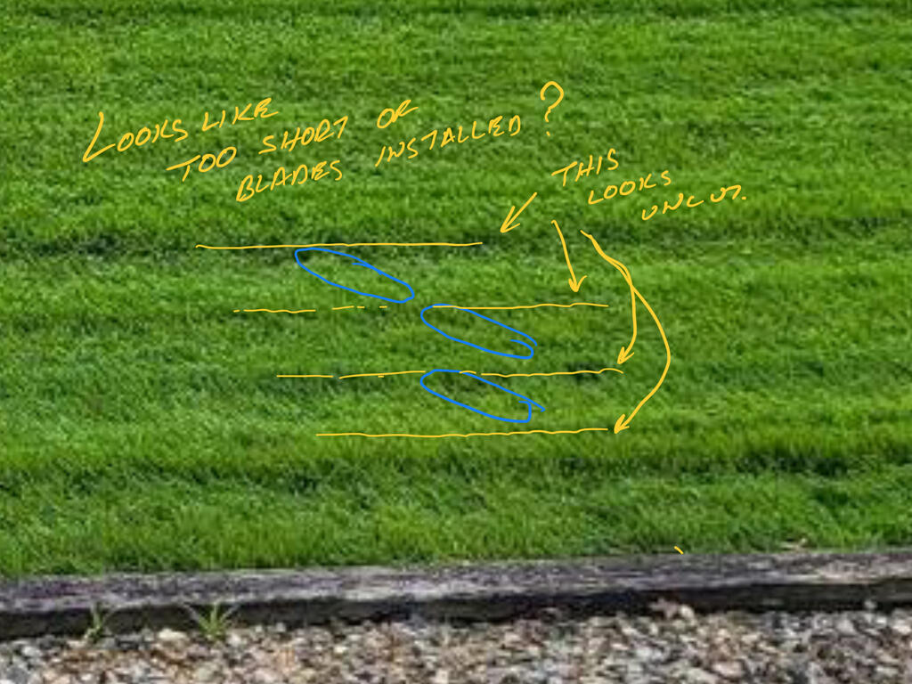

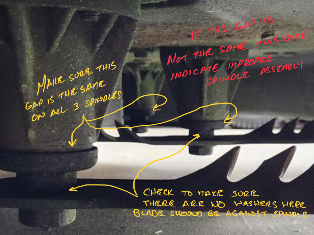

Steve Janninck 171 #16 Posted August 20, 2024 Matt, Here are my thoughts, not saying I am correct, just thinking out loud. So I am assuming all of the following are known goods. No bent spindles. No bent blades. Deck is attached appropriately to the tractor. From your picture of the lawn, it looks to me that all 3 blades are not the correct diameter, too short. This would leave a gap in between the rotors, not allowing strips of grass to be cut. The blade diameter is critical because blades are NOT timed and have very tight tolerance at the meeting points at the tips of the blades. I see you have the Gator Style Blades. Did you buy them or did the deck come with them? I put down some notes to try to explain what I have experienced with the spindle and deck alignment. Let me know if something is confusing, they are just chicken scratches. Also can you let us know the history of the deck? Just wanting to know if it ever had welding repairs or deck spindle cracks. I think we can get your deck back to cutting that golf course flat beautiful look! Steve Note Aug 20, 2024 WH Deck Cutting issues.pdf 2 Share this post Link to post Share on other sites

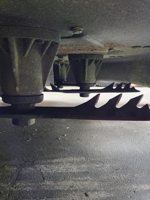

lynnmor 7,482 #21 Posted August 22, 2024 4 hours ago, matt monte said: With the rounded corners and the grinding on the bottom, I would call those blades spent. 2 Share this post Link to post Share on other sites

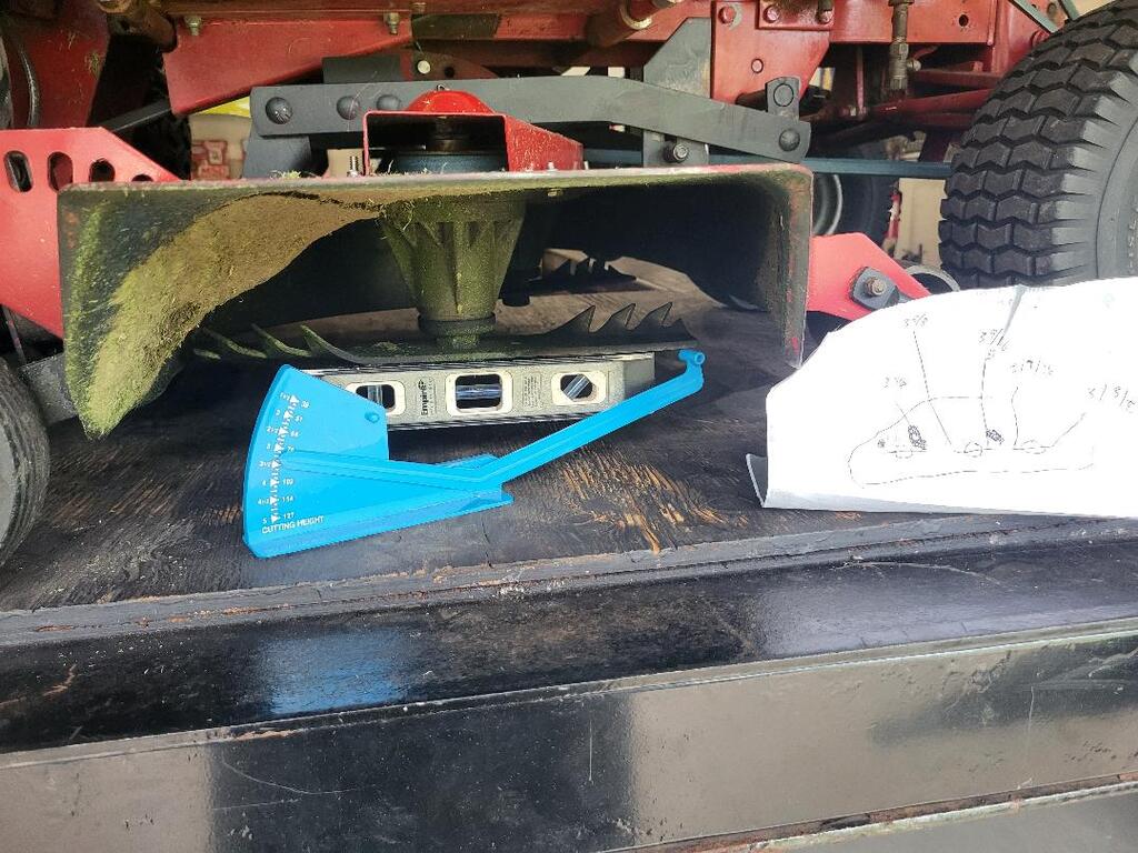

matt monte 132 #22 Posted August 27, 2024 wanted to give an update regarding my mower deck. left blade is level, right side is off less than 1/16 of an inch. The center one is way off, by more than a 1/4 inch! It appears bent, the spindle or deck, not the blade. After the mowing season, when i swap deck out for snowthrower, Ill mess with deck and replace blades, as well as the deck with worn blades. Im assuming the box stores are not gonna have what i need. This measuring tool is an absolute necessity. Without it your really wasting time. Its like timing a small block chevy without a timing light. Sure u can get her running, but you need a light for accuracy. Th ank you for all who responded and took the time to offer your insight. 1 Share this post Link to post Share on other sites
