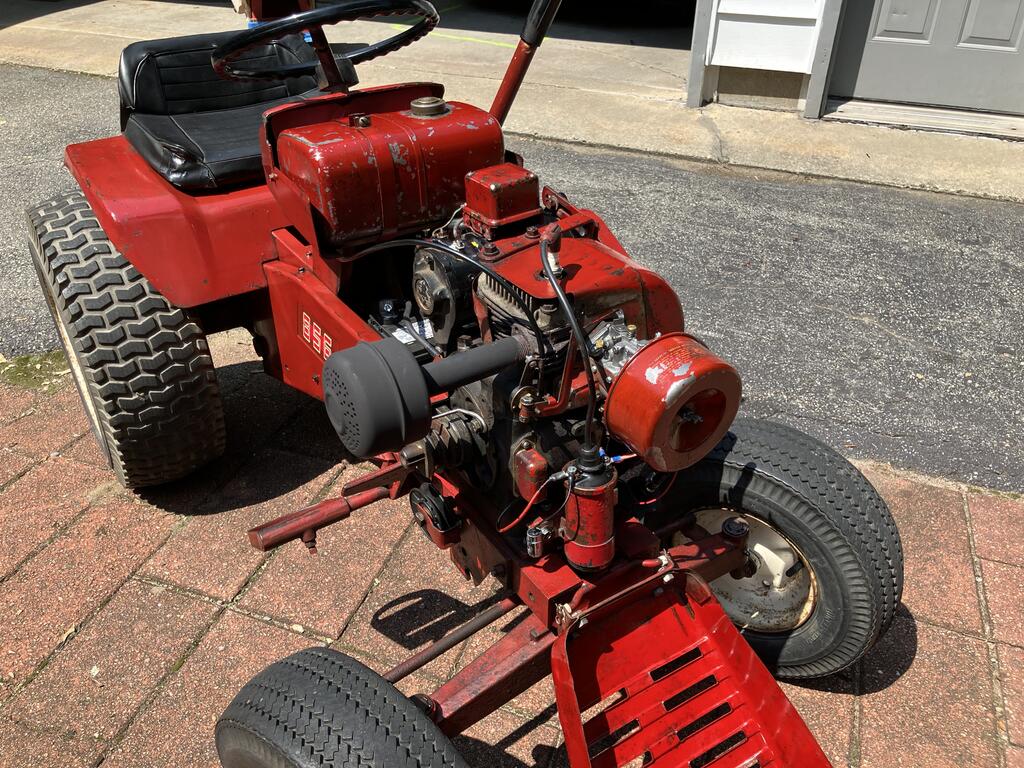

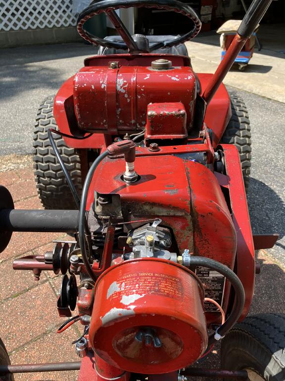

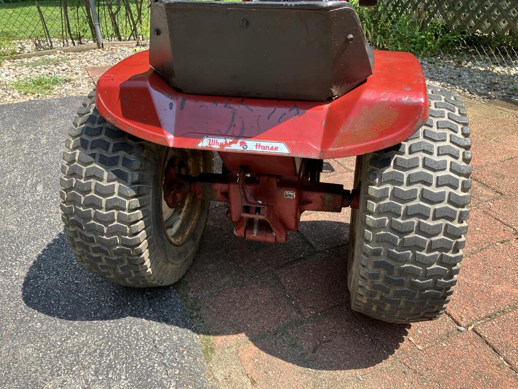

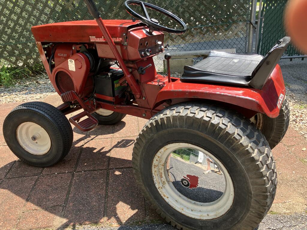

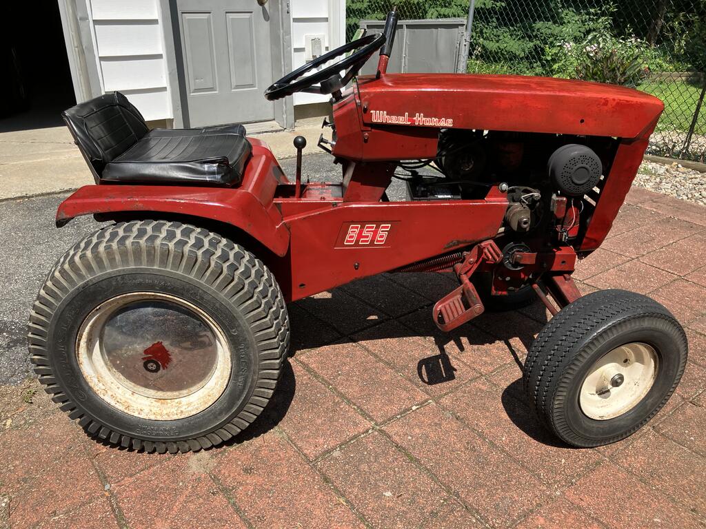

Big show tractor is done.
stevasaurus
I don't think you can beat a Short Frame Square Hood with a K-181-S for starting by snapping your fingers.  :occasion-xmas:  Both of mine start by looking at them...even in winter.  :USA:

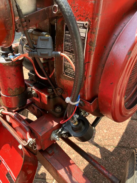

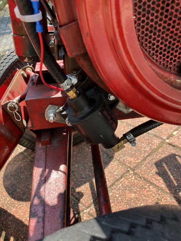

Thanks Steve! You are right. :handgestures-thumbupright:  But I need did a pump so that is where I am at. Hope you are well and enjoy the rest of the summer. Can not believe it is almost Fall.

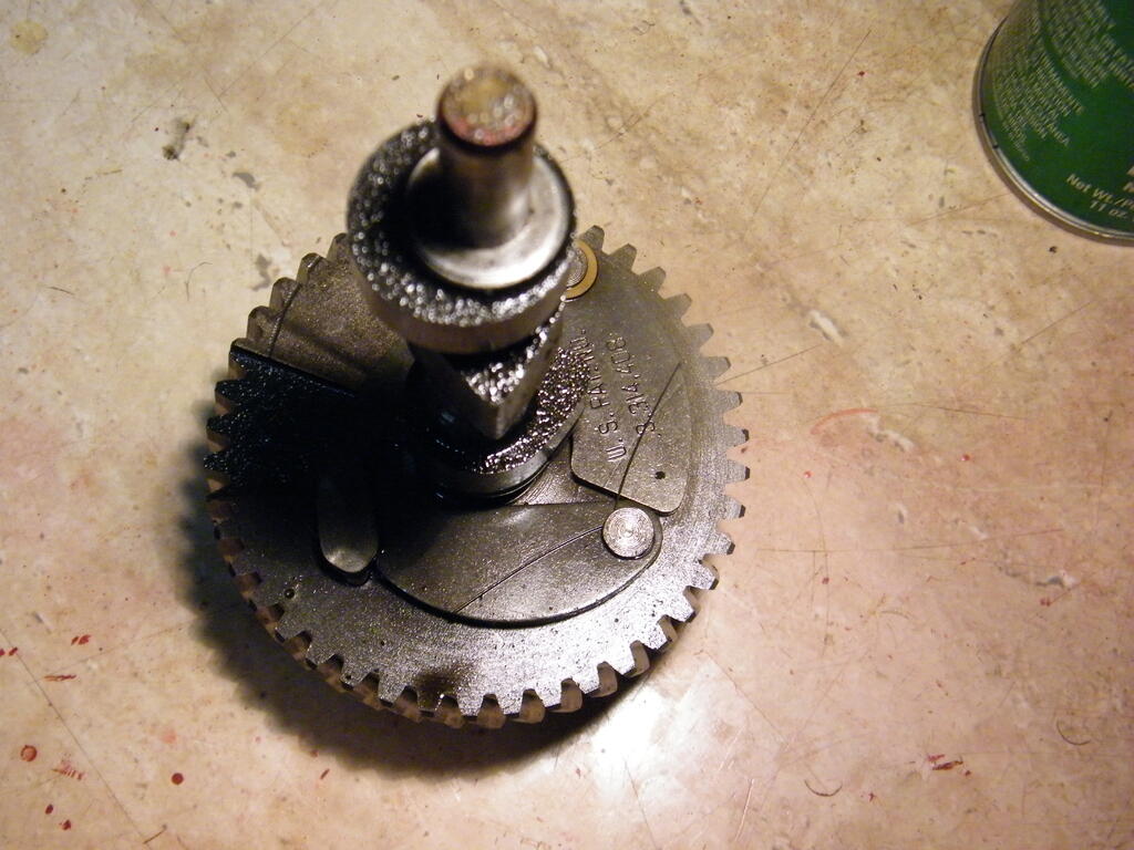

@Handy Don, if you are having trouble with the ACR...it is a weak spring in that mechanism and is probably broken.  Bad thing, you have to open the engine to see and fix it.  It's worth it...you can then look at your K-181-S and it will start.
40 Best Yoda Quotes from the Jedi Master - Parade
You can bearly see the spring...look at the post on the far right...it is wrapped around that and goes out and grabs the two centrics.  It looks like a hair in the picture, but this is what makes the ACR work.

@Retired Wrencher, could you post the model numbers of the pump and anything else you needed to buy to set that up??  Getting those gaskets for the old pumps is getting hard to find, I just want to be able to make it work as parts get harder to replace for these old machines.  Thanks  :occasion-xmas:

@Retired Wrencher Care to give some details on that e-pump?
My K181 has been slow to start lately and I blame the long periods between use and having to get the fuel moving again.

There are several that work.
Facet 60245 or 60304
Mr. Gasket 42s
Carter P4070
I believe @Retired Wrencher used the Facet 60304.
I have the Facet 60245 on my current project C160-8 Tecumseh engine Wheelhorse.
The difference is the output pressure but either is fine.

Hi Steve I bought from Aircraft Spruse Co. Fascet pump POS-flow. P/N 05-10882 OEM# 60304  1-2 psi. Around $60 very fast shipping from TX.
