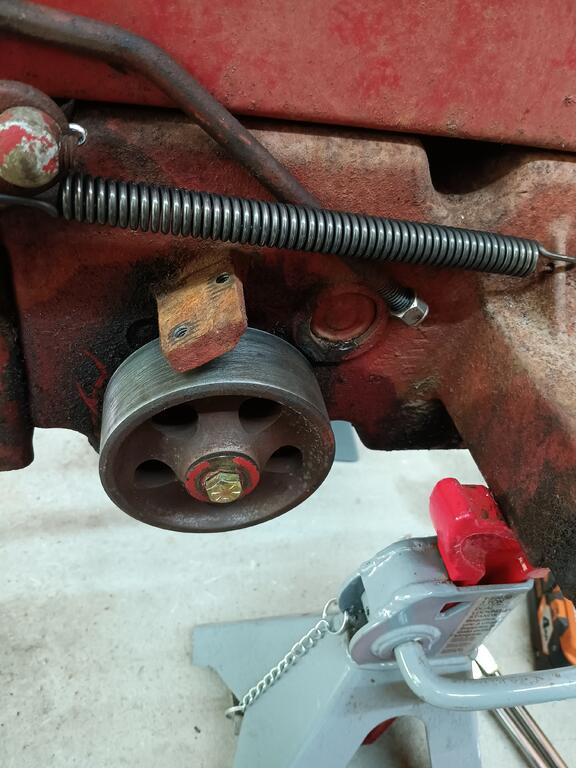

Sunny Burger 16 #1 Posted August 14, 2024 Hello, I broke my clutch spring on my 312-8. It is a spring-only system. Can someone tell me the location of the attachment point of the non-pedal end? Thanks. Share this post Link to post Share on other sites
ebinmaine 80,449 #2 Posted August 14, 2024 That's a Toro 108035 spring. It attaches to the web of the tranmission at the axle flange. Share this post Link to post Share on other sites

Ed Kennell 47,097 #5 Posted August 14, 2024 I use my brake spring tool all the time to safely install and remove my Wheel Horse springs. https://www.northerntool.com/products/performance-tool-brake-spring-pliers-model-w175-9094100?cm_mmc=Bing-pla&utm_source=Bing_PLA&utm_medium=Automotive > Automotive Repair Tools > Brake Repair&utm_campaign=Performance Tool&utm_content=9094100&cmpid=53403372&agid=3200075881&tgtid=pla-4577473070981041&prdid=9094100&ogmap=SHP|PLA|BING|STND|c|SITEWIDE||Auto Repair - SC|Auto Repair - SC||53403372|3200075881&gclid=58b6137fbe771cabef8f75c321e336a0&gclsrc=3p.ds&msclkid=58b6137fbe771cabef8f75c321e336a0 2 Share this post Link to post Share on other sites
ebinmaine 80,449 #6 Posted August 14, 2024 1 minute ago, Ed Kennell said: brake spring tool all the time to safely install and remove my Wheel Horse springs. Excellent idea. I do the same. In fact I probably learned that from this site. 1 Share this post Link to post Share on other sites
