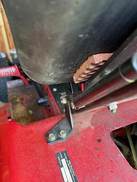

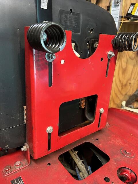

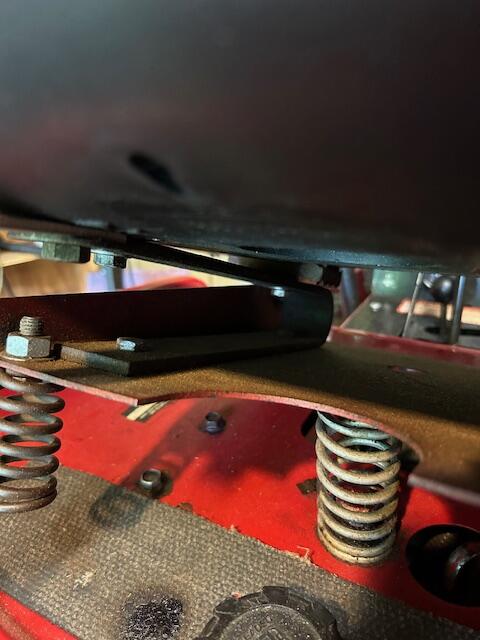

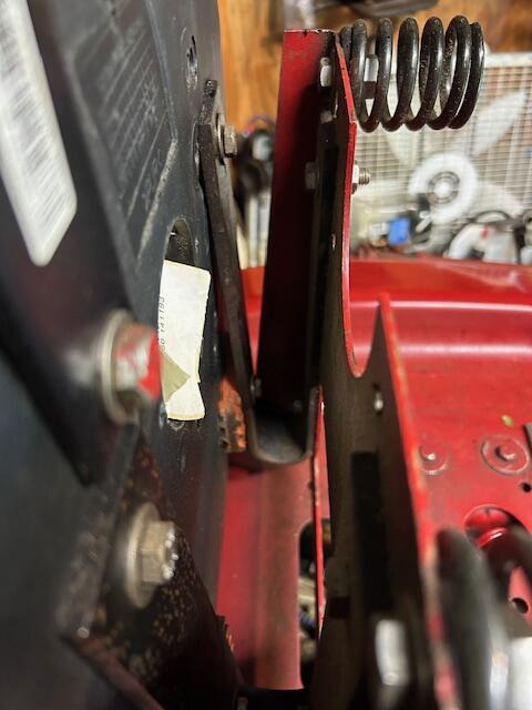

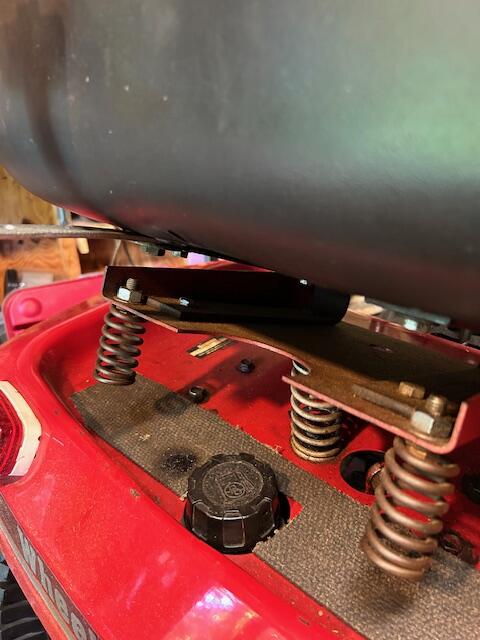

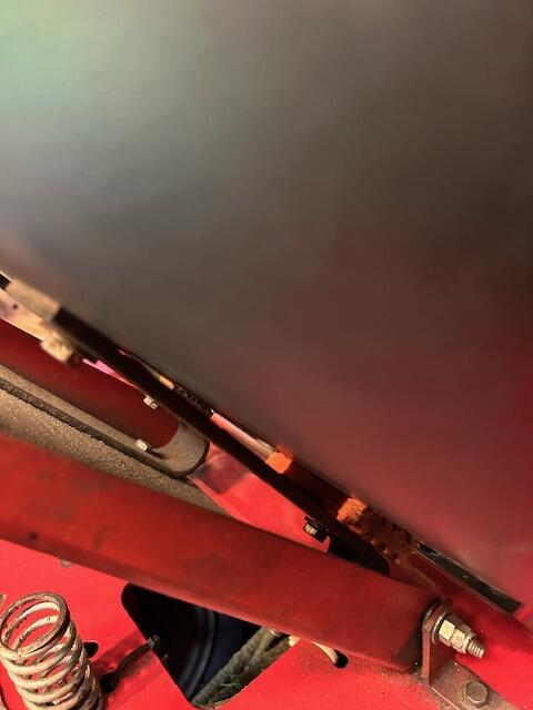

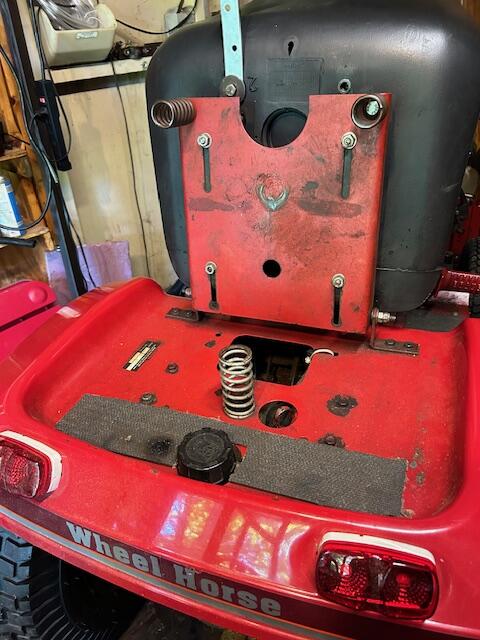

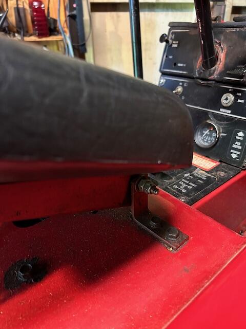

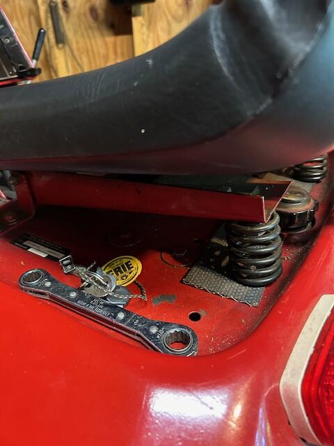

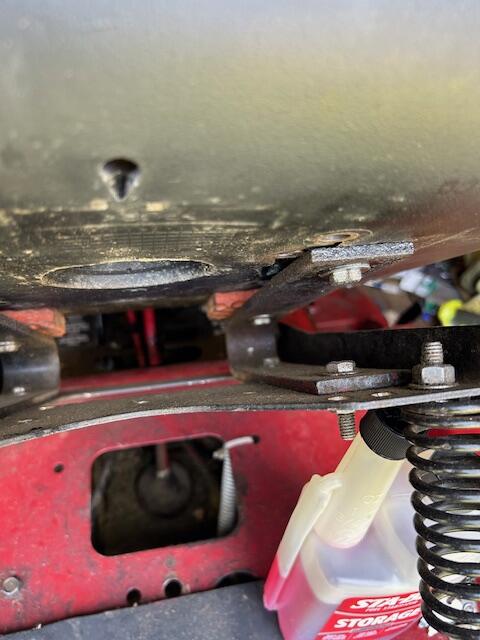

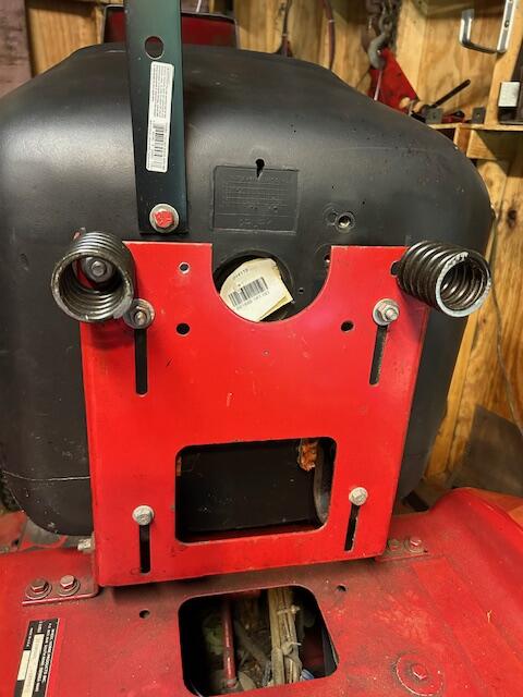

have also dealt with the  wheel horse seat issues , basically  took every stage apart , and improved on its  cramped set up , often refer to look at how anything is saposed to function , constantly looked back at  the change detailing made , last image note heavy isolation pad on top of spring , to seat bottom . stabilized seat base , the raised height also , gets seat out of fender base area. like the bolt on coil springs , was looking for firm solid seating , like hi seat , for back support . kept looking at side view , for leg room , just slight gains brought it all  together .have this set up on 3 horses        also used  W/H  seat base and , flat under seat spring . pete952757564_IMG_07921.jpg.433ad0366c29438384f37080c17d82d2.jpg336248775_IMG_07911.jpg.4c99adafd6be67bcb0de84014f1839ff.jpg952757564_IMG_07921.jpg.433ad0366c29438384f37080c17d82d2.jpg1651697104_IMG_07931.jpg.a4c5a9f25da64658214fa2cba50c8b90.jpg309841613_IMG_07941.jpg.fcf068a04ff892a2b45d2aad9ea39b7f.jpg2099481529_IMG_07951.jpg.eed38203aca2652e5242ff0ed65e9d39.jpg848404475_IMG_07961.jpg.0e3d43b7c9c4d891c7e80296274a1fd6.jpg1656605707_IMG_07971.jpg.15edde1f9208dc01fd2c7fc8827e2a37.jpg1574303031_IMG_07981.jpg.bd0061b9afe0362d3c168f9994b02fe2.jpg678080803_IMG_07991.jpg.7d079ff33fff05c13ce11808f3934196.jpg1512974244_IMG_08011.jpg.2d48e8dc4c94d3d499e67cb20a1279ca.jpg
