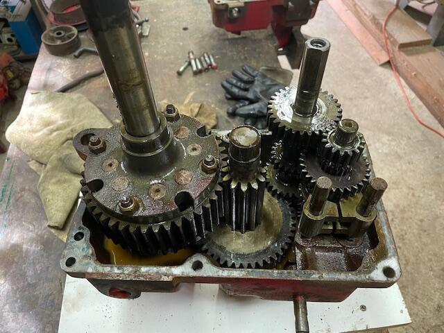

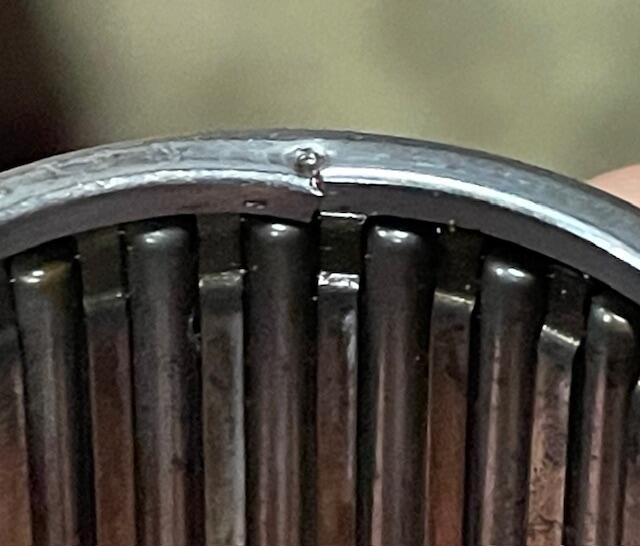

smitty316 24 #86 Posted September 3, 2024 This is a good stopping point for today. The water that sat in it definitely took its tole, but I think it'll clean up okay. I can see that the bearing where the axle seal was leaking is definitely bad as you said it would be. I'll wash out the other bearing the best I can and see how they look/feel. I have a small lathe so my plan is to turn an arbor to drive this bearing out unless anyone has a better way of doing it. Thanks, Smitty 1 Share this post Link to post Share on other sites

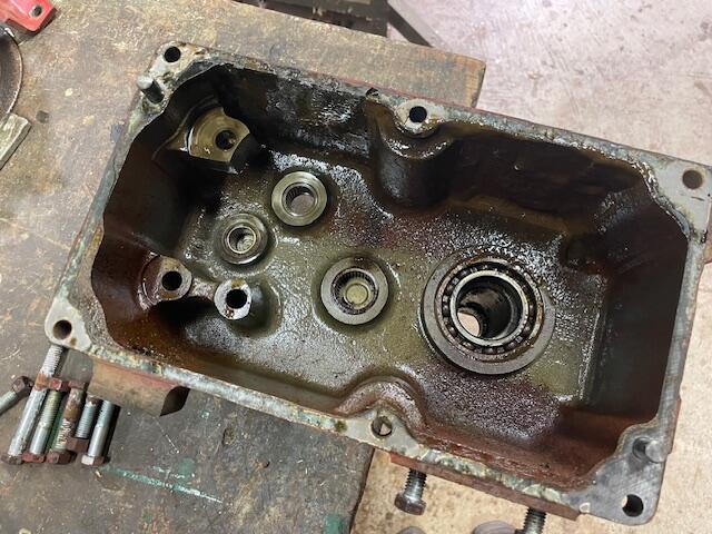

smitty316 24 #87 Posted September 11, 2024 I have it apart and cleaned up. It's not perfect, but I think I'll just have to replace the axle needle bearings. I don't have an arbor press. Are there any good videos on pulling and reinstalling these needle bearings? Also, I'm putting together a parts list. I think you said to let you know when I'm ready to order parts. Do you have a good source? Thanks, Smitty 1 Share this post Link to post Share on other sites

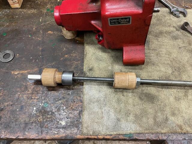

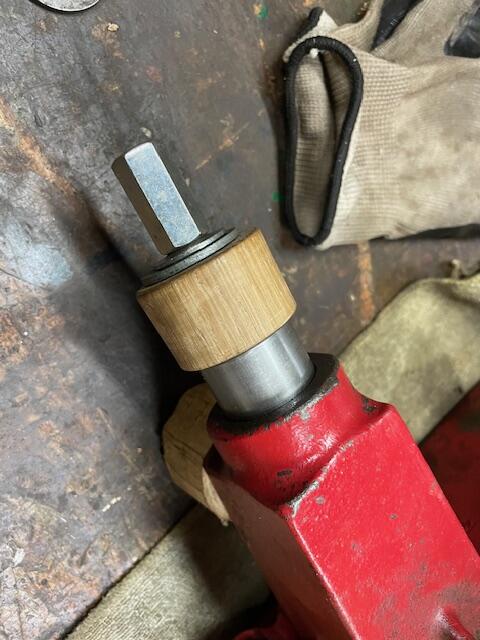

smitty316 24 #91 Posted September 13, 2024 I'm waiting on my bearings and seals so I had time to make these oak pieces to press in my bearings. I experimented a little with an old bearing and it seems like it'll work. I'll try the freezer trick too. The first picture shows what I did early on when I removed the first axle seal. Pretty dumb, but I'll just add it to the wake of screwups I've left in my past. Originally I was hoping to fix the leak by just replacing the seal, but that was a waste of effort and the cost of a seal. I'm really glad that I went ahead and tore it down so I could give it a much needed cleaning and take a closer look. Thanks again, Smitty 1 Share this post Link to post Share on other sites

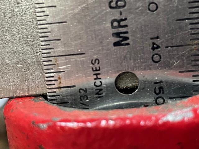

smitty316 24 #92 Posted September 13, 2024 Also, I took a measurement of the depth of the bearing before I pulled it out. It's about 3/16" below the surface. Is this a good depth for receiving the seal? Thanks, Smitty 1 Share this post Link to post Share on other sites

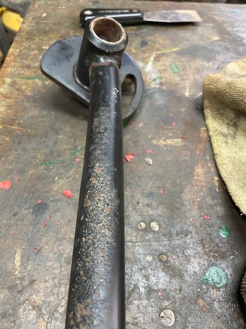

smitty316 24 #96 Posted September 24, 2024 Hi, I'm guessing that this lift arm shouldn't be bent like this? Just double checking before I make an effort to straighten it out. Thanks, Smitty 1 Share this post Link to post Share on other sites
953 nut 56,689 #97 Posted September 25, 2024 17 hours ago, smitty316 said: I'm guessing that this lift arm shouldn't be bent like this? Just double checking before I make an effort to straighten it out If it works alright I wouldn't mess with it. Share this post Link to post Share on other sites
smitty316 24 #98 Posted September 25, 2024 It had bound up the rod inside so I straightened it enough for the rod to move. It's hard to imagine how it got bent that way. It wasn't easy to straighten out. Share this post Link to post Share on other sites
Handy Don 13,040 #99 Posted September 25, 2024 1 hour ago, smitty316 said: It had bound up the rod inside so I straightened it enough for the rod to move. It's hard to imagine how it got bent that way. It wasn't easy to straighten out. Yep, was originally straight but with an offset angle to keep the arm away from the hood. Good job getting enough leverage on it to get it partway back. My guess would be the lever got caught on something while the tractor was moving--lotta kinetic energy in a moving WH! 1 Share this post Link to post Share on other sites
Bill D 2,050 #100 Posted September 25, 2024 1 hour ago, smitty316 said: It had bound up the rod inside so I straightened it enough for the rod to move. It's hard to imagine how it got bent that way. It wasn't easy to straighten out. Judging by the angle of that bend it's likely that the previous owner was lifting a heavy attachment without any kind of spring assist. I've actually seen this before on a tractor used for plowing. 1 Share this post Link to post Share on other sites
