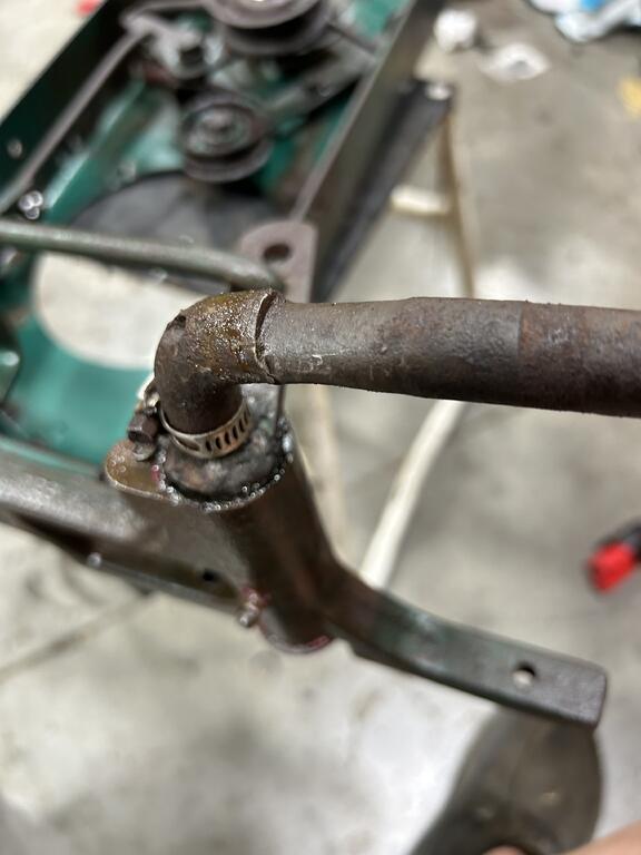

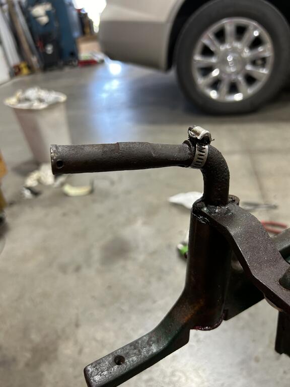

thats the worst of the two it is supposed to be 1/2 and I will get the wheel bearings then have them welded
Edited by Keaton
Handy Don
2 minutes ago, Keaton said:
Oh yeah. Time to offer the welder some reciprocal favors for fixing you up.
And get new bearings for the wheels!
What was the clamp for?

it was because there  was not a washer welded back there for a wheel stop, its that clamp then a washer for like a backing, I was cleaning the bearing off to find a part number, it said freeway Cleveland Ohio, I looked it up and their still in business I need to double check but I thnk their 1/2 spindalls, I can get them out easey, I'm goign to get bearings first to reference how much for the guy to grind

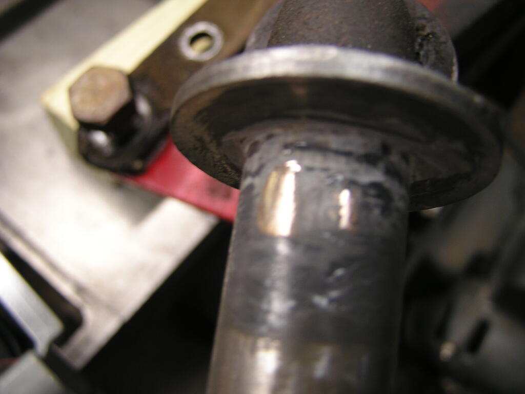

My son is the TIG welder in the family.... You get a faster build up of material with a wire feed welder, but..... easy to get too much.
The idea is to "Capture" the inner ball bearing race on the spindle to immobilize it. The OE was allowed to spin, possible seize and the damage done.
Tig with a copper-tungsten filler rod builds nicely, and allows for hand filing - like this one... nowhere as worn as yours...
