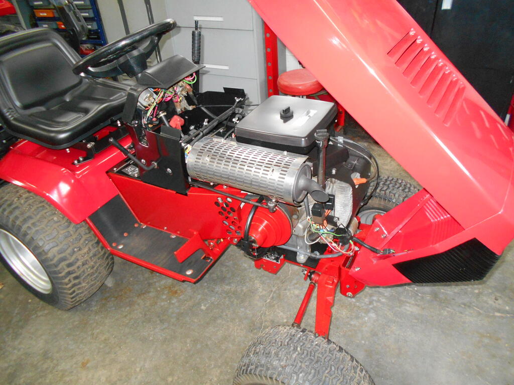

cleat 7,030 #5 Posted July 29, 2024 To properly clean the rear end it is best to remove the console covers, seat and rear fender then you will be able to get to most areas. Carefully inspect under the engine tins for grass buildup or rodent nests as the engine cooling depends on good air flow. You can see most of the way in by looking from the PTO side and shining a flashlight in between the tinwork and the engine block front and back. As you can see, removing some covers makes the cleanup job much better. 5 1 Share this post Link to post Share on other sites
