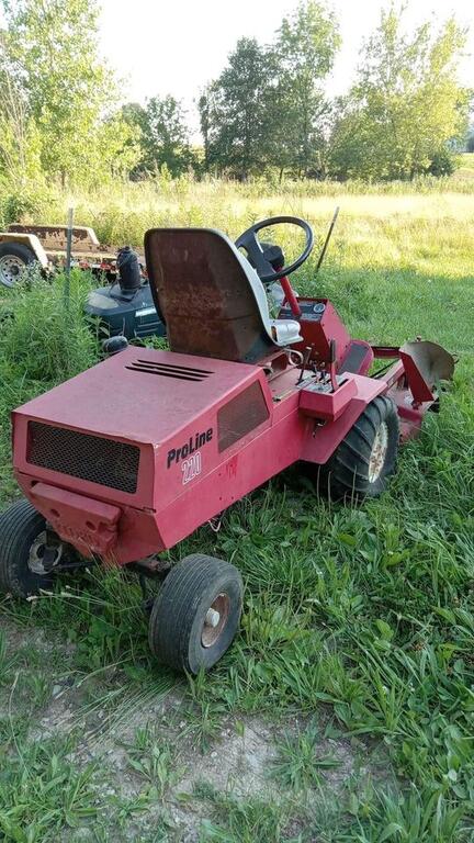

I might go look at this Toro 220 Proline mower.  It has the 20 hp Onan engine, 52 inch deck.  I'm a bit intrigued with these front mount mowers like this Toro.  I believe this one was made around 1993 or 1994.  Anyone here ever run across one of these Proline mowers or Groundmasters from Toro?

We had them at Disney for a while. Good little mowers if kept up. I can’t remember but I think it has the sundstrand pump/drive axle. Has the better pto box on the deck. Been a while since I had worked on them.
19richie66
Check the play in the pto engagement set up. I know on the larger groundsmasters they had a swinging set up and sometimes the shaft walks forward and throws the pto belt alignment off. Make sure the pto belt is still together and not split into two separate belts. If I remember correctly, it should be a thick 2v single belt.

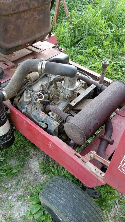

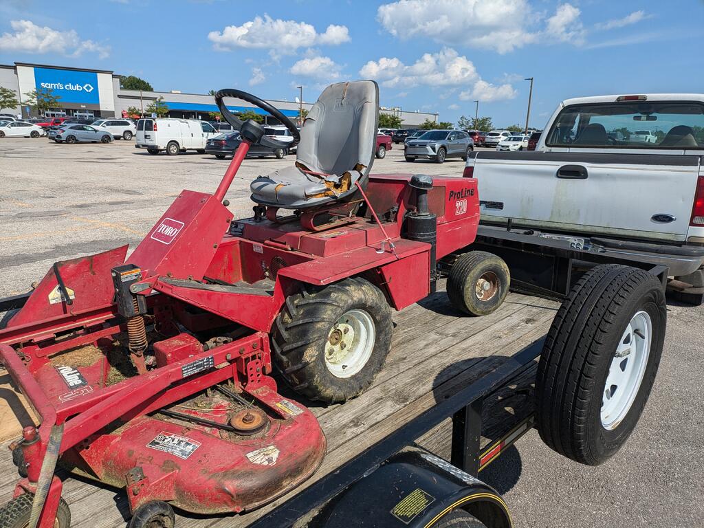

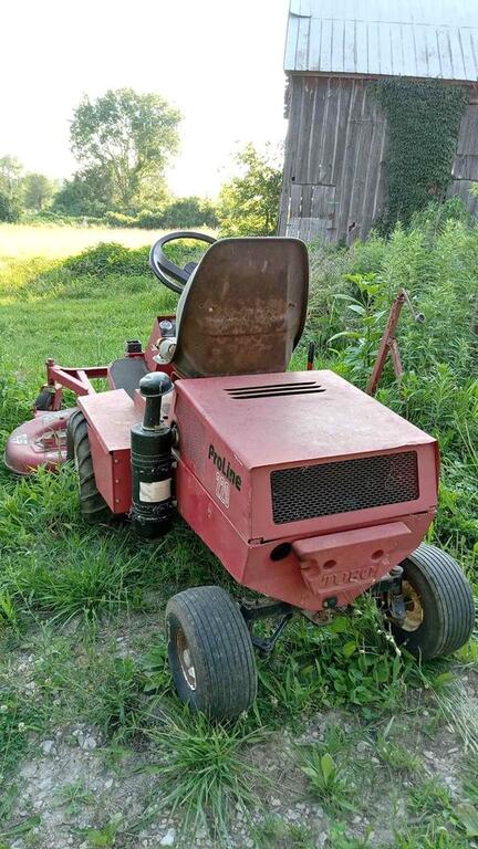

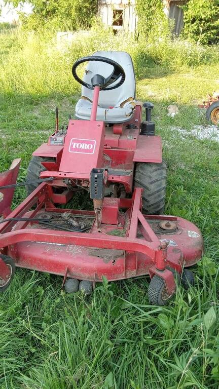

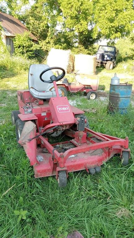

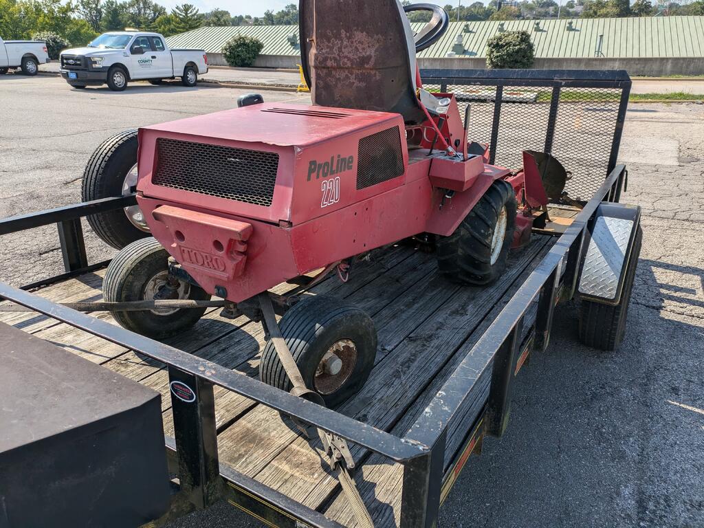

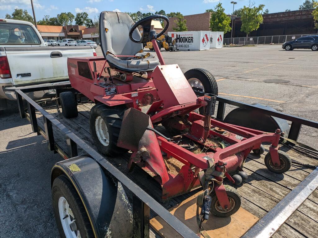

Bought it.  Runs pretty good, steering tires aren't the greatest.  Uses little oil and smokes a bit when cold.  But, this thing is neat to drive and a beast to mow with.  52 inch deck, 20 hp Onan engine, hydraulic lift on the deck, etc.

Oh, and the seat is in the running for ugliest seat contest.  It may not win, but may get honorable mention.

Here is a little tip for you. Put narrower tires on the rear. It will steer 100% better. The steering is sort of a mickey mouse setup, the long rod is fairly easy to bend. As was mentioned watch the pto belt alignment. I have a Groundsmaster 327 with the Conti/renault engine. Mine has a 72" deck. Very easy to hang it up. If you go through a relatively deep ditch with it? The deck will hit the other side and high center the machine lifting the drive wheels off the ground and you are hung. I don't know about yours. But, mine is very heavy and hard to push. It takes a relatively equal in weight machine to pull it out when it gets hung or stuck. I usually use my D-250. If it all works right? You will like how it mows. I have a big zero turn and 60" and 48" decks on my 520 and C-160 respectively. But, in all fairness? I really like the way the Groundsmaster mows the best. Another thing? Check the roller under the hydro pedal. The rubber wears and then it will be hard to keep the pedal consistent. It will rock forward or reverse when you don't want it to. If your safety switch is connected? You may have to rock the pedal back or forward to get the starter engage. Good Luck...
