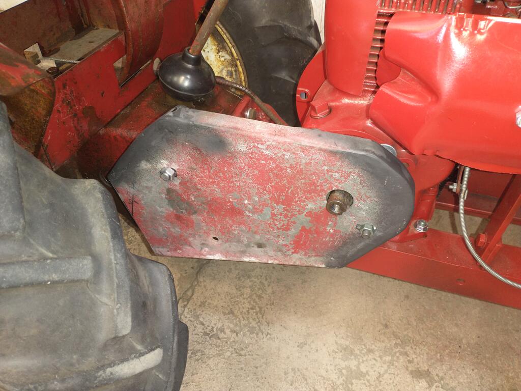

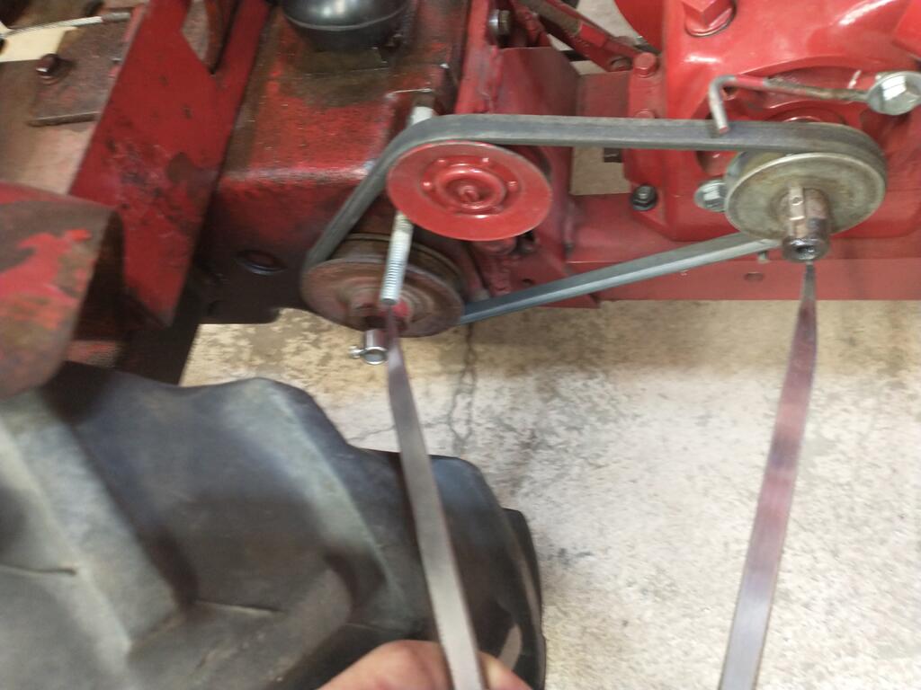

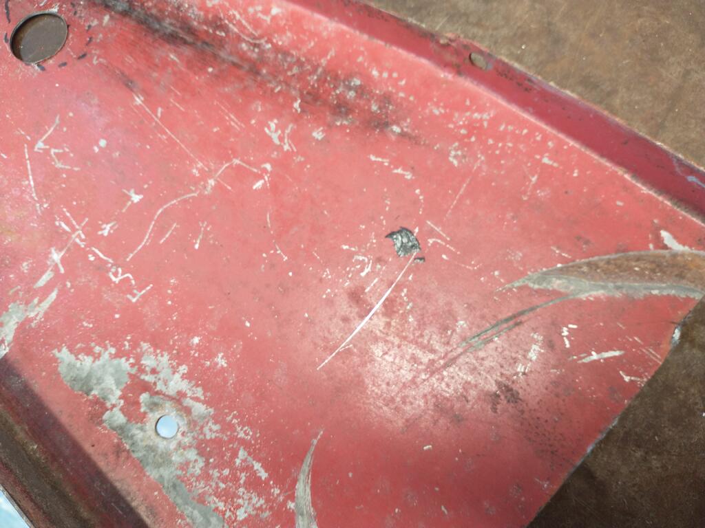

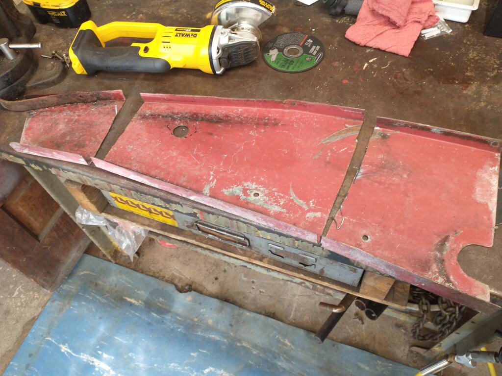

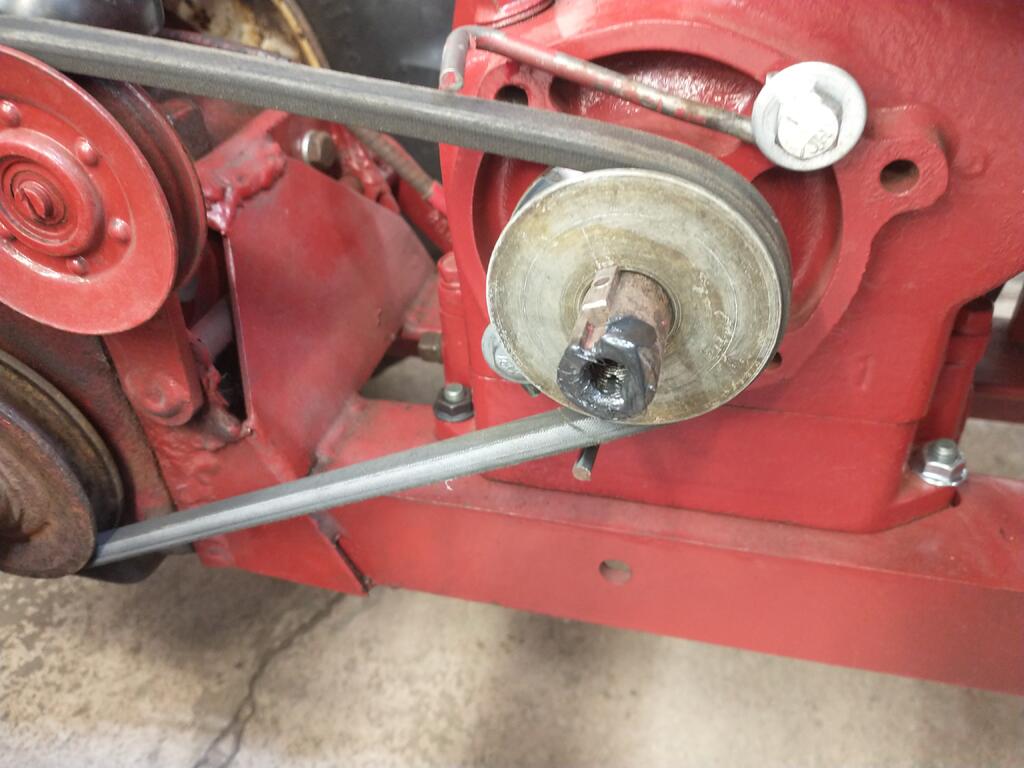

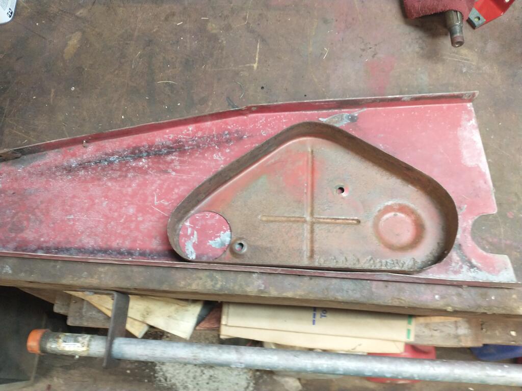

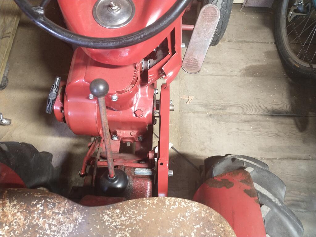

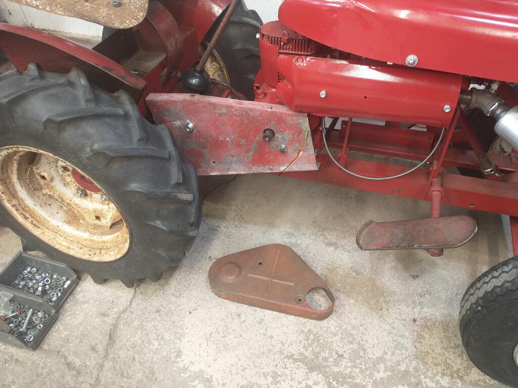

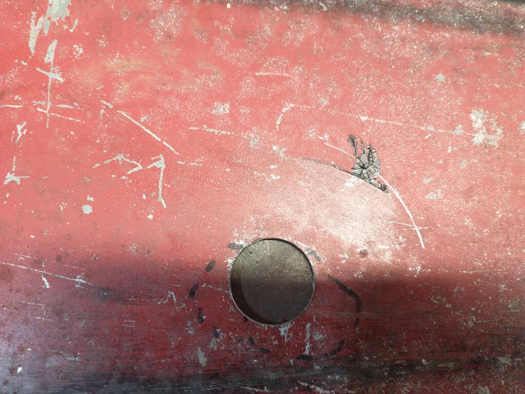

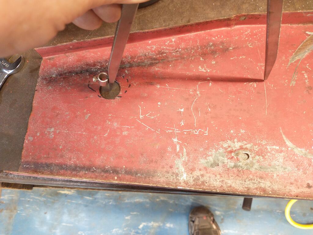

squonk 41,940 #1 Posted July 21, 2024 (edited) I bought a 551 Suburban with no engine. It came with a belt guard. 551's came with a Tecky which is a big nay- nay here at The Wheel Horse Plaza / Fake Chicken and Tweety Bird Ranch. Got a K90 from @formariz but it's different enough that the belt guard wouldn't work. Maybe if I slotted the frame and moved the engine back farther. But I hated the belt slap noise the RJ's and Suburbans have when releasing the clutch. Plus @wallfish did such a yeoman's job in the blistering heat crafting some wire guides I wanted to keep them. So it was time to make a belt guard. I found a belt guard in my basement years ago. I have no idea where it came from or for what it was. It looked pretty crappy. Somebody in NC needed a guard so I gave it to Richard @953 nut to bring to NC from the show. Well that meet up never happened. Richard gave me the guard back this year. I thought great, More scrap! I got thinking of making a guard. This crappy looking guard metal was pretty stout and I'm no metal smith. So let's have at it. Using the belt guard I got with the tractor I sized how much I needed to cut out. Made lots of noise and cut the guard with my 4" grinder with a cutting blade. I put a dab of grease on the crankshaft to locate the approximate location of the hole needed. Using my very large Horror Fright compass I located the distance from the center of the crank to the rear mounting stud for the guard and drew an arc on the guard. A dab of grease on the stud and the rear stud location is approximated. I used the same procedure to locate the front mounting hole. Test fit the guard. It fit but it looked like it needed something. After consulting with Bear's @ebinmaine and backyard hammer mechanics we decided on rounding off the front. I also decided to round the rear some. Enclosing the edge would take some welding so I had to take it to my friend Bill the welder. He discovered this guard was galvanized. Never knew WH did this. He got it done the next day and I trial fitted the guard Prepped ,painted and installed. Edited July 21, 2024 by squonk 3 11 Share this post Link to post Share on other sites
