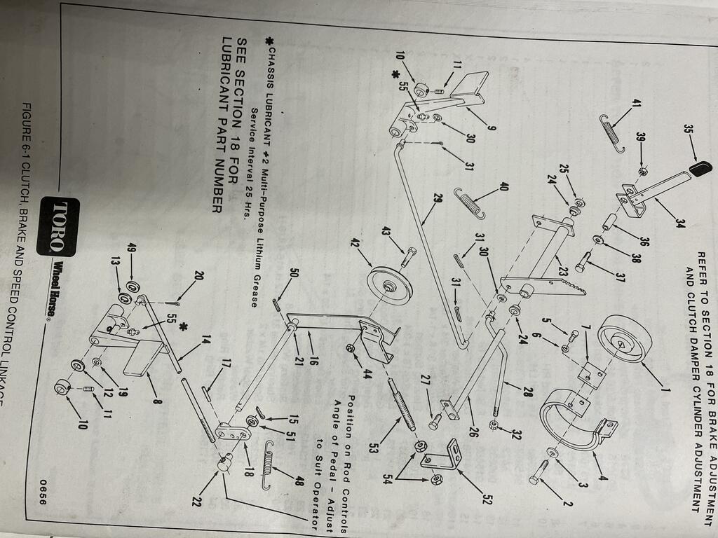

Can anyone tell me where this brake spring attaches to?mine must have broken and I can’t tell where it attaches to.listed on the drawing is part #40.

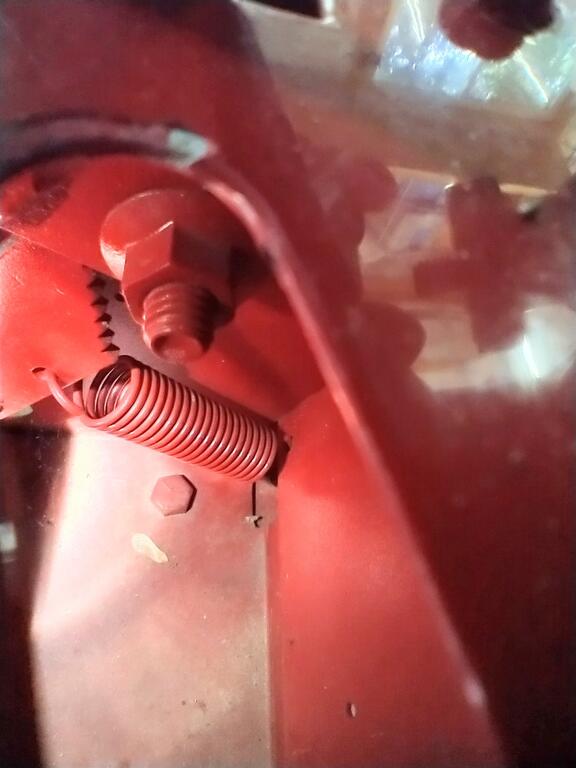

Spring attaches from the small hole in ratchet (23) to a small hole at the bottom of the dash tower.
This picture is from a B-100 8-speed, looking down through the shift pattern plate. You didn't specify what model you are working with, but this should give you some frame of reference.
