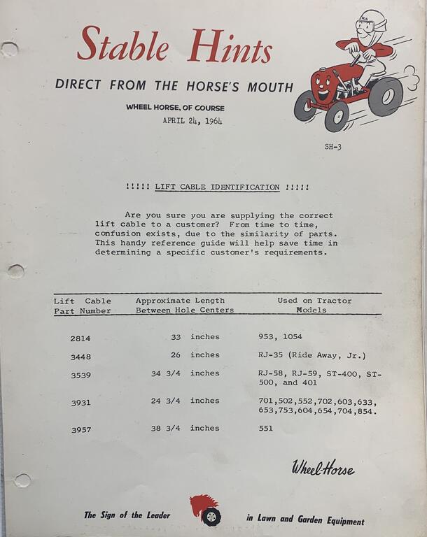

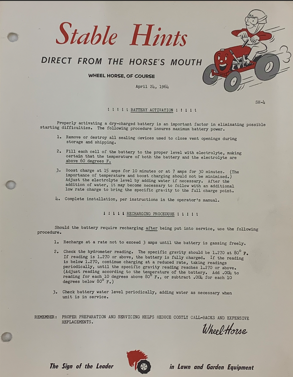

wh5208speed 645 #1 Posted July 18 Bought out a Wheel Horse dealer's inventory of manuals and parts back in 2003. Kept a lof of interesting stuff and thought I would share a 1964 version of "Stable Hints". I've got a binder of these unique items that cover intracompany correspondence, Interchangeability lists, Wheel Horse Factory Service School manuals for several years, etc. Just thought I would share one to see if the group would like to see an additional internal Wheel Horse documents. 2 11 Share this post Link to post Share on other sites
wh5208speed 645 #2 Posted July 20 Stable Hint's #2 - Lift Cables 1 2 Share this post Link to post Share on other sites
Retired Wrencher 5,477 #3 Posted July 21 Cool info there. Do you happen to have more info on cables for the mid 60`s? Share this post Link to post Share on other sites
