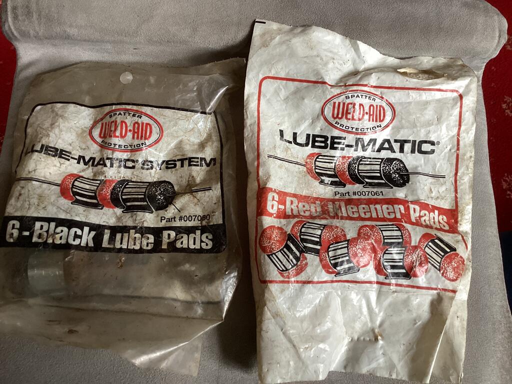

ranger 1,774 #1 Posted July 7, 2024 (edited) Found these in one of my shop drawers, (whilst looking for something else, of course). They clip onto the wire, in between the reel and the feed rolls. I used them on a welder that I had problems with wire feed. The red ones are for cleaning, the black ones for lube, (aluminum wire). They worked great! Brilliant for welders in an environment where moisture can cause issues with wire gaining a film of rust if not used too often. Also it seems, made in the USA! Edited July 8, 2024 by ranger 7 2 Share this post Link to post Share on other sites
Wayne0 927 #2 Posted July 8, 2024 I have one on mine. I think it came with it. Share this post Link to post Share on other sites
