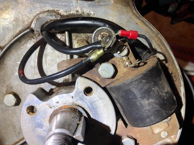

Sailman 1,299 #1 Posted July 6, 2024 (edited) I have this old 704 that I resurrected from the "dustbin of history"...so to speak. Got the engine freed up (had a stuck exhaust valve) and all the rest of the engine looked good (piston, cylinder walls). Its a K161 but pistons were smaller so I guess its actually a K141. It is a recoil start so I think that makes it a magneto ignition. Heres my issue; There is a switch at the console. When I first got the engine back together with the switch in the on position I could get spark at the plug. With switch off - no spark. I could get it to try to run with gas spray in the carb but would not keep running. I took the carb off for a deeper cleaning (3 more cycles in the ultrasonic cleaner). When I went back to the engine now I get no spark at the plug with switch on...??? Trying to diagnose what to do. I have the wire that goes from the switch and then behind the bearing plate. Another wire coming from the bearing plate to the points. I understand the condenser is behind the bearing plate too. The spark plug wire also comes from behind the bearing plate. I checked continuity from the switch to the points and have continuity with the switch in the on and off position. Is that right?? Can someone please explain to me how all this ignition works on a K-161 recoil start?? I am lost. Nothing in the service manuals helps me get this. Norman at "I save tractors" says to use condenser external (not replace old one under bearing plate). How would that actually hook up with the wire to the switch? Just for kicks I disconnected the wire from bearing plate to the points and hooked a new condenser to the points. Still no spark turning engine over...same thing with both wires attached to the points. Am I going to have to pull flywheel and bearing plate? Really need some advice here. Thanks!! Edited July 6, 2024 by Sailman Share this post Link to post Share on other sites

squonk 42,504 #8 Posted July 6, 2024 Follow that wire all the way under the flywheel and look for a chafed wire like Bob found on his. 2 Share this post Link to post Share on other sites

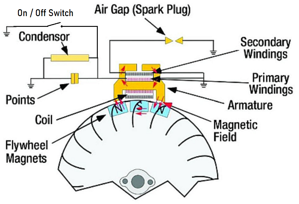

953 nut 57,839 #9 Posted July 6, 2024 The resistance of the secondary should be around 8k to 10k ohms. The resistance of the primary should be around 1.0 ohm. You need a good digital meter to tell the difference between a shorted primary and a good primary. If it really is shorted (unlikely) check the wiring harness where it enters the stator plate and under the clamp for a pinched or bare wire. Both the primary and secondary coils surround an iron core and are grounded through the core to the stator plate. While the points are closed the rotating flywheel magnets induce a voltage and current flow through the primary coil which is made up of a few hundred turns of heavy wire. This current flow creates a magnetic field. When the points open the current flow stops and the field collapses through the secondary coil which is made up of thousands of turns of fine wire. This collapsing magnetic field creates a very high voltage in the secondary due to transformer action and the high voltage arcs across the electrodes in the spark plug. The resistance of the primary is measured between ground (engine, or stator plate if the stator is dismounted) and the wire from the points and condenser. Resistance of the secondary is measured between ground and the spark plug connector at the end of the plug wire 1 Share this post Link to post Share on other sites

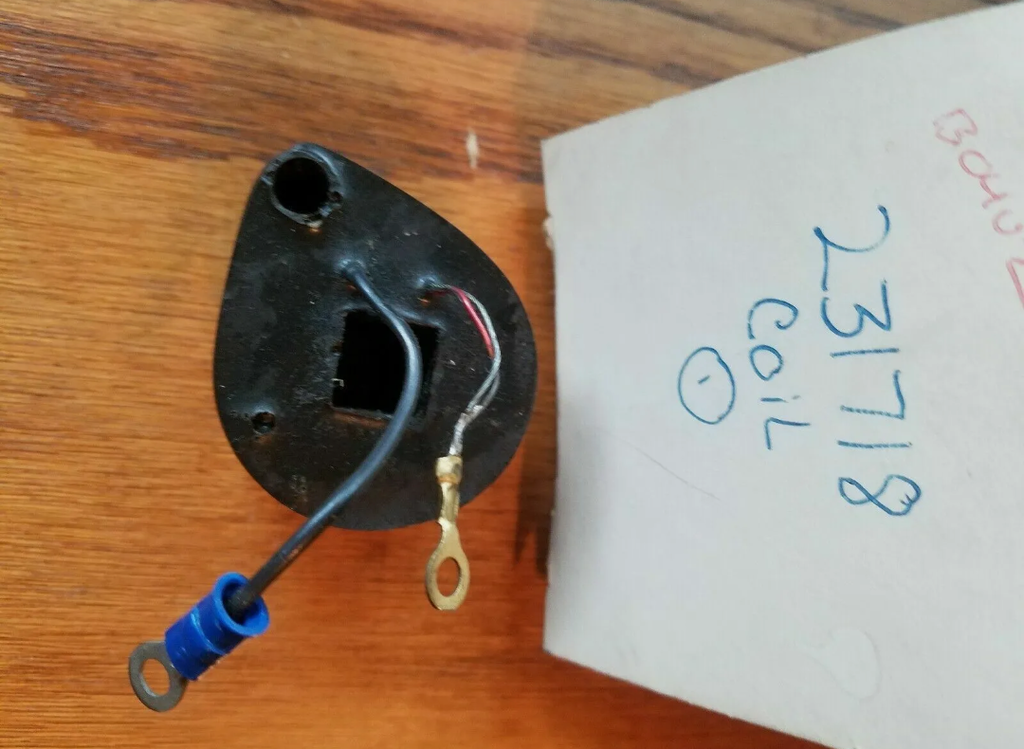

rmaynard 15,911 #12 Posted July 7, 2024 FYI, if the coil is bad, I have a good one. $75 plus shipping. 1 Share this post Link to post Share on other sites
Sailman 1,299 #13 Posted July 8, 2024 Here is an update. Problem NOT solved. Here's what I have done; 1. "removed all wires from the condenser, put tape on the ends, put the flywheel back on to see if I have spark". NO SPARK. I also took the red insulated wire from the coil OFF and just left wire to switch and wire to points attached to condenser and did a continuity test. NO continuity to ground. Checked chafe on all wires and all are good. This should mean NO SHORT in wires. Add the coil red wire and I get continuity with ground with points open and closed. 2. Used my multi meter to check resistance. Set at 20K I get 9.22 - 9.25 on secondary. Set at 200 I get .6 - .7 on the primary. This is outside my wheel house so....what does it mean so far? Whats next to try to solve this problem? Any way to test condenser? Thanks in advance. Share this post Link to post Share on other sites
