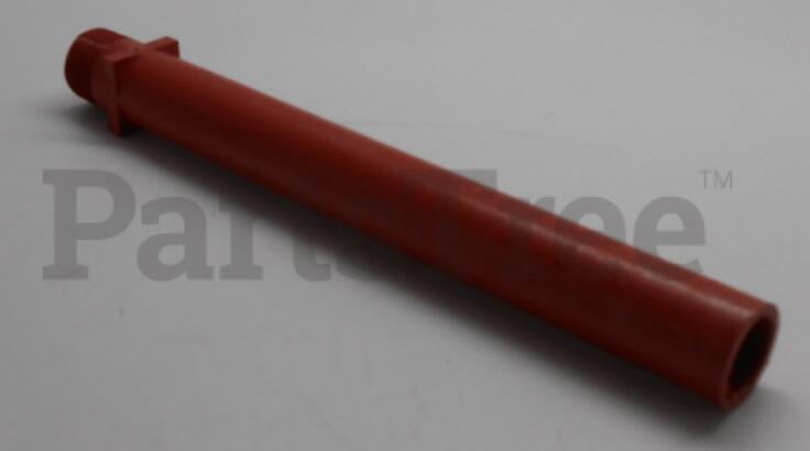

gwest_ca-(File Mod) 11,845 #2 Posted July 4, 2024 Looks like it is threaded and most likely made of plastic so be careful. That type of item usually has a National pipe thread and requires a thread sealer. Found picture but no longer available from Toro. 1 1 Share this post Link to post Share on other sites
JCM 10,411 #3 Posted July 4, 2024 Hi Dave. Make sure there are no cracks in the thread. Find a pipe dope that is compatible with use on plastic. IMO I would stay away from teflon tape. It would not be beneficial to the Eaton Hydro if some of it ended inside it. Did you possibly over fill the trans a bit ? 2 1 Share this post Link to post Share on other sites
953 nut 63,003 #4 Posted July 4, 2024 1 hour ago, JCM said: pipe dope that is compatible with use on plastic. As @JCM said, be sure the plastic pipe isn't cracked. I have used Rectorseal with good results on everything from steam lines to oil drain plugs for over fifty years. You can find it at ACE, Home Depot, Lowe's or and plumbing supply house. 2 1 Share this post Link to post Share on other sites
