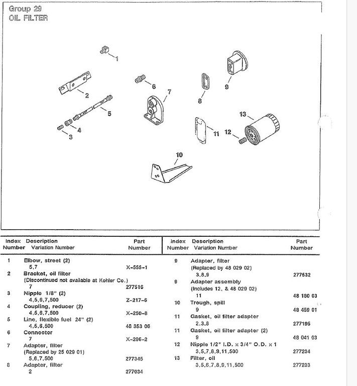

BuffaloD200 43 #1 Posted July 1 Hey all, I recently acquired a 1974 D180 with K482S engine. There's no oil filter? That doesn't seem right. Anybody have trouble running this engine without a filter? Share this post Link to post Share on other sites
pfrederi 17,784 #2 Posted July 1 (edited) The spec number should be 35222 if so no filter WH saved a couple bucks....Most spec# had filters.... Just noticed there was a spill trough available for engines with filters like the K532 WH used. Filter change on D200s is a messy job...would have been nice if WH had sprung for that option Edited July 1 by pfrederi 1 Share this post Link to post Share on other sites
BuffaloD200 43 #3 Posted July 2 There just appears to be a factory block off plate where I assume the filter would belong. Seems to be the same position on my D200 1 Share this post Link to post Share on other sites
pfrederi 17,784 #4 Posted July 3 Yours is variation 2 you get the blank plate #8 1 Share this post Link to post Share on other sites
oliver2-44 9,802 #5 Posted July 3 So you could add one if you got the parts off another engine 1 Share this post Link to post Share on other sites
BuffaloD200 43 #6 Posted July 12 Finding oil filter parts off another engine seems like an exercise in futility. But I may dig through some parts catalogs and see what I can do. Maybe tap some threads behind the block off plate. Thanks for the help guys! Share this post Link to post Share on other sites
