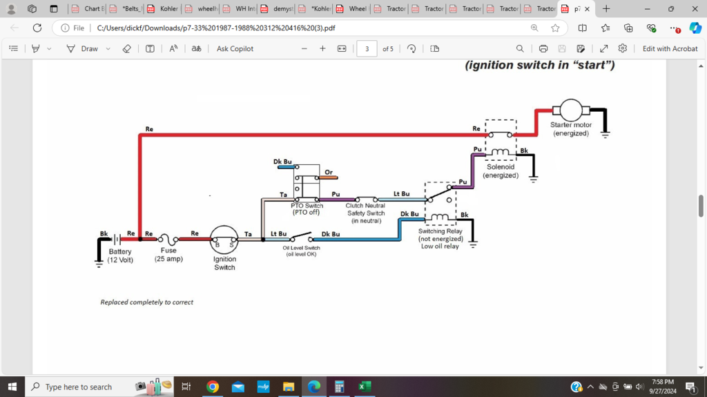

DeepH2O 66 #7 Posted September 27, 2024 On 6/30/2024 at 6:43 PM, midpack said: I have a Magnum 12 that had a faulty oil level switch. I bypassed the connection and just make sure I check the oil often What exactly did you do to bypass? My switch broke while trying to install (should’ve followed service manual to a T) and only one I found was $100. I would rather just install a NPT plug and bypass. What’s correct way to bypass? Just cut the plug? Thanks for help!! Share this post Link to post Share on other sites
953 nut 63,031 #8 Posted September 28, 2024 46 minutes ago, DeepH2O said: What’s correct way to bypass? Just cut the plug? YES The low Oil switch will close if the oil level is too low and be open (like the wires weren't connected) if the oil level is good. 1 1 Share this post Link to post Share on other sites
