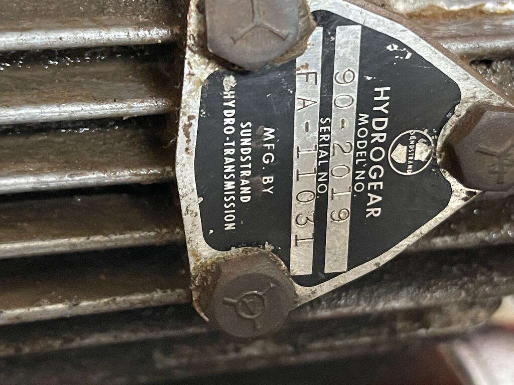

Wheelhorse#1 1,997 #1 Posted June 30, 2024 Hello all Im looking for information on a sunstrand 90-2019 I can’t seem to find any info on it here or elsewhere. This unit is on a 1974 12 auto no name and it seems this isn’t the original hydro it came with originally. Id like to possibly rebuild if possible. thanks for the help Share this post Link to post Share on other sites

gwest_ca-(File Mod) 12,505 #6 Posted July 1, 2024 Your model number is written 1-0465. The 8 is not used but if you subtract 5 from that 6th digit you get the model year. 8-5=3=1973 Two pages of search results with a 1-0465 search https://www.wheelhorseforum.com/search/?q=1-0465&quick=1&type=downloads_file Can find no record of Wheel Horse using the 90-2019 transmission. 1 Share this post Link to post Share on other sites

Wheelhorse#1 1,997 #9 Posted July 1, 2024 11 hours ago, gwest_ca said: Your model number is written 1-0465. The 8 is not used but if you subtract 5 from that 6th digit you get the model year. 8-5=3=1973 Two pages of search results with a 1-0465 search https://www.wheelhorseforum.com/search/?q=1-0465&quick=1&type=downloads_file Can find no record of Wheel Horse using the 90-2019 transmission. I can't find any info on this pump being used by WH either,I tried google search and no info at all on it...weird Its been replaced somewhere along in its life.Also someone removed the parking pawl a welch plug is in its place. Thx for the help Share this post Link to post Share on other sites

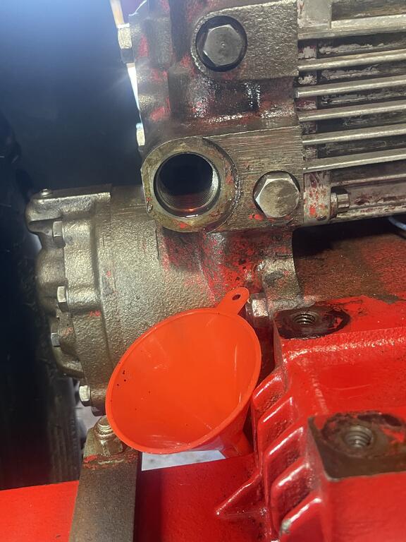

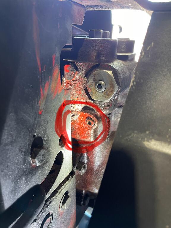

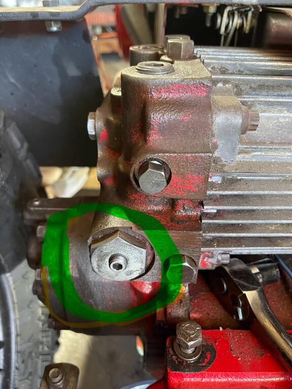

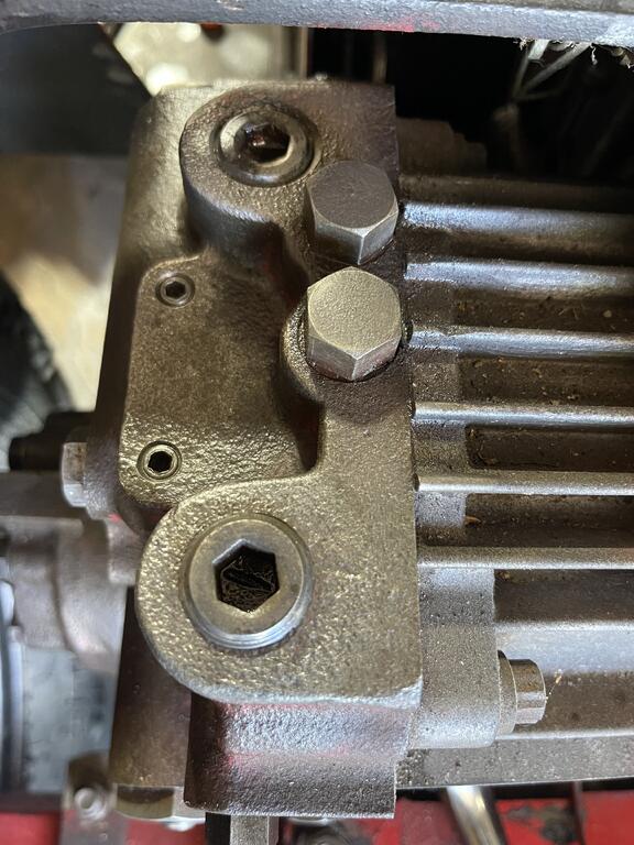

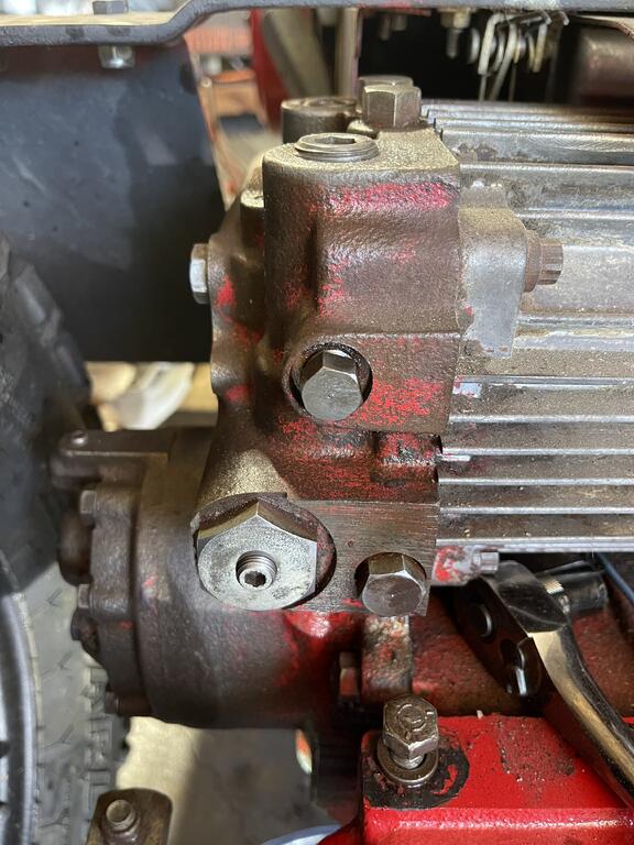

Wheelhorse#1 1,997 #12 Posted July 2, 2024 (edited) Wile out in the shop I took a couple pix of what I have. The pump looks similar to ones in the manual but not identical as far I could tell anyway. I’m not sure which valves are what ? For now I’m trying to identify the reverse valve. Reason is ,that it moves slow in reverse,one speed. Forward speed is fine except when under load say pushing heavy snow or dirt it sometimes surges forward. The circle on last pic is what I believe to be the reverse valve ? Would this be correct? Rear view Top view. Front Edited July 2, 2024 by Wheelhorse#1 Share this post Link to post Share on other sites

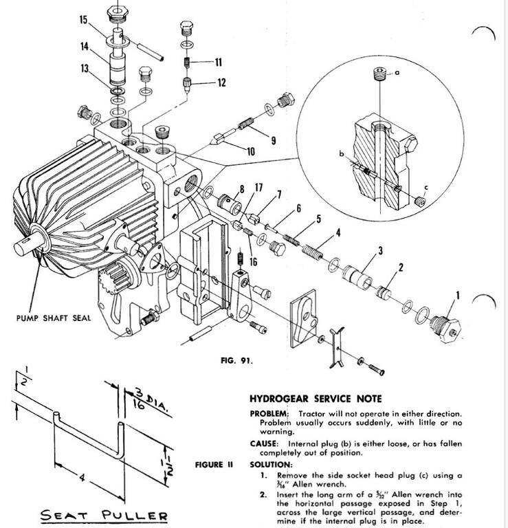

pfrederi 21,216 #13 Posted July 2, 2024 What you circled is the access to the internal plug that can sometimes fall out of position causing no movement... c in the circled diagram. Where is your tow valve they moved them around over the year between models Share this post Link to post Share on other sites
Wheelhorse#1 1,997 #14 Posted July 2, 2024 5 hours ago, pfrederi said: What you circled is the access to the internal plug that can sometimes fall out of position causing no movement... c in the circled diagram. Where is your tow valve they moved them around over the year between models Tow valve circled in green. There os a cut out for access right inside the storage box under the seat. Share this post Link to post Share on other sites

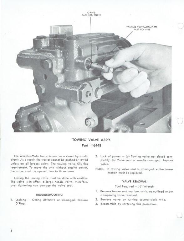

pfrederi 21,216 #15 Posted July 2, 2024 (edited) I am pretty sure that is an acceleration relief valve. not a tow valve. some early WH hydro gear had the relief valve on the back of the head you had to reach it in front of the tool box. Would be the bolt head above and right of your circle. There is a older manual for the early Wheelamatics I have . Will scan a few pages later as it is closer to the way yours is set up with tow valve. Have you used the tow valve??? Edited July 2, 2024 by pfrederi Share this post Link to post Share on other sites
Wheelhorse#1 1,997 #16 Posted July 2, 2024 1 hour ago, pfrederi said: Have you used the tow valve??? Yes sir I have used it.Turning the screw counter clockwise will loosen then I was able to move the tractor freely. It makes sense because there is an access cutout under the seat inside the front of the tool box for it Thanks again for the help ! 1 Share this post Link to post Share on other sites
pfrederi 21,216 #17 Posted July 3, 2024 (edited) Sorry took so long. Edited July 3, 2024 by pfrederi 2 Share this post Link to post Share on other sites

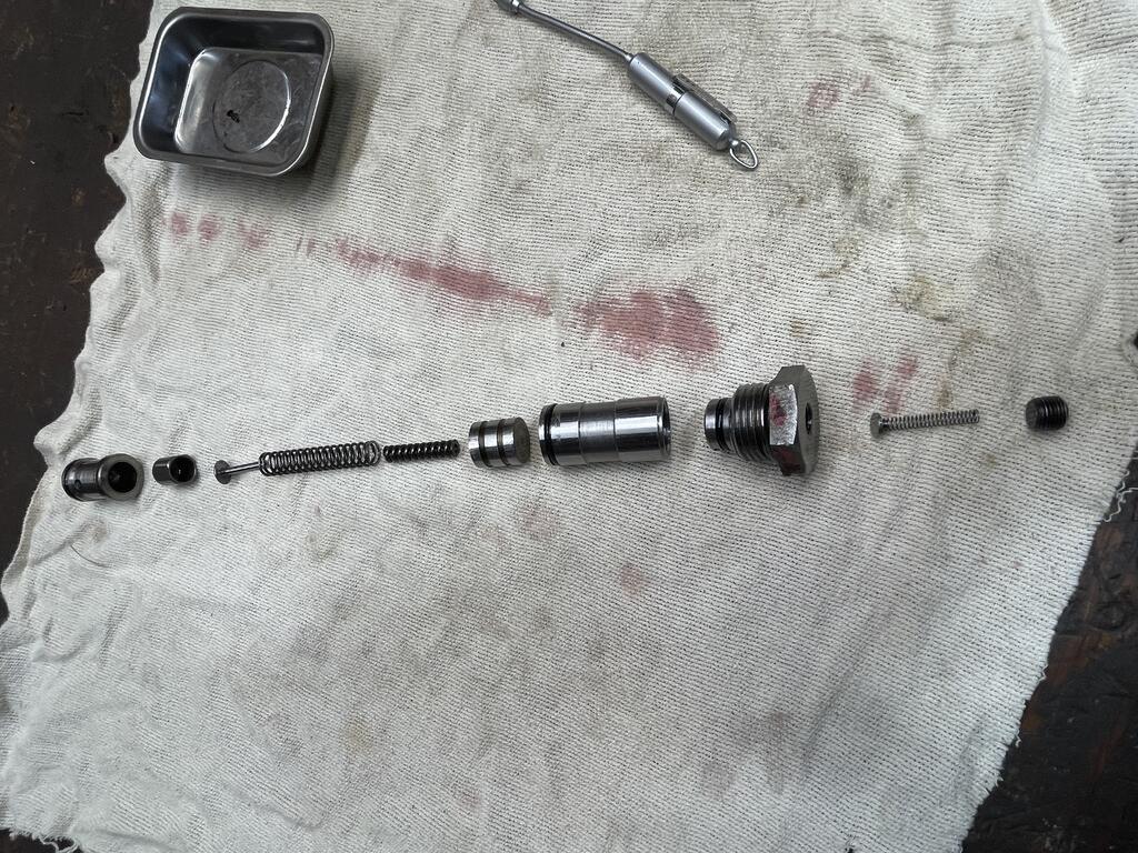

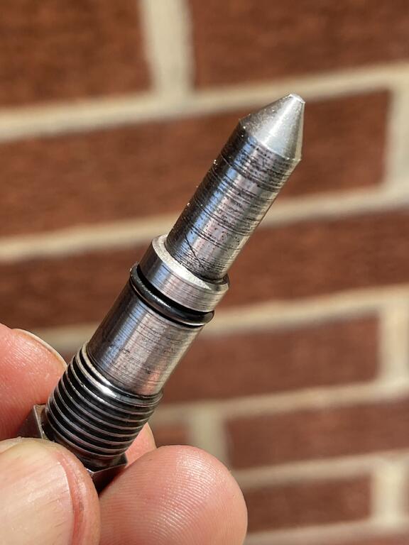

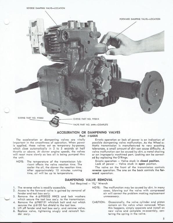

Wheelhorse#1 1,997 #21 Posted July 17, 2024 (edited) Finally managed to identify the forward dampening valve with the help of @pfrederi. Took apart and it looks to be in pretty good shape as far as I can tell. Ill go ahead and replace the O-rings . Looks like it takes two sizes large and small. Large 970093 small 970014. Edited July 17, 2024 by Wheelhorse#1 1 Share this post Link to post Share on other sites

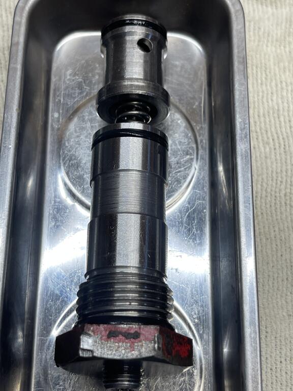

Wheelhorse#1 1,997 #22 Posted July 17, 2024 (edited) Tow valve.Ill remove the reverse valve next . O-ring part # 970010 Edited July 17, 2024 by Wheelhorse#1 1 Share this post Link to post Share on other sites
pfrederi 21,216 #23 Posted July 17, 2024 (edited) I have found that WH part numbers for O rings USUALLY contain the O ring dash number. The last 3 digits are the dash # this applies to the later Hydro gears..However the wheelamatic used different numbers on some things. Also the Wheelamatic doesn't show the part numbers for some internal things (you weren't supposed to mess with them like o rings for acceleration valve innards. So look at the hydro gear section of the Sunstrand manual...by then they decided you could work on it and the sort of standardized #s last 3 equal to Dash # The three you listed with old WH numbers are 970010 is a Dash 011 970014 is Dash 015 97053 is I think Dash 118. The dimension in the Wheelamatic manual don't make sense ID is larger than OD I have many of the o rings when you know what you want i can give you what ones I have... Edited July 17, 2024 by pfrederi 1 1 Share this post Link to post Share on other sites
