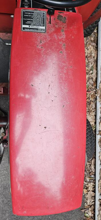

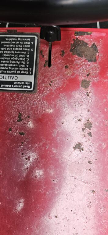

Happy Saturday morning....
I want to somehow stop the flaking and seal this.
Spray clear coat? Brush on Varnish? Brush on Lacquer? Spray Varnish / Lacquer ?
Penetrol? Double Boiled Linseed? Small can of IH Red paint and brush on?
Id mask off the "good paint" and try to fix rest / secure it from getting worse.
Ideas?
Thanks Tony
Edited by Docwheelhorse

I think it would be best to give it a light wet sand with like 1000 grit on the hood then clear coat it, or wire brush those metal spots to make them shine then clear, clear coating seems like the best option for ma at least, my lawn ranger and part of my rj have came out great so far, edit: I think you should clear the whole top side or whole inside and out of the hood, that would look nice

@Docwheelhorse  already past saving point , with rust established paint break away , penetrating oil , to any neglected paint finish is so simple / easy , just do it . cannot  even think about recovery , if any to finish , do it in phases , any starved / neglected finish , needs a lubrication creep / soak , to do its start . regularly refer to this stage as savina patina . oiled darkened finish just looks right to an old horse . personally never remove any paint , let the lubrication do its soaking / feeding work . done a lot of this , time soaking is your main helper , never remove any paint , clean cloth / fresh lube , is what does it , when its ready for a shine , it will show itself in color depth .then a 6 " electric palm buffer , with a cleaner wax , will pull out  vintage color , pete

Oils attract dirt. Use Penetrol

@Docwheelhorse Tony, there is nothing that can protect that hood.
Sand it down to bare metal, treat it with a rust protectant, then repaint it. Rust is like cancer. Putting a band aid on it only hides it.
