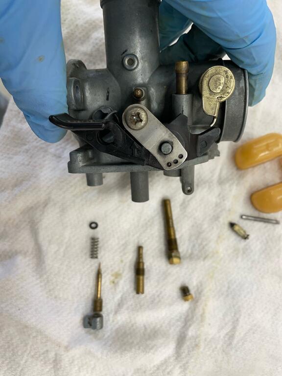

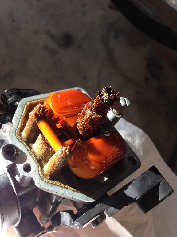

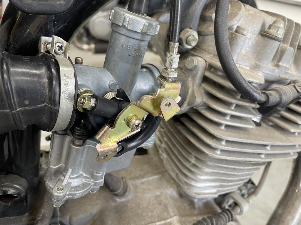

OoPEZoO 559 #5 Posted June 28, 2024 My go to for carb cleaning is an ultrasonic cleaner and some degreaser. Pull it all apart, toss the parts in the basket, let it heat up, then run it through a few cleaning cycles. The parts come out looking brand new. I usually follow up going through the carb with my cleaning brushes and orifice pins, then spray down with carb cleaner. Then reassemble with a good rebuild kit. It hasn't failed me yet. HF or Amazon has many size options. I think mine is maybe 2.5 Liter. Its pretty small, but is perfect sized for carbs. I do wish I had bought a bigger one though, because I have found it so useful for cleaning other stuff as well. Here is a little before and after from a pretty rare carb I have on one of my motorcycles. It was only put on 1 model for 1 year in the US in the mid 80's, so getting a replacement wasn't really an option. I had to order the rebuild kit from some sketchy place in Indonesia, and it took almost 2 months to show up. BUT, once rebuilt, I set everything on the carb per the factory manual, and it kicked over on the first try and idled beautifully. Point is.....if you can rebuild the factory carb, do it After seeing this, I thought for sure it was done for All pulled apart And back into service clean as a whistle 1 Share this post Link to post Share on other sites
