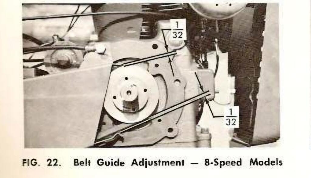

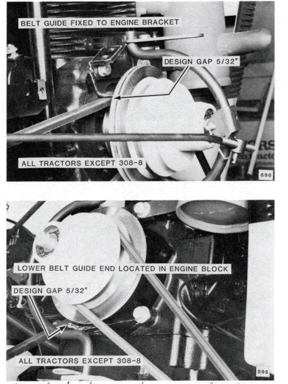

In the files section for each model machine are pictures in the manuals for the belt guides for each tractor type they can be quite useful when you have head scratching moments. There are belt guides on the 312 and the C100 has guides on the belt guard.
Edited by Goldnboy

Thanks for the great pics Goldnboy !
I do have some pics for both tractors in Manuals I downloaded over the years from this group, but none of those show this as clearly as the ones you have posted here, either on my monitor or if I print them out!
I will have to check the clearances on the guard on my C-100. I am pretty darned sure they are bent out much wider than what is spec'd out here.

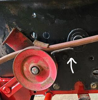

As for my 312, I immediately noticed from the second pic here, that mine is missing the top belt guide! I have the second guide on the bottom of the pulley, but I am also going to check the clearance on that one also, but I am pretty sure it is a much bigger spec than shown in this photo. That only leaves the black bracket located in front of the pivoting idler pulley. I am pretty sure that my bracket is not located in the same spot as the one shown in the pic I just found & marked with a white arrow.

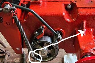

So if I understand correctly, that threaded shaft under the seat with the broken plunger shaft that is supposed to sit against the tensioner pulley bracket when it's in the rearward position, is pretty much an unnecessary part?
The spring you mention, is the pedal return spring under the footrest on the left side that goes from the linkage to the hole in the axle housing?
If that's the spring you mean, using the spring & relocating the belt guide bracket in the second pic to the position in the pic, should eliminate the vibrating/bouncing clutch pedal & belt slapping I am getting? (I Hope)
