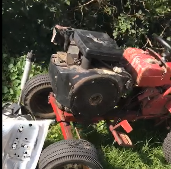

horseman with no horse 26 #1 Posted Thursday at 02:50 AM i picked up a p218 complete but partially disassembled its got the 1 7/16 inch crank. paid 160. ordered a gasket kit for it plus a spare. got a p220 complete and assembled its got the 1 7 /16 crank too, apparently it looses spark when its warmed up. and a b48m (not sure the crank size but it came out a case 446) with its whole ignition missing minus the points plunger and the spark plugs in the heads. its also missing part of the carb and the whole air cleaner. paid 250 for the pair. all in all i think im gonna want to fix mainly the p220 as it fits so good on ruby. im definitely gonna make the p218 nice too. i really like the b48m but i dont know where i can get an ignition kit and carb for reasonable price. also does anyone know where i can get a pulley for it? im gonna run it pullet swapped anyway but the smallest i could find that would fit was a 6.75 inch pulley on Mcmaster-carr 2 Share this post Link to post Share on other sites
horseman with no horse 26 #2 Posted Thursday at 02:51 AM the p220 on ruby the speed horse 1 Share this post Link to post Share on other sites

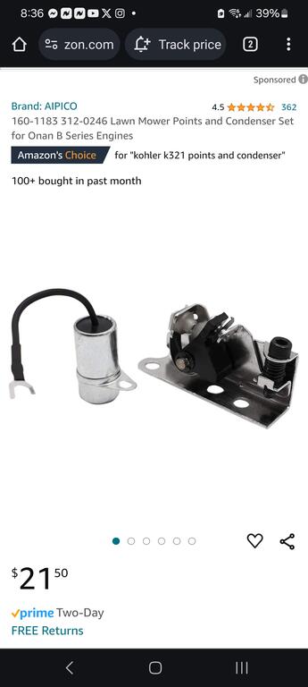

horseman with no horse 26 #6 Posted yesterday at 01:02 AM as for the b43m does anyone have any input on where i can get ignition/carb parts for a fair price? Share this post Link to post Share on other sites
RED-Z06 2,173 #7 Posted yesterday at 01:32 AM 29 minutes ago, horseman with no horse said: that seems a bit hopeful on an old Flathead? id be happy to see 90-100. im gonna do a leakdown test since that will be more definitive of the engines over all health. if that turns out good then its probably mechanically intact. B series was a bit lower, 95ish. But the P series, 115-130 is the healthy range. My p220 blew 125 on both sides with no liquid added the the cylinders. Share this post Link to post Share on other sites
RED-Z06 2,173 #8 Posted yesterday at 01:36 AM 32 minutes ago, horseman with no horse said: as for the b43m does anyone have any input on where i can get ignition/carb parts for a fair price? 166-0772 should be the points coil on Amazon, usually comes with condenser. Points also readily available 1 Share this post Link to post Share on other sites
