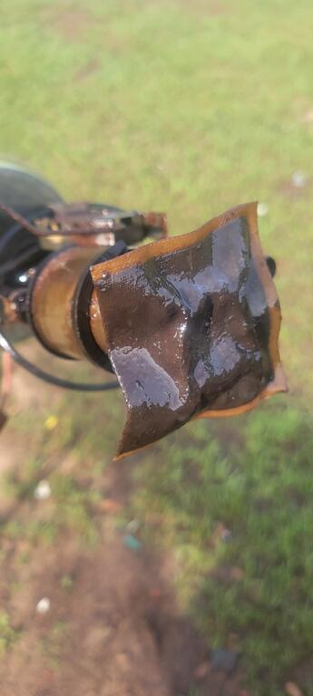

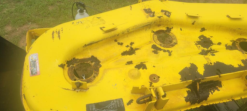

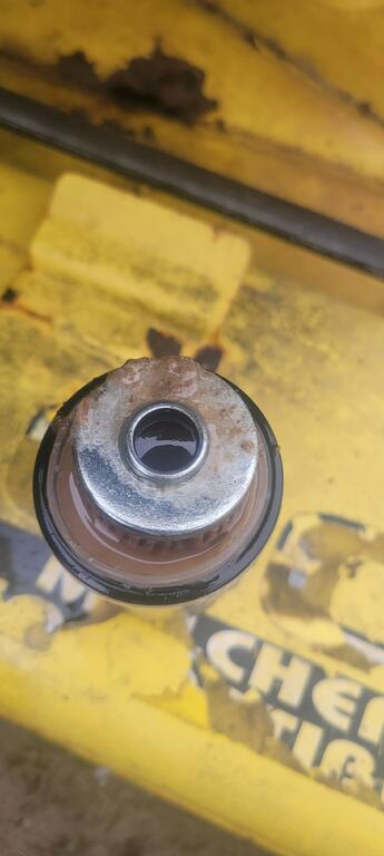

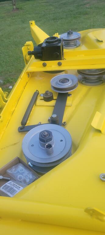

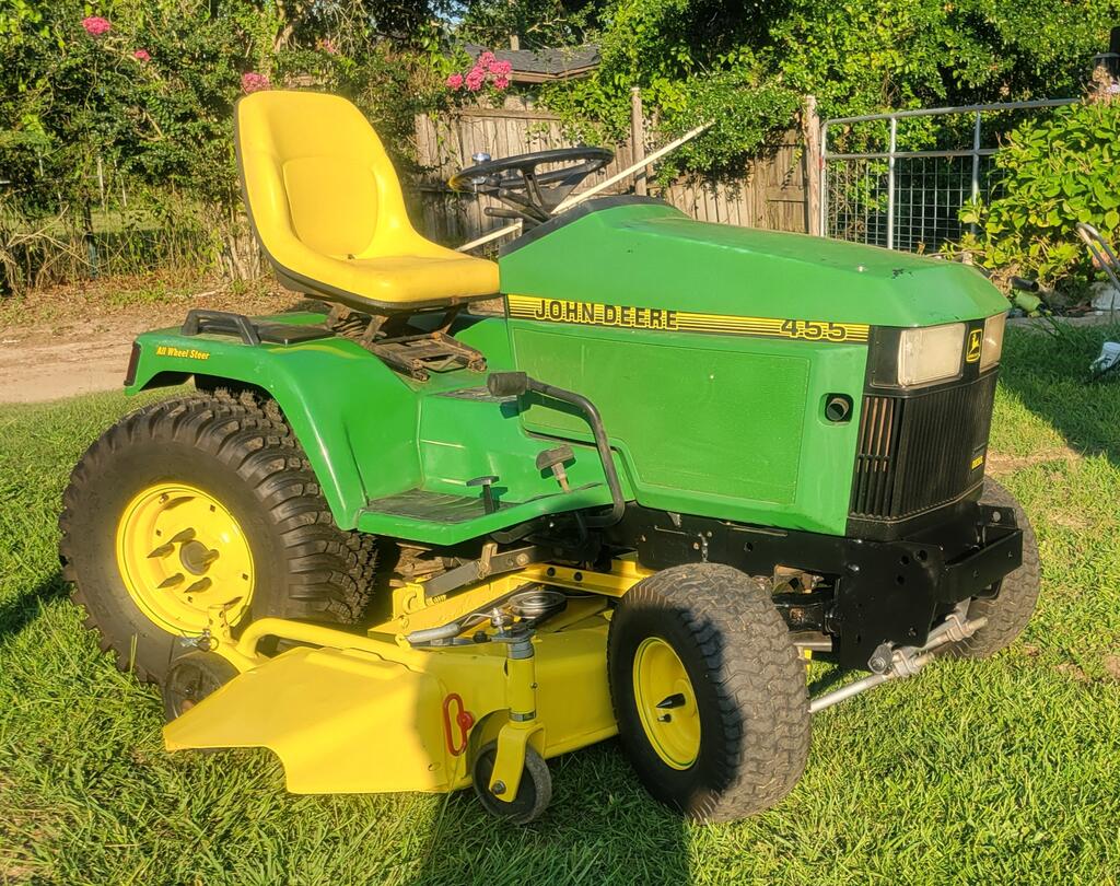

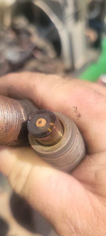

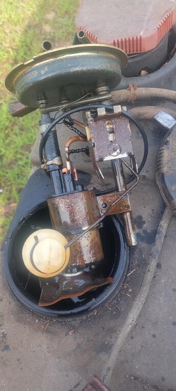

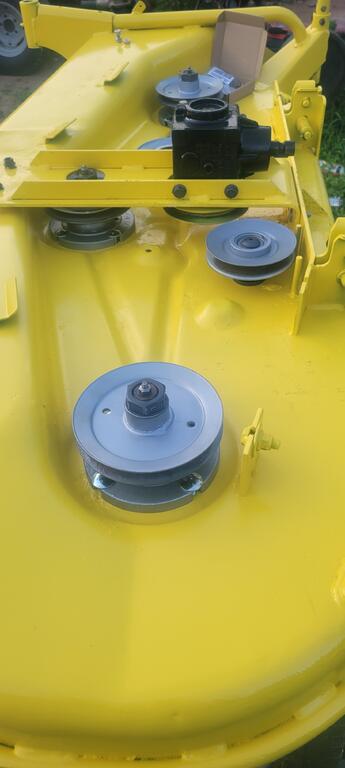

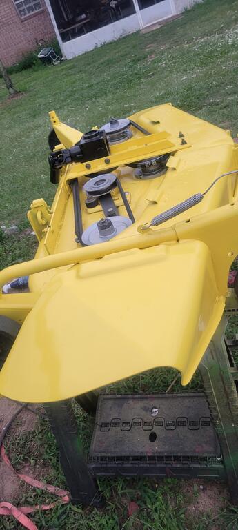

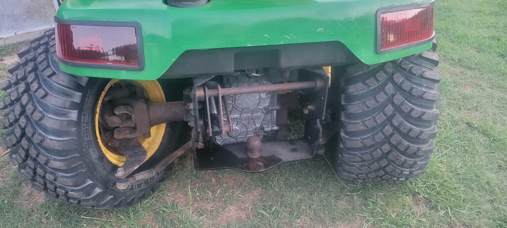

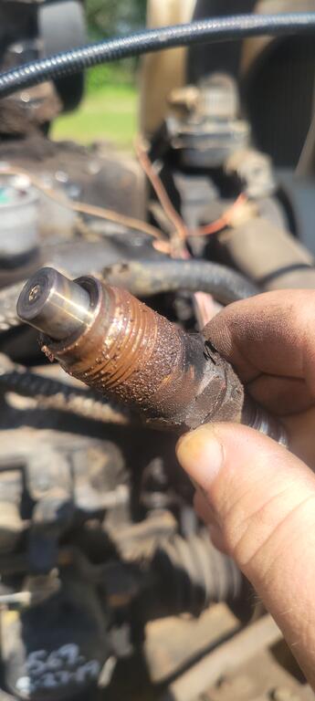

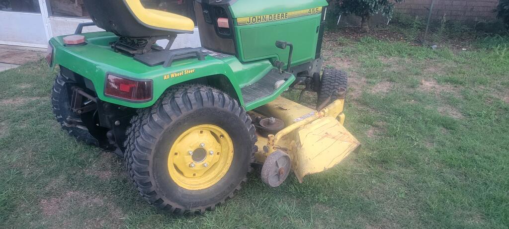

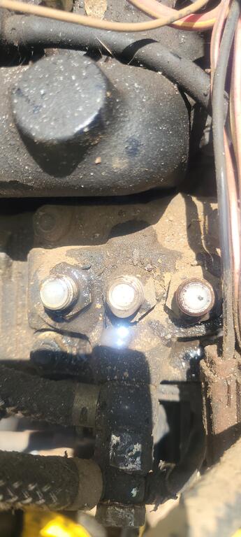

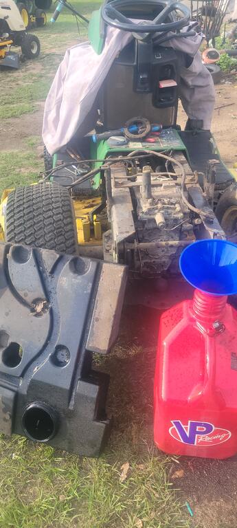

RED-Z06 2,718 #1 Posted June 26, 2024 Ive had my 425 for a couple years, 445 about a year, and last month i came across a 455 Diesel AWS that had sat neglected about 6 years. It was rough, low compression on all 3 holes, water in the tank, lines, lift pump, injection pump, injectors. I pulled the head off; cleaned up the valves, soaked the rings, new gasket. New injectors, new injection lines, lift pump..and it fired right up. Rebuilt the 60" deck, just needs a hood now, and a new gauge cluster. Only 608hrs on it. https://youtube.com/shorts/YINnFamWggQ?si=QfWirhleA5r9yLN7 12 Share this post Link to post Share on other sites
Pullstart 69,152 #2 Posted June 26, 2024 That all wheel steering rear axle has some crazy Ackerman built into it! 3 Share this post Link to post Share on other sites
RED-Z06 2,718 #3 Posted June 26, 2024 3 hours ago, Pullstart said: That all wheel steering rear axle has some crazy Ackerman built into it! It definitely does. What's cool is, with the 60" deck, the uncut circle is only about 6" across when turning 1 Share this post Link to post Share on other sites
