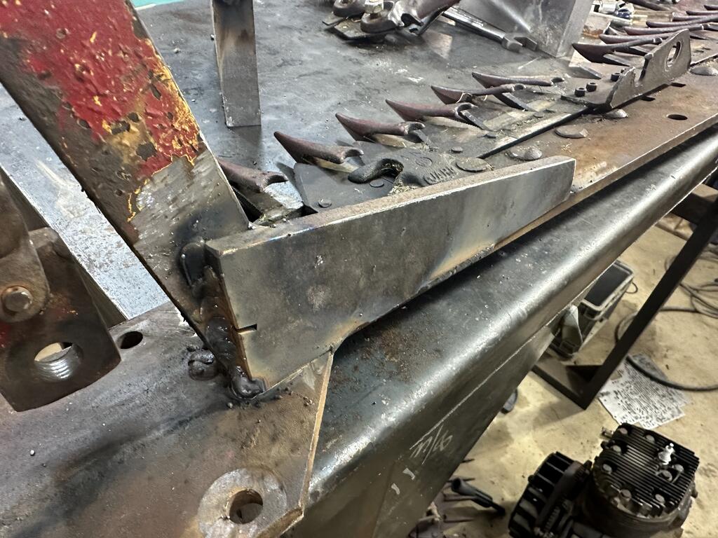

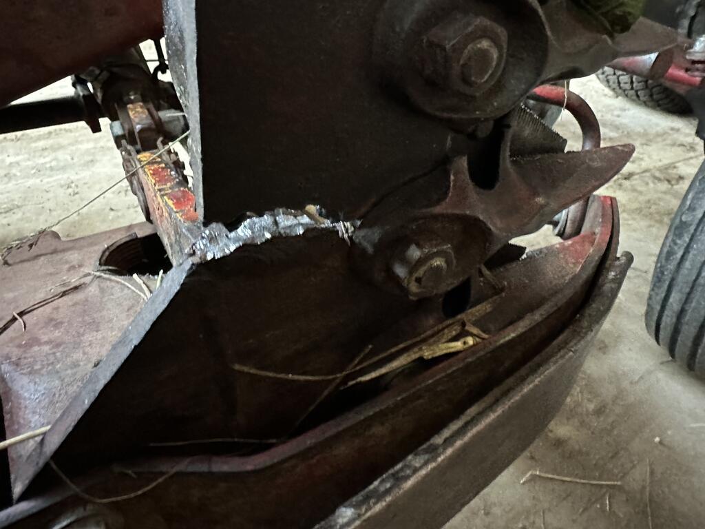

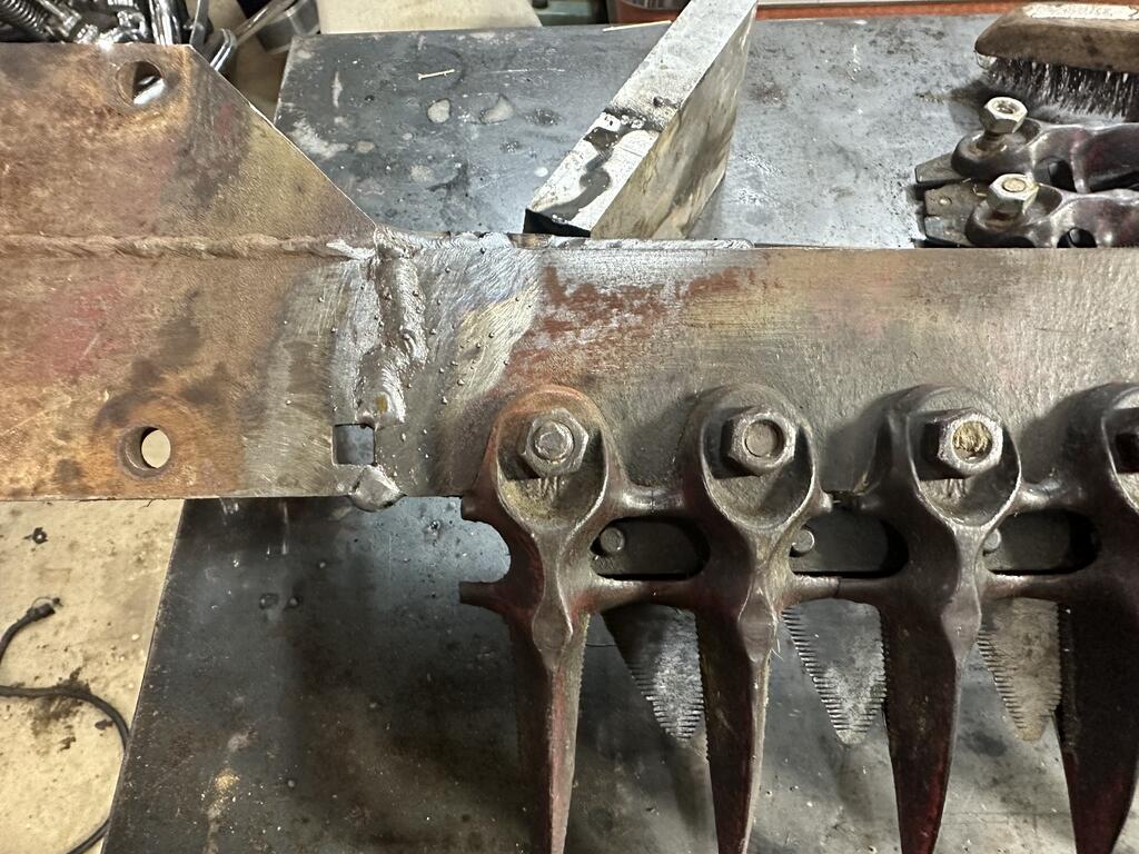

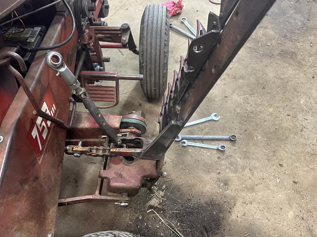

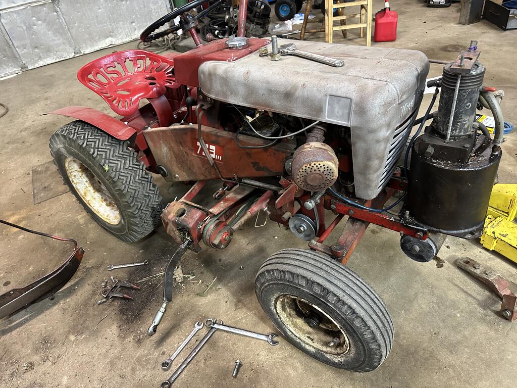

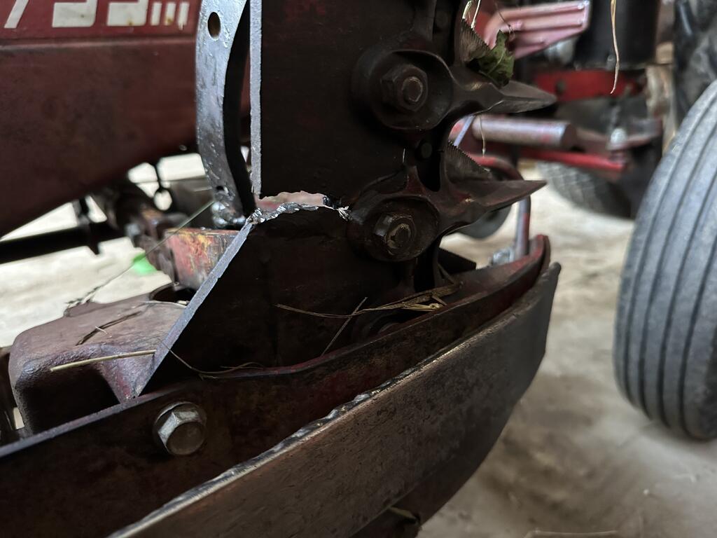

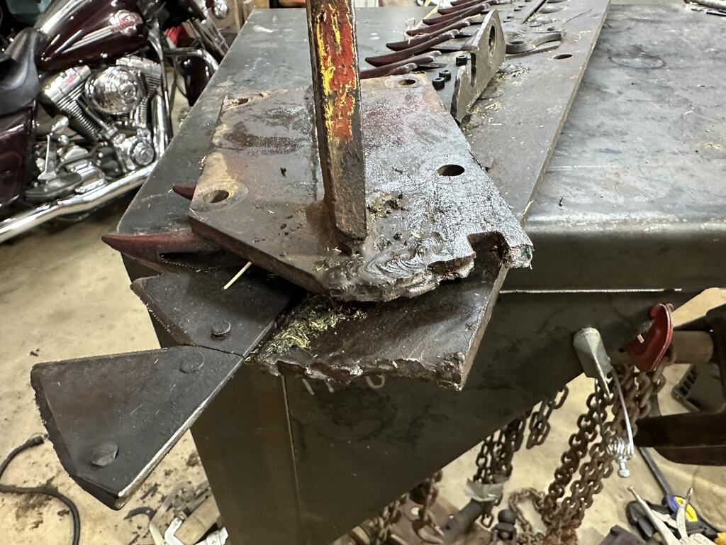

Pullstart 64,380 #31 Posted July 7, 2024 Well, I’ve had $150 worth of fun already, but I hope I didn’t do too much carnage! The mower has been repaired here before. This tells me it should be able to be repaired again, without too much other failures. I have another Jari sickle bar to Rob parts from if needed. I’ll need to tear this down, grind the crack to a 45, and weld it up good. I might even end with a fish plate on the back side, if possible. 3 Share this post Link to post Share on other sites
Tractorhead 9,087 #32 Posted July 7, 2024 An stiffner in the rear after rewelding can maybe helpful to prevent another Breakdown. i would considering about an adapted Angleiron formed with heat to the shape of the Mainbar. 1 Share this post Link to post Share on other sites
pfrederi 18,279 #33 Posted July 8, 2024 Sorry about the break. I always thought the hydro action was harsh. Perhaps a dampener valve like WH used on some D series or just a flow restricter so the cylinder response is slowed down??? 1 Share this post Link to post Share on other sites
Pullstart 64,380 #34 Posted July 8, 2024 22 minutes ago, pfrederi said: Sorry about the break. I always thought the hydro action was harsh. Perhaps a dampener valve like WH used on some D series or just a flow restricter so the cylinder response is slowed down??? I’m learning 1 Share this post Link to post Share on other sites
Tractorhead 9,087 #35 Posted July 8, 2024 A restriction valve for slower lifting is imho here the better solution. The lift goes very rude upwards. but that is just my humble opinion. the drop can be also be little reduced, but that can be handles with gentlier opening the drain Valve. The lift up is for my opinion the more stress for the Sicklebar. 3 Share this post Link to post Share on other sites

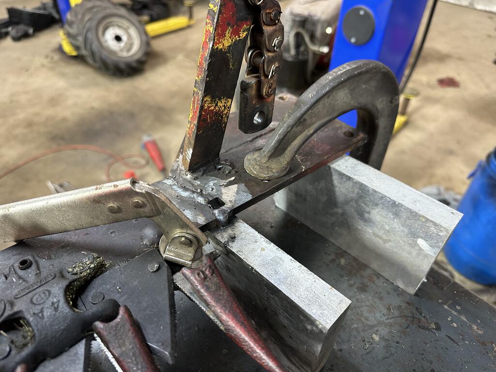

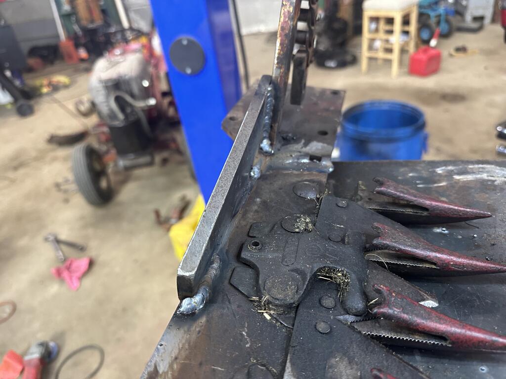

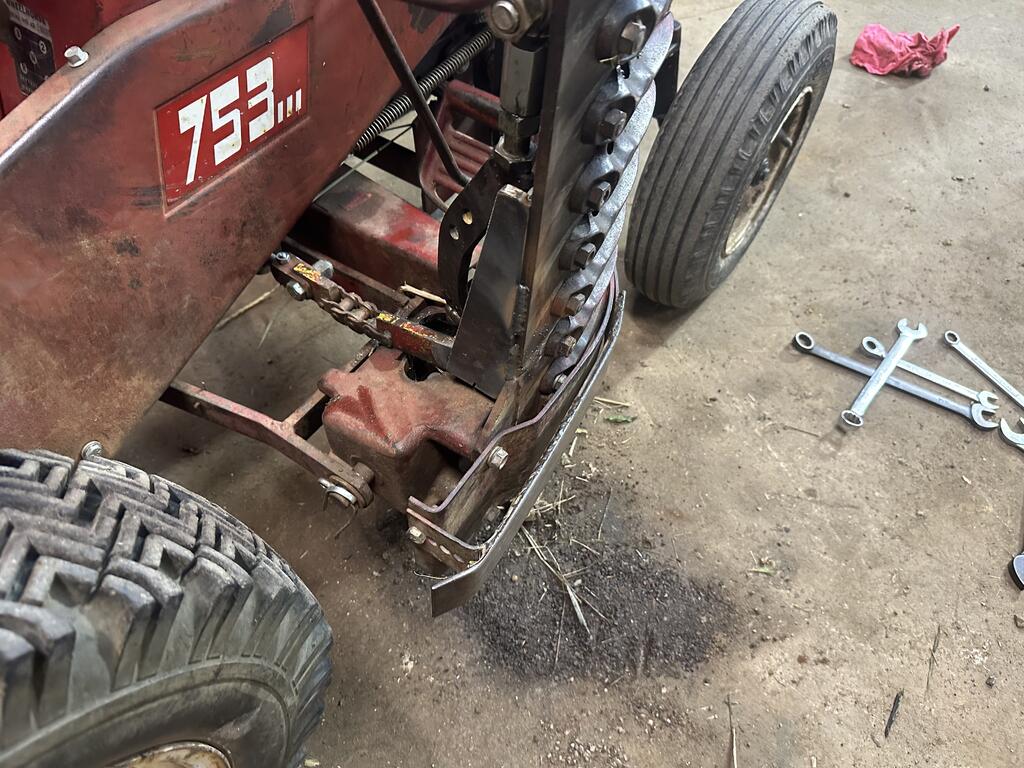

Pullstart 64,380 #36 Posted July 29, 2024 I need this mower to clean out my old food plots and begin planting. I took it apart today, gave the crack a good clean chamfer grind, and got to welding. I added a brace to spread the load of it lifting too. Perfect timing, it began raining as I set out to mow. IMG_8294.mov 3 Share this post Link to post Share on other sites
