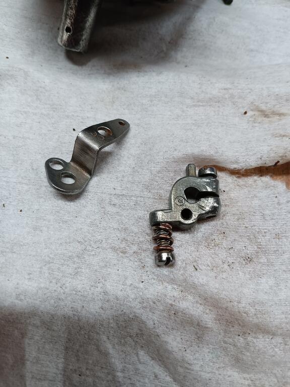

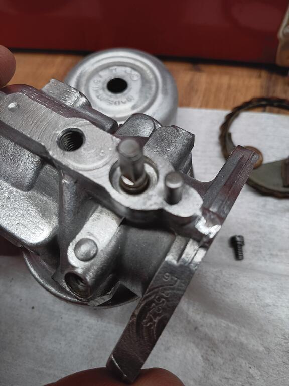

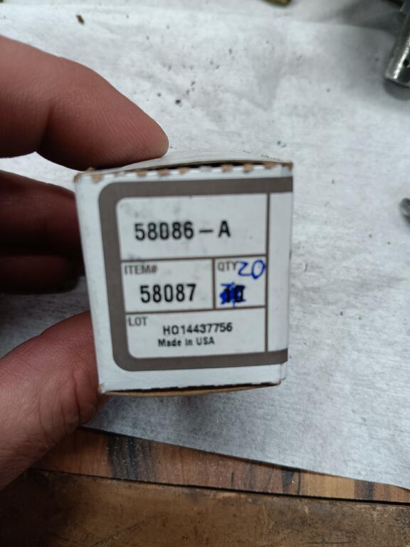

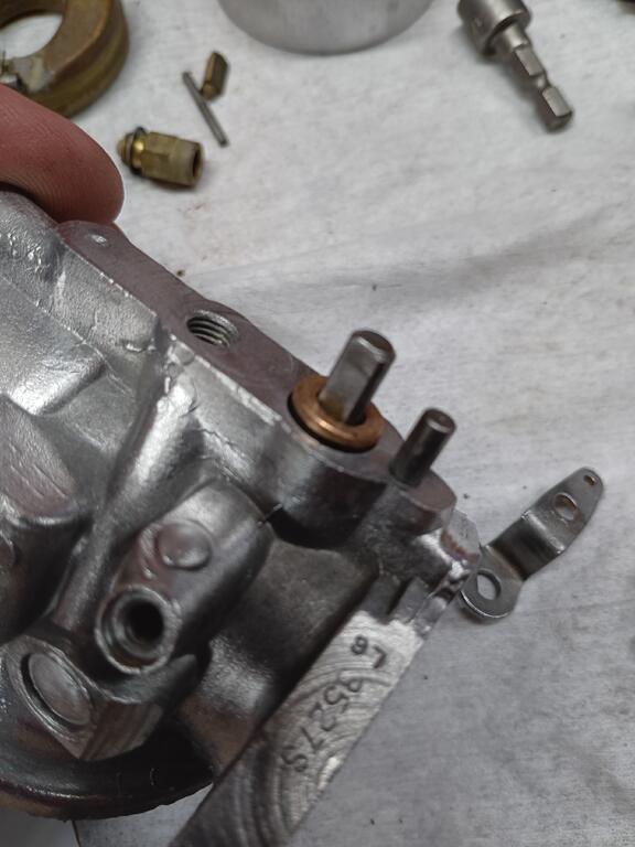

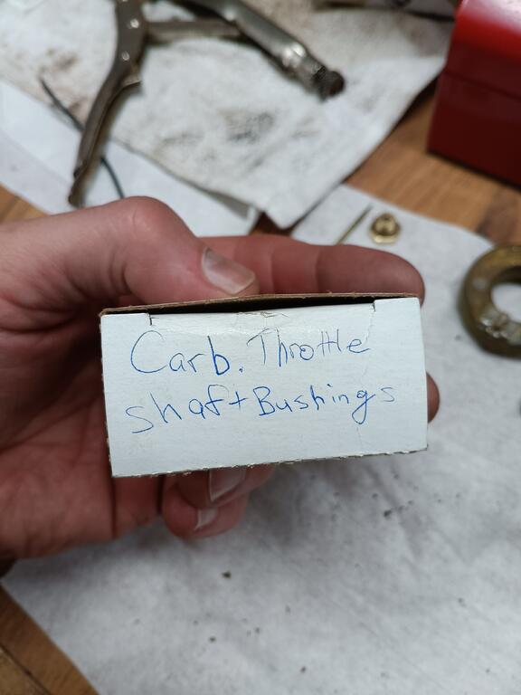

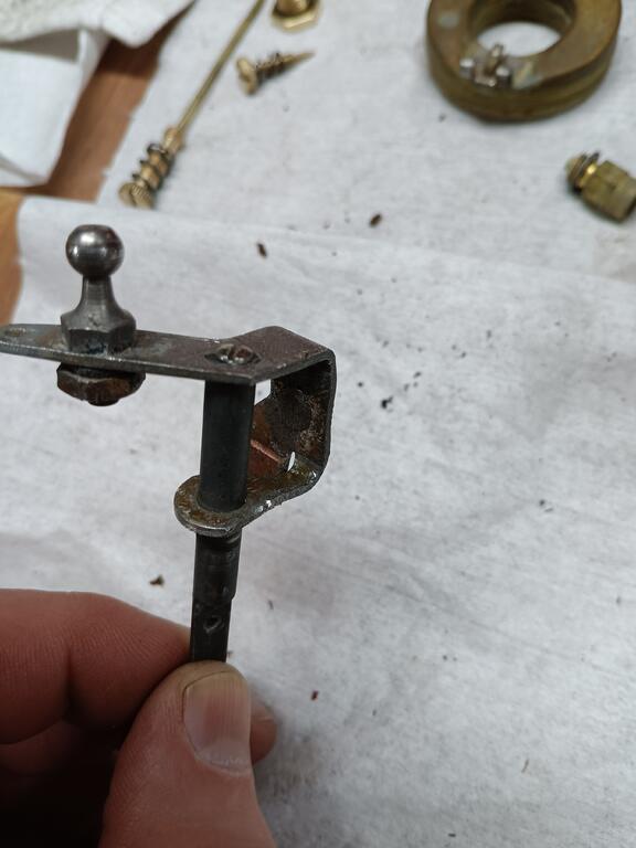

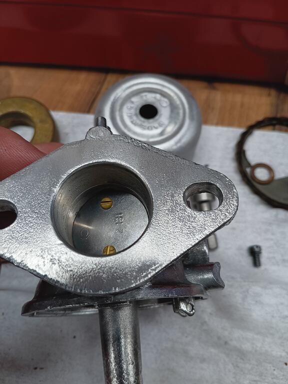

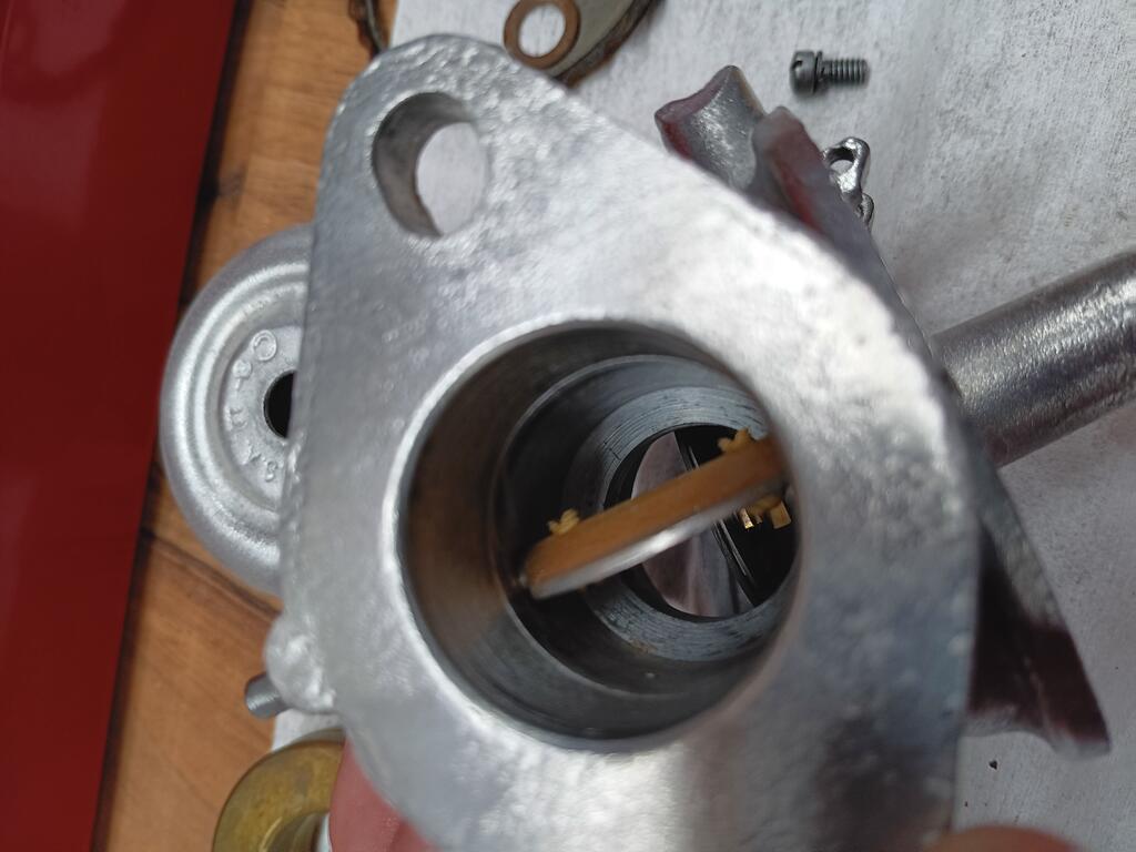

ebinmaine 68,978 #8 Posted June 25, 2024 OK here goes... Most Kohler (and the couple Walbro) carbs I've seen have a one piece throttle shaft. The throttle blade screws must be removed to get the shaft out. Here's the throttle blade (butterfly) screws that need to be ground out. If you look carefully at the BACK of the screw they're "forked" or staked in place to prevent them falling out. I use a Dremel and a diamond chain saw sharpening bit to CAREFULLY AND SLOWLY grind away the whole back of the screws. The older (60s?) Carter (maybe Kohler?) carbs you do NOT need to grind out the throttle blade (butterfly) screws. Here's why: The top of the throttle shaft simply unscrews. Leaving the bore that accepts the washer right open. I believe this is a Hillman part number. If you decide to send them to me I have all the parts right here in stock. The only thing I ask is that one becomes a Supporter of Redsquare. It helps @nylyon keep the best site on the interwebs Goin strong! I charge for parts and chemicals only. I do not charge Redsquare Supporters for labor. USPS can get a carb across the country for about $10 to $12. Figure around $45 to $50 total depending on what you need..... 2 2 Share this post Link to post Share on other sites
