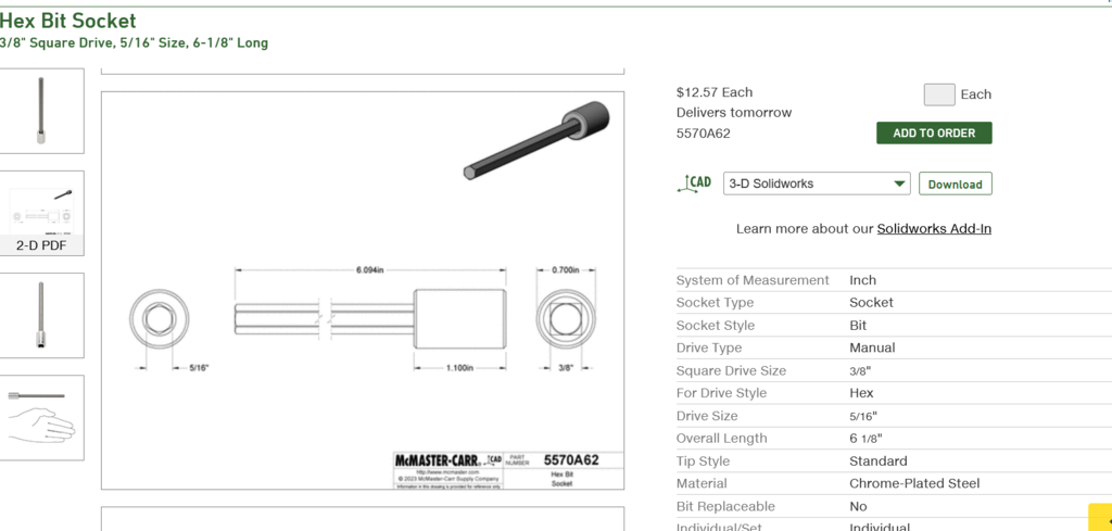

If you do this get yourself  a long reach socket allen wrench  Makes removing manifold bolts from pump much easier
Also make sure you have 5/16 and 3/8"' 12 point sockets (3/8 drive works)
