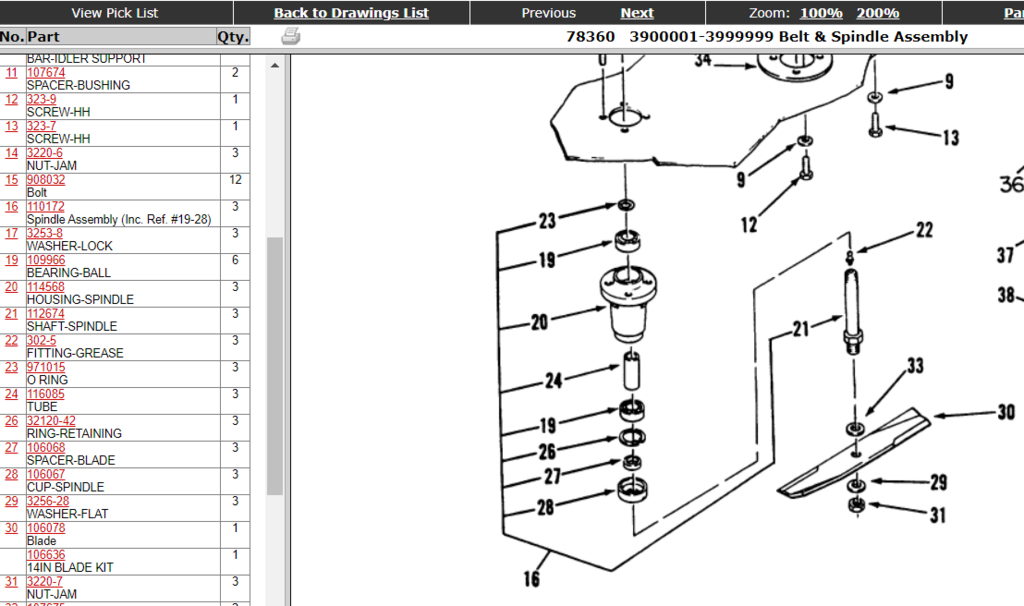

Brockport Bill 1,825 #1 Posted June 20, 2024 i understand the spindles varied through the yrs and also by mower model -- and in later yrs the shafts were from 5/8 to 3/4 --- what shaft size would be on a '95 deck, 48 inch, likely model deck # 78360 - thanks Share this post Link to post Share on other sites
Brockport Bill 1,825 #2 Posted June 20, 2024 2 minutes ago, Brockport Bill said: i understand the spindles varied through the yrs and also by mower model -- and in later yrs the shafts were from 5/8 to 3/4 --- what shaft size would be on a '95 deck, 48 inch, likely model deck # 78360 - thanks the shaft shows as part # 112674 -- also is it a keyed shaft or not? Share this post Link to post Share on other sites

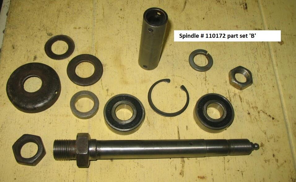

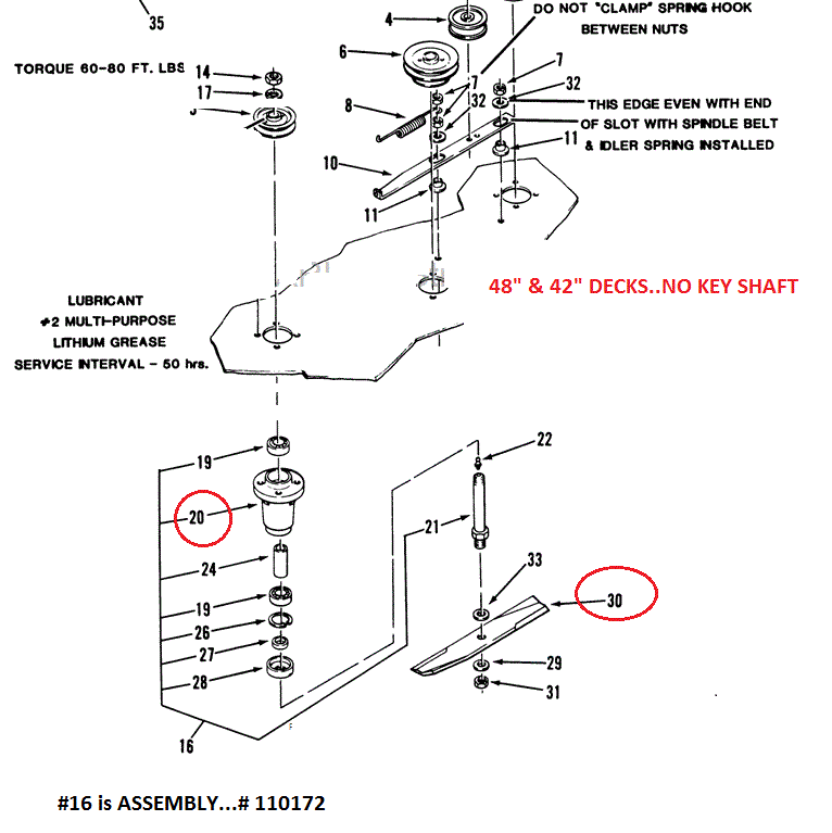

daveoman1966 3,808 #6 Posted June 20, 2024 This is the spindle---shaft # 112674 and TWO bearings # 109966. The shaft top end is turned down to 5/8" while the rest of it is 3/4" ID...thus the same bearings top & bottom---#109966. I have all the parts shown here, except the shaft. $50 bux via Paypal (as money to friends)..shipped. Share this post Link to post Share on other sites

Lee1977 7,041 #8 Posted June 21, 2024 They are metric spindles 17 mm at the bearings 3/4" at blade and 5/8" at the pulley. The bearings are 6203 ( 40 mm OD 17mm ID and 12 mm thick). Share this post Link to post Share on other sites
peter lena 9,092 #9 Posted June 21, 2024 @daveoman1966 love assembly # 110172, picture , most glairing opportunity is the removal / regrease , of the related bearings . think hi stress / heat failure , imagine no whyining bearing noise , 12 related bearings , all moving from a lever start , my decks easily move by hand , at PTO lever start point, no screaming clutch , thats telling you how things are moving . 3 horses set up the same way , lucas 550 deg flash point , green chassis grease . once you do it , you instantly think about applying it to other trouble areas . pete 1 Share this post Link to post Share on other sites
Brockport Bill 1,825 #10 Posted June 22, 2024 On 6/21/2024 at 8:32 AM, peter lena said: @daveoman1966 love assembly # 110172, picture , most glairing opportunity is the removal / regrease , of the related bearings . think hi stress / heat failure , imagine no whyining bearing noise , 12 related bearings , all moving from a lever start , my decks easily move by hand , at PTO lever start point, no screaming clutch , thats telling you how things are moving . 3 horses set up the same way , lucas 550 deg flash point , green chassis grease . once you do it , you instantly think about applying it to other trouble areas . pete Pete --- have you noticed some of the online deck parts diagrams show a rubber O ring at top of spindle shaft on top of the top bearing and others don't ?? Do you know why that is? My assumption is for preventing water intrusion ? Any insights?? Bill Share this post Link to post Share on other sites
