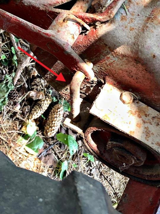

So apparently I'm a bit of a putz.
I work on the tractor in the evenings.
Pushed it around the front yard today around noon in full sunlight and noticed something vibrating.
It was the rod that tightens the break band mechanism.  That is where the noise is coming from.  I've loosened  off the nut that holds it in place but I'm going to have to  inspect it further.
Still going to do the kerosene flush with a magnet however.
oliver2-44
Glad you found an easy to cure reason for the noise.
