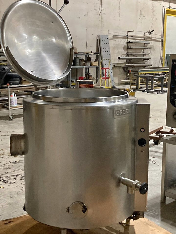

bc_gold 90 #1 Posted June 16, 2024 Recently fell victim to a bargain purchase, this 40 gallon Groen steam kettle, previous owner informed me the flame would not stay lit. After some research figured a faulty low water level sensor / controller be the culprit. The sensor probe was covered in iron oxide, the water jacket is full of the same, The kettle is made from 304 stainless steel, with some removable brass,firrings any members here have a suggestions on how to clean the internal jacket. Share this post Link to post Share on other sites

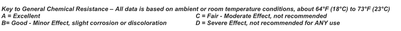

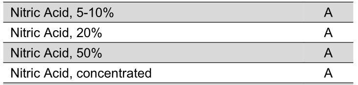

bc_gold 90 #12 Posted June 17, 2024 (edited) 8 hours ago, wh500special said: Of those, nitric would probably be my pick. I’m not sure what is a reasonable concentration but I’m sure it’s probably pretty low…like in the 10% range Nitric acid all concentrations in bulk, ship in a stainless drum, the one I purchase looks like a beer keg with a hefty deposit. From the chemical compatibility chart for 304 was surprised, citric acid is rated with a "B". Full document, https://marketing.industrialspec.com/acton/attachment/30397/f-00b5/1/-/-/-/-/304-stainless-steel-chemical-compatibility-chart-from-ism.pdf Edited June 17, 2024 by bc_gold Share this post Link to post Share on other sites
