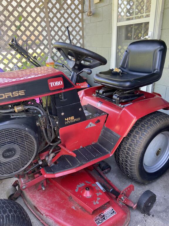

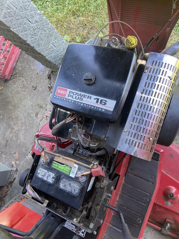

lynnmor 7,535 #4 Posted June 12, 2024 (edited) From what I can see, the tractor looks pretty good. You will of course need a new seat soon and the valves are due for adjustment. The fuel filter appears to be old and it might be time to replace all fuel hose. One front tire has been replaced so it is likely other tires are dry rotted. The deck wheels need to be replaced. This is a 28 year old tractor that apparently needs the usual TLC to get it right. All the anniversary edition got you was some pretty gold things, nothing functional was changed. Edited June 12, 2024 by lynnmor 1 Share this post Link to post Share on other sites

ebinmaine 70,205 #6 Posted June 12, 2024 @lynnmor makes good points. The "right price" is the one that makes BOTH buyer and seller satisfied. I'm not familiar with your market. Up here that tractor for a $1K is OK. Not a steal but likely a reasonable purchase. I'd definitely ask the seller "Is there anything you've been meaning to do?" Any work they've known it needs but haven't gotten to. However you need to phrase it to glean the information. Knowing what Lynnmor pointed out perhaps you could negotiate kindly towards $800 ish. Share this post Link to post Share on other sites
lynnmor 7,535 #7 Posted June 12, 2024 3 minutes ago, Cjwv1975 said: Are the valves hard to adjust only have done stuff on the Kohler K series engines never had a onan engine WH Not hard to adjust but here is much to remove to get there. You will need new intake, valve cover and exhaust gaskets. The exhaust and intake needs to come off, but this would be a great time to glass bead the exhaust and paint it. Also paint the valve covers and inspect the intake manifold for leakage and gouges where the heat shields often rub. So you don't get confused, choose a valve to adjust and rotate the crankshaft till that valve is opened to its maximum amount and then rotate the crankshaft one turn. Repeat three more times. The Onan Service Manual, which you will download, has you doing a dance that has you watching for timing marks and it ain't necessary. 1 Share this post Link to post Share on other sites
