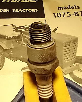

stevasaurus 23,048 #2 Posted June 8, 2024 How does the spark plug look ?? Could be the break in period. Share this post Link to post Share on other sites

rmaynard 15,908 #9 Posted June 9, 2024 20 hours ago, stevasaurus said: How does the spark plug look ?? Could be the break in period. Didn't check the plug. Will do that today. Share this post Link to post Share on other sites

rmaynard 15,908 #13 Posted June 9, 2024 Thanks for the replies so far. I will address a few things. I have been rebuilding engines since I was 14 (60 years) when I rebuilt a Volkswagen engine. Since 2009, I have been involved in strictly rebuilding K-Series Kohler engines. Everyone of the engines on all of my current tractors and those of which I sold, were rebuilt by me. Though I don't do the machine work, I have one of the most reliable small engine machinists at my disposal. When asked if he needed for me to leave a copy of the engine specs, his reply was "no, if I don't have them in my head, I have them in my book. Just leave your new parts". As a precursor to any conversations about fuel, This is not meant to start an off-track conversation, but I don't use any snake oil. I only use ethanol-free gas. Enough said about that issue. This is a 701 with a K-161. The fuel tank has a glass bowl strainer, new fuel lines, and an extra see-thru fuel filter. The fuel pump was inspected prior to installation, and the check valves functioned better than any pump I've worked with in the past. Pressure testing showed no leakage either forward, backward or past the diaphragm. The carburetor was thoroughly rebuilt by me. It is a Carter carb, original to that engine. The float valve functions properly. There is no siphoning into the bowl when the engine is stopped, as all fuel components sit lower than the intake of the carburetor. 21 hours ago, stevasaurus said: How does the spark plug look ?? Could be the break in period. Steve, here is the plug. Looks pretty normal to me. I think you are probably on to something with break-in. A little blow by at the piston rings as they are seating could account for the gas smell. I am going to refill the crankcase with SAE 30W non-detergent oil later today and see if it happens again. Also, the grandson always throttles down before shut off, at least when I see him. 2 1 Share this post Link to post Share on other sites
