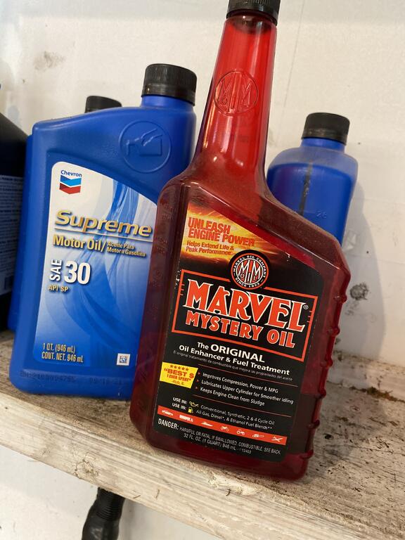

Sparky-(Admin) 24,687 #1 Posted June 7, 2024 No idea whats in it…it’s a mystery ? Vise Grip Garage /Derek Bieri reference that some of you may get. My question is: If you do an oil change and use it (I used just over 1/2 a qt of it) do you leave it in for the full 25 or so hours between oil changes? Or slap a couple hours on it, get it hot a few times, and drain out and go back to straight 30w? 2 Share this post Link to post Share on other sites

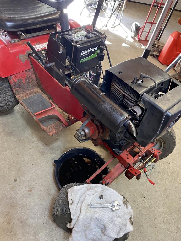

Sparky-(Admin) 24,687 #3 Posted June 7, 2024 1 minute ago, ebinmaine said: My first thought is: Why are you using it? Engine have issues? It was my 14 Magnum that I thought might have had a sticking valve at one point. Did an oil change (super old black skanky oil) and added the snake oil. Of course it didn’t change anything because my issue was a blockage in the exhaust. But now that it’s on there, with fresh 30w as well, what’s the next move? Leave it? Drain it? 2 Share this post Link to post Share on other sites

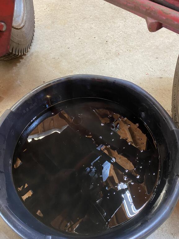

Sparky-(Admin) 24,687 #12 Posted June 8, 2024 Very dark for under 2 hours of run time. 2 Share this post Link to post Share on other sites
ebinmaine 77,606 #13 Posted June 8, 2024 27 minutes ago, Sparky said: Very dark for under 2 hours of run time. It's quite likely the cleaners in the MMO got some extra stuff off the inside of the block. I'd take that as a good sign but I'd also be prone to another quick run & change in the next few hours of run time. For $10-$12 worth of oil it'd just make me feel better. 3 1 Share this post Link to post Share on other sites

lynnmor 8,655 #15 Posted June 8, 2024 6 hours ago, ebinmaine said: I'd also be prone to another quick run & change in the next few hours of run time. Agree, that black oil indicates there is more crud that should be removed. 1 Share this post Link to post Share on other sites
