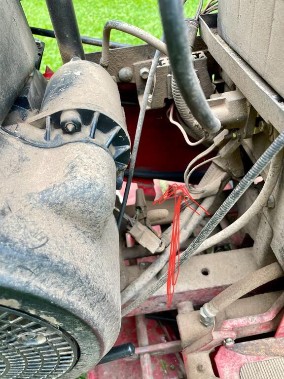

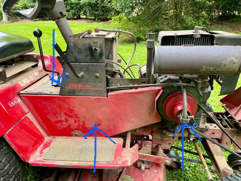

heysavoy 19 #1 Posted June 3, 2024 (edited) Hi. I am hoping someone can help me? I have a 1990 WH tractor Model 31-12KE01 with hydro static tranny and while cutting today my tractor just stopped. I heard a banging noise and then it wouldn't go forward or in reverse. I believe it may be a belt that sadly I didn't know I had. Certainly have had to change all the others but not this one. It's still intact but appears damaged. 1) not sure if that's the problem 2) not sure what belt it is or what it's called and 3) not sure how to remove. I assume I have to take all the parts off I have marked (side panel, etc.) Any help would be appreciated as always this website has been a lifesaver over the years as I continue to try and keep the ole boy runnin'. I did get the belt off and it is a NAPA 5L820W 2ddk Edited June 3, 2024 by heysavoy Share this post Link to post Share on other sites

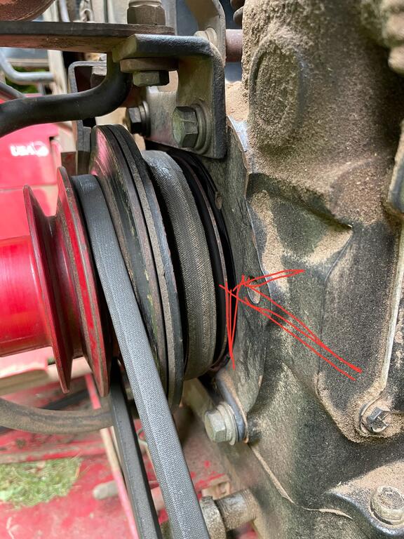

heysavoy 19 #3 Posted June 4, 2024 (edited) 3 hours ago, 953 nut said: You are correct about having to remove the belt guard and PTO belt. The drive belt form your tractor is Wheel Horse part # 108501 which is an 82" by 5/8" belt. The Kevlar belts from Tractor Supply work well and are genneraly in stock. Thanks so much for your reply. I removed the belt guard and PTO belt. I'm hoping I can slip the belt over the fan in the rear that I see and those 2 parts are all I will need to take off. Waiting on new belt to arrive. Any idea on where to find a diagram on how to install? Edited June 4, 2024 by heysavoy Share this post Link to post Share on other sites
oliver2-44 10,341 #4 Posted June 4, 2024 While you have the belt guard off check your idler pulley. A bad bearing in an idler pulley can ruin a belt. Also check the idler spring is in place and not stretched out looking 1 Share this post Link to post Share on other sites
953 nut 57,767 #5 Posted June 4, 2024 11 hours ago, heysavoy said: how to install The top part of the belt runs below the flat idler pulley, the lower part runs above the rail on the belt guard. Share this post Link to post Share on other sites
heysavoy 19 #6 Posted June 4, 2024 2 minutes ago, 953 nut said: The top part of the belt runs below the flat idler pulley, the lower part runs above the rail on the belt guard. Thanks. Do you know if I can replace the belt without removing the rear tire or the fan that sits near the idler pulley? Share this post Link to post Share on other sites
Ed Kennell 40,414 #7 Posted June 4, 2024 13 hours ago, heysavoy said: I did get the belt off and it is a NAPA 5L820W 2ddk Was it completely broken or did the tensioner spring break? I find it easier to install the new belt by removing the idler pulley and the tensioner spring. Put the belt on the hydro pulley first, then on the engine pulley. No need to remove the fan or wheel although it does make it easier to work with the wheel off. Then, after checking the pulley bearing, install the pulley and then using a flat screw driver or brake spring tool to install the spring. 2 1 Share this post Link to post Share on other sites

heysavoy 19 #10 Posted June 4, 2024 2 hours ago, Ed Kennell said: Was it completely broken or did the tensioner spring break? I find it easier to install the new belt by removing the idler pulley and the tensioner spring. Put the belt on the hydro pulley first, then on the engine pulley. No need to remove the fan or wheel although it does make it easier to work with the wheel off. Then, after checking the pulley bearing, install the pulley and then using a flat screw driver or brake spring tool to install the spring. No it was not completely broken but definitely frayed which was somewhat of a blessing as it allows me to see how it goes on and I also used the belt for a replacement part number. Now I need to see how the idler pulley comes off and how big of a deal it is to take off the tensioner spring as well. Ed said Then, after checking the pulley bearing, install the pulley and then using a flat screw driver or brake spring tool to install the spring. That's the part for me that could be a little dicey. Thanks for taking the time to respond. Share this post Link to post Share on other sites
