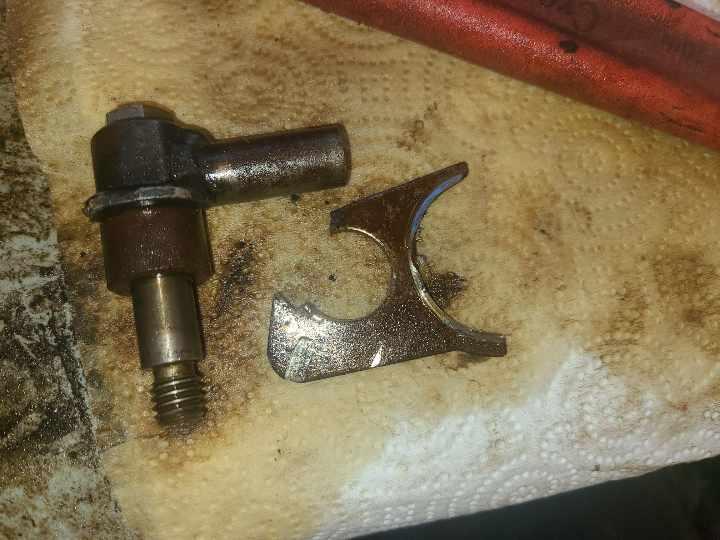

Erik1979 11 #1 Posted June 3, 2024 Good Morning! I recently acquired a 310-8 Wheel Horse tractor with a tiller attachment to till some fields in the back yard. This setup was working great until last weekend when the Tractor shifted itself into High gear and wouldn't shift out. I generally do a lot of reading and research before posting anything in forums. I've managed to remove the Unidrive 8 speed Transmission and I've discovered the usual culprit High/low fork is completely broken. I'm not completely sure where I could pickup a replacement. The Serial number (ID Number) listed under the Seat is 2110K806 35097 I'm hoping some of you guru's can help to point me in the right direction. I am having issues removing the input shaft and would also like some advice for that process, as all the videos I've found online for this seem to jump past the process of removing this and I won't want to damage anything. Thank you all in advance, Erik 2 Share this post Link to post Share on other sites
WHX?? 53,346 #2 Posted June 3, 2024 1 hour ago, Erik1979 said: removing the input shaft Guessing you mean removing the pulley? If so make sure the set screw is out completely and get some penetrant oil on it. A small puller works if you can get behind it. other wise a couple of wooden wedges behind it. Most likely shift fork but who knows untill the case is split. 1 Share this post Link to post Share on other sites
gwest_ca-(File Mod) 11,846 #3 Posted June 3, 2024 Here is a list of the parts and the shift fork shows as no longer available. There are two pages making up the transmission parts. https://www.partstree.com/models/21-10k806-310-8-toro-garden-tractor-1989/mechanical-transmission-8-speed-25/ 1 Share this post Link to post Share on other sites

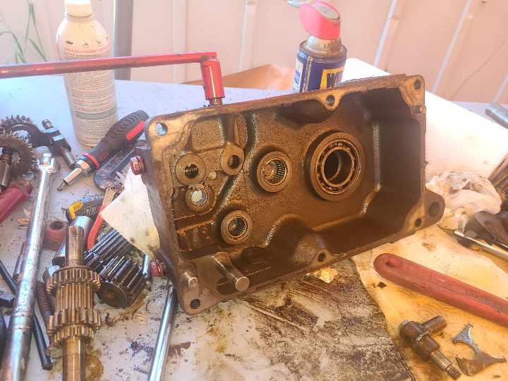

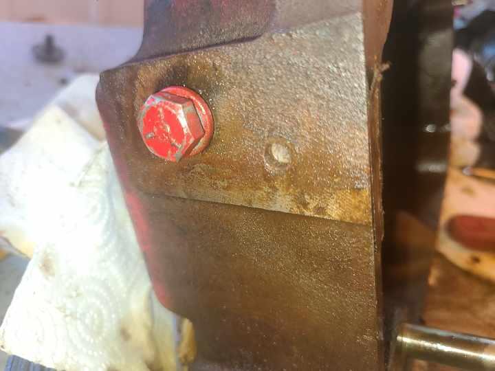

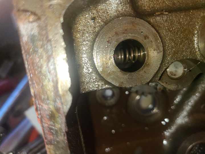

Erik1979 11 #9 Posted June 3, 2024 I've managed to get most of the Tranny apart. Does anyone have any suggestions on how to remove the plug holding the ball bearings/spring in place? I'm attaching photos (as promised) of where I'm at and the interns who are helping me out on the project. 2 1 Share this post Link to post Share on other sites
ebinmaine 75,769 #10 Posted June 3, 2024 12 minutes ago, Erik1979 said: interns who are helping me out Buff Orpington? 13 minutes ago, Erik1979 said: suggestions on how to remove the plug Is it a solid steel plug like a baby miniature freeze plug? You might be able to drill it very carefully, then stick a screw in it. Then pull the screw with pliers. 2 Share this post Link to post Share on other sites

stevasaurus 23,516 #13 Posted June 3, 2024 Eric is correct...drill just enough to get through it. It is a 1/4" hole, try a 1/8" drill 1st. When you finish the trans, plug it with a bit of silicone grease will work also. That sits up against the trans mounting plate, it does not leak if you do not plug it. 2 Share this post Link to post Share on other sites
