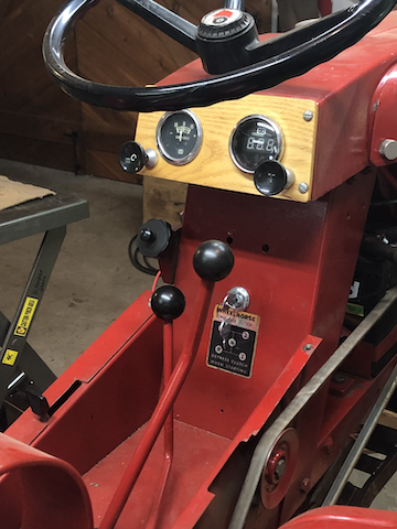

Handy Don 13,340 #26 Posted June 5, 2024 This is the view that shows the heights of the two shifters. The hi/low clears the 1-2-3-R shifter in the fore-aft direction by about 3”. I’ve been told that the round knobs were original to the 6-speeds and earlier. Also, been told that the bent 1-2-3-R lever came about with the advent of the 6-speed--prior levers were straight. Share this post Link to post Share on other sites
adsm08 2,634 #27 Posted June 5, 2024 2 hours ago, Handy Don said: This is the view that shows the heights of the two shifters. The hi/low clears the 1-2-3-R shifter in the fore-aft direction by about 3”. I’ve been told that the round knobs were original to the 6-speeds and earlier. Also, been told that the bent 1-2-3-R lever came about with the advent of the 6-speed--prior levers were straight. That would be consistent with what I have seen. The original shifter knob on my 855 is the round ball, and the lever is straight. That HY pump hangs off a bracket that bolts to the RH side of the tower, and comes back probably at least 3/4 of the way to that notch above the drive idler. I know I can get my hand in between the shifter and the pump in the "forward" gears, but that's about it. Share this post Link to post Share on other sites
Handy Don 13,340 #28 Posted June 6, 2024 (edited) 17 hours ago, adsm08 said: That HY pump hangs off a bracket that bolts to the RH side of the tower, and comes back probably at least 3/4 of the way to that notch above the drive idler. I know I can get my hand in between the shifter and the pump in the "forward" gears, but that's about it. Yep, that’ll be a challenge! I’m quite sure my 854 had hydraulics before it came to me--the lift lever and rock shaft were not installed (and showed no signs of use!), there was no ignition switch (‘cause it was still in the side-mounted box somewhere in the POs stash?), the mounting holes for the pump were clean of paint, and the engine had an undisturbed triple pulley. Another quirk was that the original-style rear tires showed no wear but one side of the wheels had rust. I suspect they’d been removed and replaced with Ags early and simply stored and the PO put them back on to keep the ags when selling to me. Just another example of the quirky histories of some of our machines! Edited June 6, 2024 by Handy Don 1 Share this post Link to post Share on other sites
