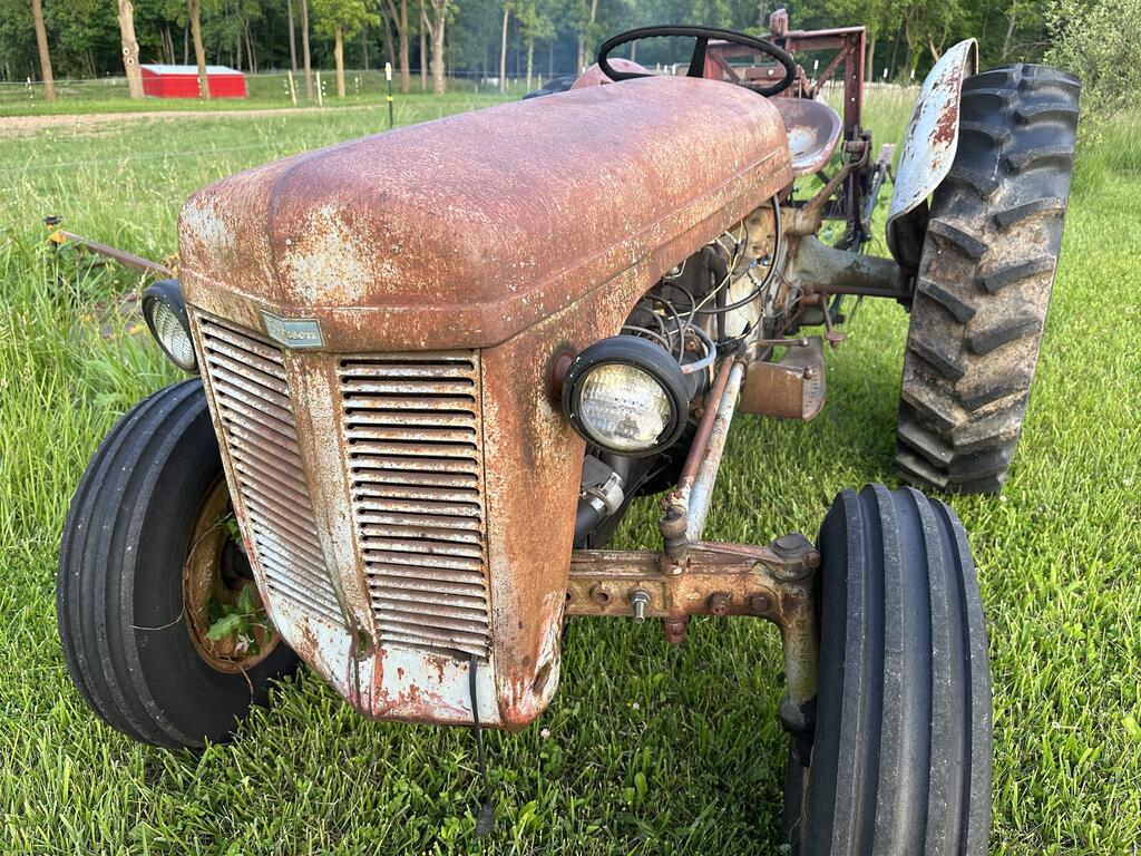

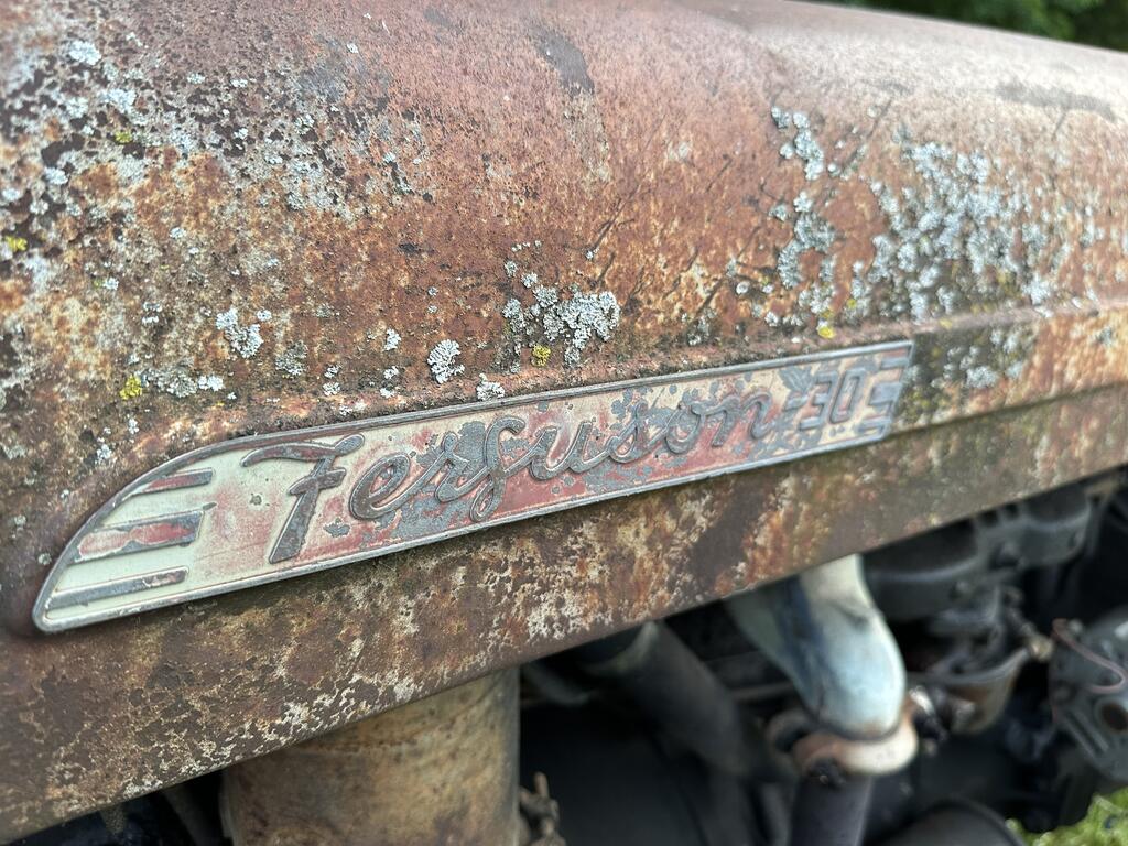

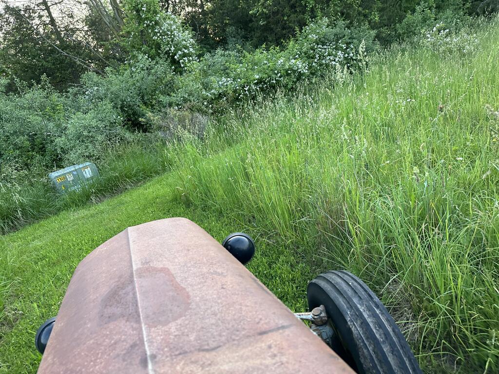

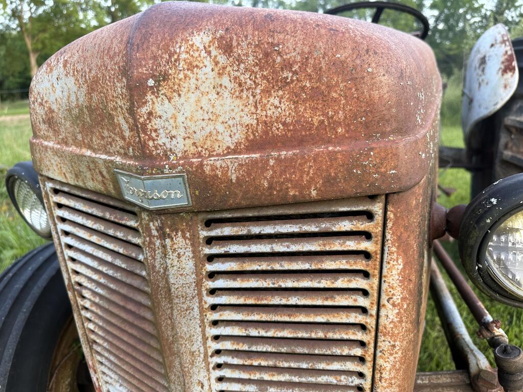

Pullstart 64,452 #1 Posted June 1, 2024 A friend of Mrs. P’s inherited this from a family member in WI. It’s been sitting for a couple years. I got it running fairly easy last night. It was great to see her take a ride on her new chore tractor! 8 4 Share this post Link to post Share on other sites
ri702bill 8,945 #2 Posted June 1, 2024 Flathead Ford power like a 9N?? Share this post Link to post Share on other sites
T-Mo-(Moderator) 4,549 #3 Posted June 1, 2024 Probably a Continental engine since it's a TO not a TE or a TEA which had British engines in them. All were OHV engines, not flat head. Share this post Link to post Share on other sites

WHX?? 50,637 #6 Posted June 1, 2024 Patina and moss to die for! 1 Share this post Link to post Share on other sites
peter lena 9,075 #7 Posted June 1, 2024 @Pullstart ever heard of mineral oil ? up at the zegray show , there is a guy that has all his old tractors period correct with an oiled finish , no rust / rot , that old iron / steel would suck that up like water , period correct retaining , finish , pete 2 Share this post Link to post Share on other sites
T-Mo-(Moderator) 4,549 #10 Posted June 2, 2024 Continental engines used on the Ferguson TO tractors had side distributors with the coils horizontal. British or Standard engines also had side distributors with the coils vertical. Both engines had the distributors and the coils on the left side. The Continental engines will have the oil filters vertical and the British (Standard) engine the oil filter will be horizontal at an angle. Both engines have the oil filters on the left side. On the Perkins diesel engines, then I have no clue. 2 Share this post Link to post Share on other sites
