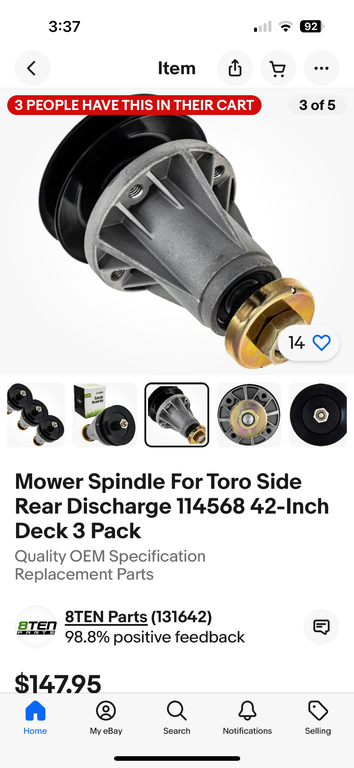

Lane Ranger 11,125 #1 Posted May 30, 2024 Have any Red Square members purchased these spindles from a new company called 8TEN. ?? They are selling these on eBay. -a set of three at about the price of one new Toro spindle?? They appear to be selling with all the related parts according to their pictures posted on the eBay advertisement. 5 Share this post Link to post Share on other sites
Skwerl58 750 #2 Posted May 30, 2024 I ordered one of their replacement spindles for a Troy Bilt ZRT and it looks and operates well. Only time will tell about the qualty of the bearings, shaft and overall endurance of them. 4 Share this post Link to post Share on other sites
Vintage_Wheel_Horse_Lover 21 #3 Posted May 31, 2024 did you order them? if so keep me updated. I have a 42inch deck off a b100 and its been down for 3 or so years because I didn't wanna pay that much for a 150ish per spindle when I needed all 3. when I had other mowers to use. because 450 for spindles is Alot when your 17 or 18. but I could afford that set if they're decent 2 Share this post Link to post Share on other sites
Lane Ranger 11,125 #4 Posted May 31, 2024 9 hours ago, Vintage_Wheel_Horse_Lover said: did you order them? if so keep me updated. I have a 42inch deck off a b100 and its been down for 3 or so years because I didn't wanna pay that much for a 150ish per spindle when I needed all 3. when I had other mowers to use. because 450 for spindles is Alot when your 17 or 18. but I could afford that set if they're decent I did not order them but I believe I will! This is the response I received from 8TEN customer service: Hello and thank you for reaching out. Yes, the pulleys are included as well as any part shown in the photo. If you'd like us to determine fitment, I would the full model number and serial number of your machine. Once you send us the information, we can confirm correct fitment for your specific machine. Attached below is a reference picture showing what the possible model/serial/PIN tags can be so you know what to look for. Best regards, Bria ******* spindles, pulleys and all the pictured parts for this price is worth the money 💰 as far as I am concerned! 2 Share this post Link to post Share on other sites

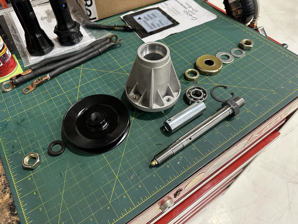

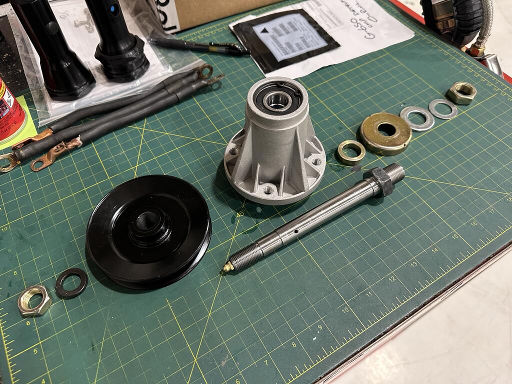

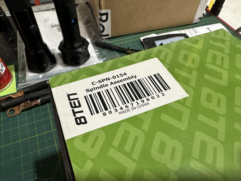

Steve Janninck 171 #9 Posted August 2, 2024 This is what comes in the box. The sealed bearings are PN 6203RS, not sure of the quality in the long run, but seem to roll like a Timkin / SKF. The lower bearing is locked in with a snap ring. 6 Share this post Link to post Share on other sites

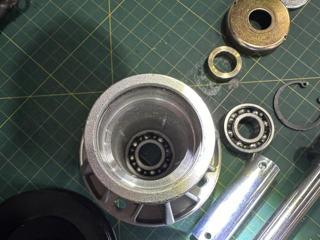

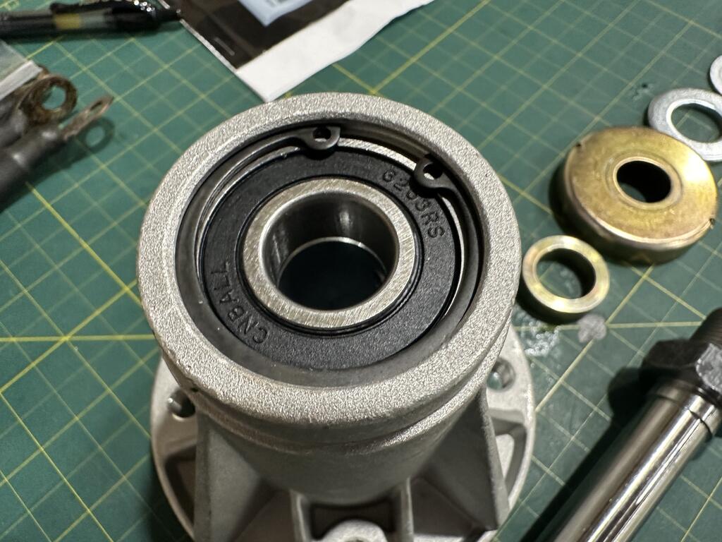

Steve Janninck 171 #10 Posted August 2, 2024 I disassembled the spindle. Removing the lower bearing, I was surprised to find that the seals on the inside of the bearings were already removed. This allows the grease that comes from the zirk fitting to actually get to the bearing! Most new spindles I have worked with all seem to have seals on both sides of the bearing. 5 Share this post Link to post Share on other sites

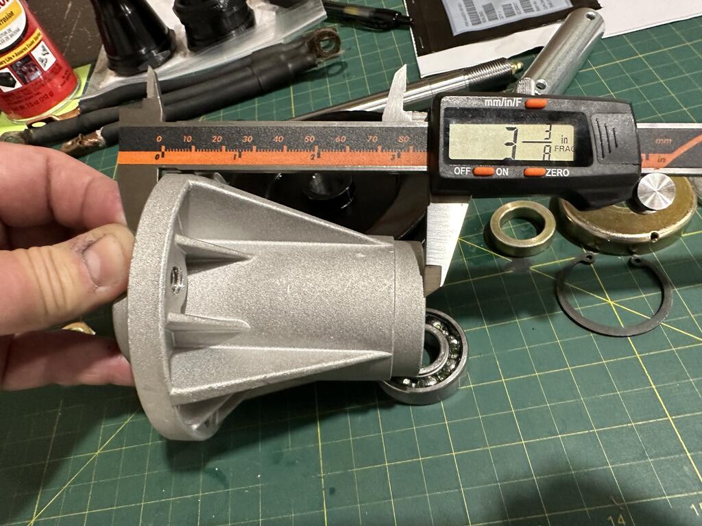

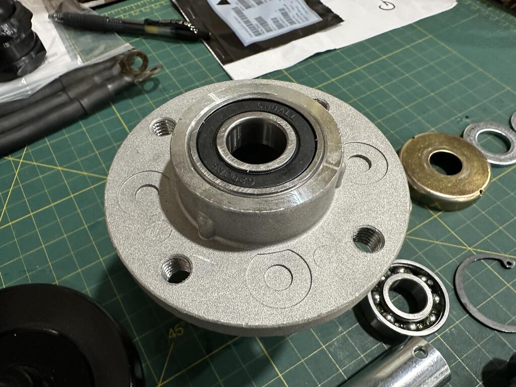

Steve Janninck 171 #11 Posted August 2, 2024 Upper bearing and flange. The housing even has the 3 little centering nubs in the casting for installing in the deck. 3 Share this post Link to post Share on other sites

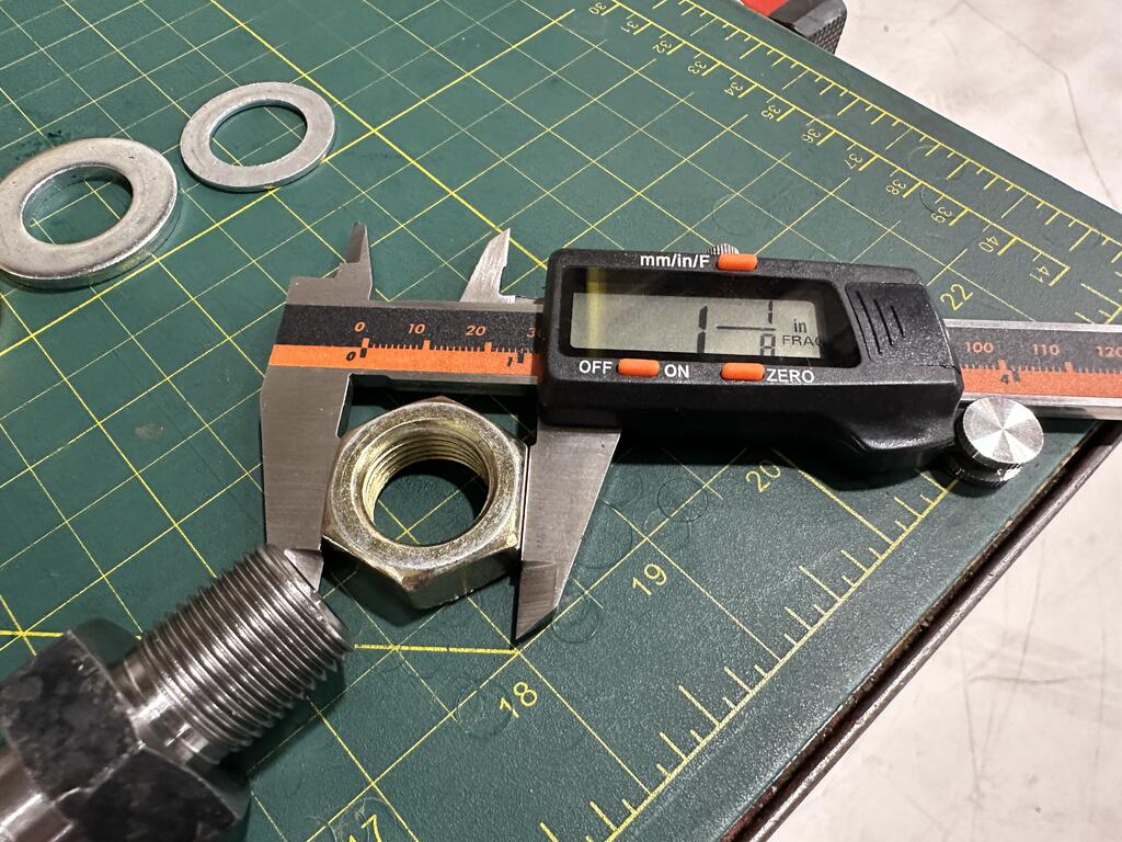

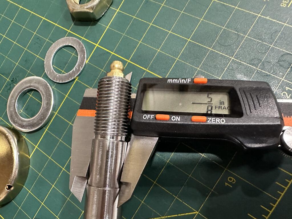

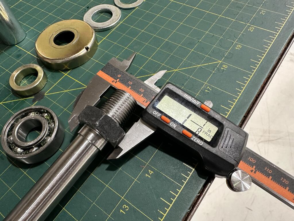

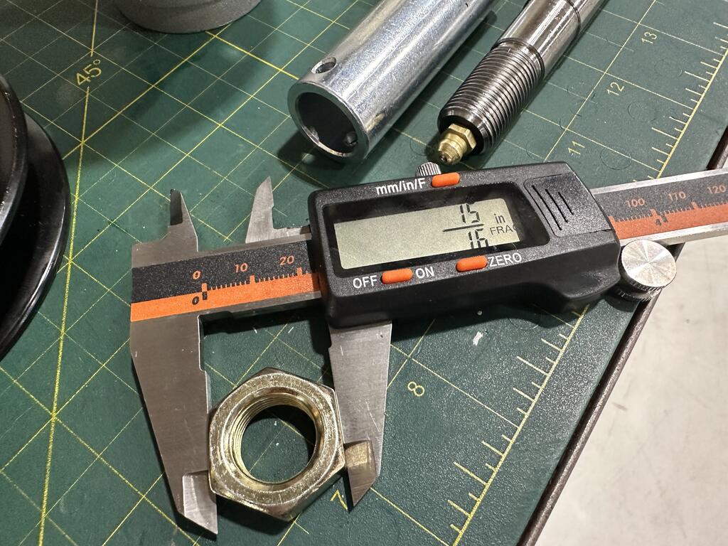

Steve Janninck 171 #12 Posted August 2, 2024 Blade attach area and nut dimensions. 2 Share this post Link to post Share on other sites
Steve Janninck 171 #13 Posted August 2, 2024 Upper pulley attach nut. 2 Share this post Link to post Share on other sites

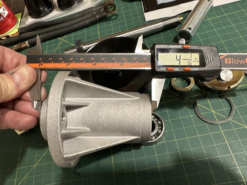

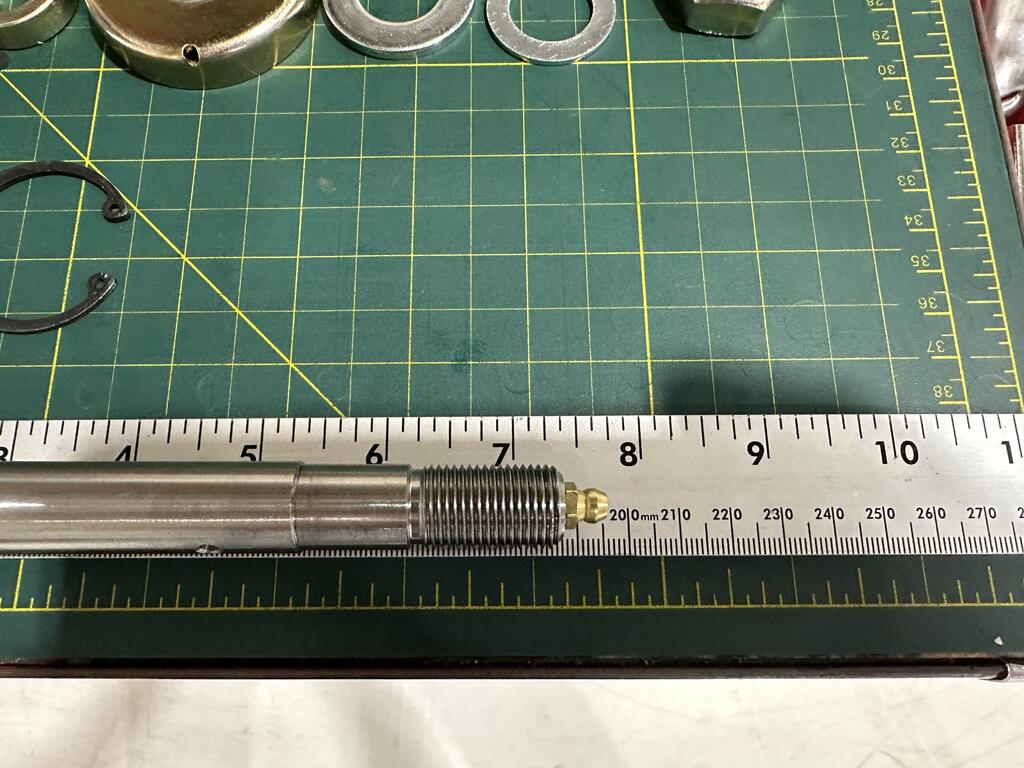

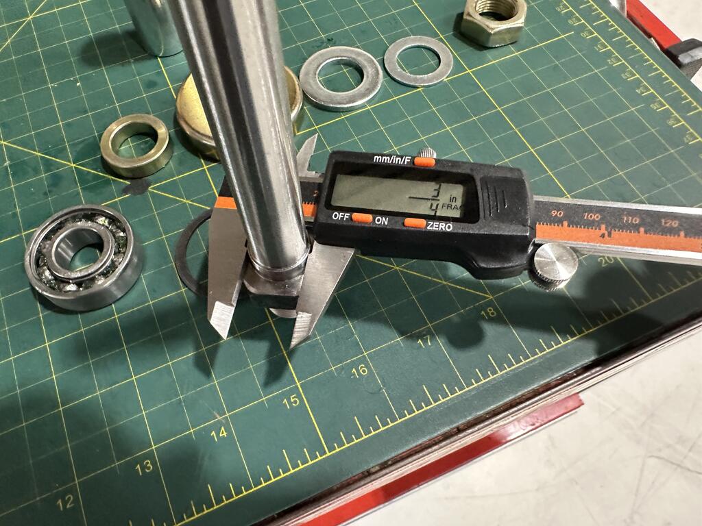

Steve Janninck 171 #14 Posted August 2, 2024 Total shaft length not including the grease zirk is approximatey 7 3/8 inches. The shaft hold hex is 1 1/8 inches. 2 Share this post Link to post Share on other sites

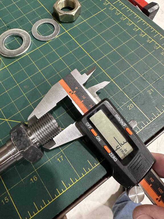

Steve Janninck 171 #15 Posted August 2, 2024 (edited) Shaft collar at lower bearing and pulley shaft dimensions. No key way in the pulley or shaft. Edited August 2, 2024 by Steve Janninck Added comment 2 Share this post Link to post Share on other sites

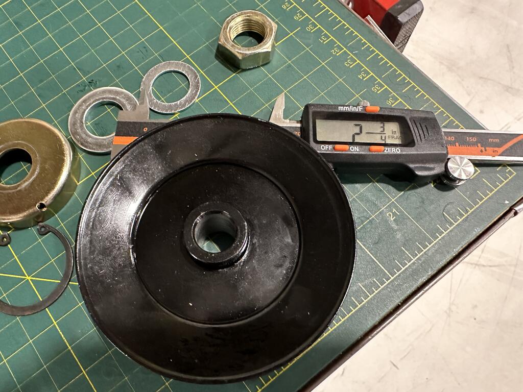

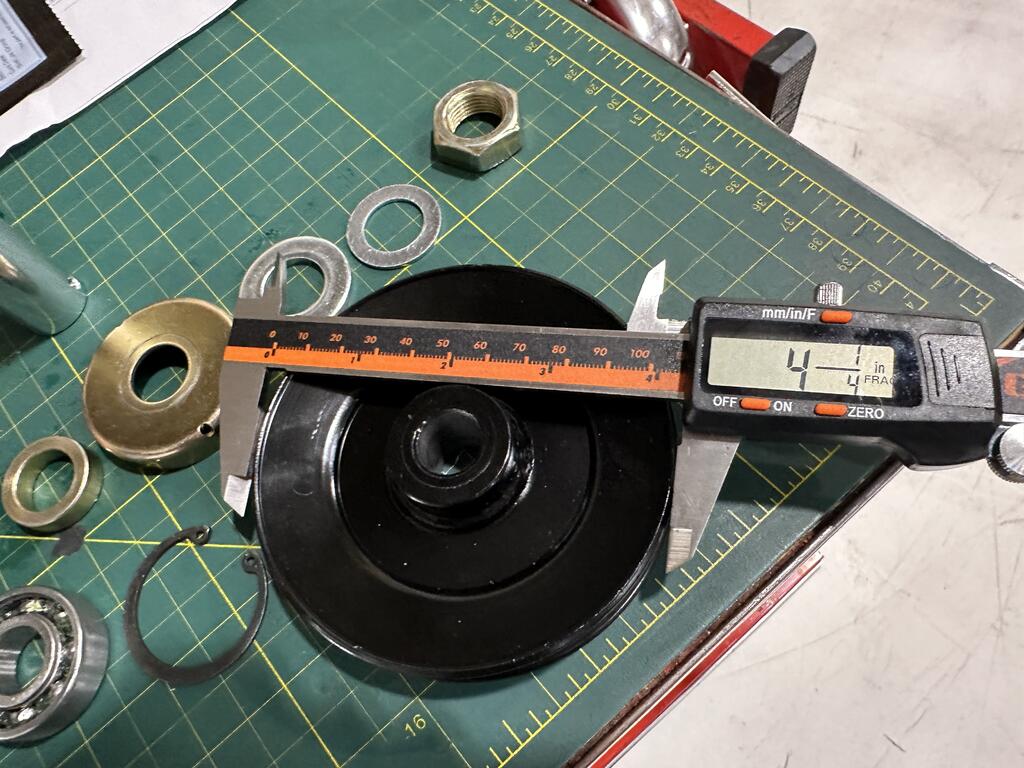

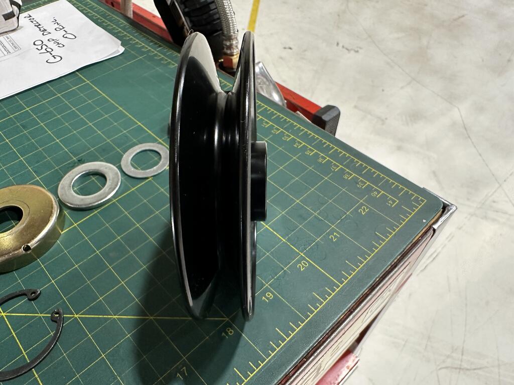

Steve Janninck 171 #16 Posted August 2, 2024 Pulley dimensions. One side of the center flange is flush and the other side extends out about 3/16 of an inch. 2 Share this post Link to post Share on other sites
Steve Janninck 171 #17 Posted August 2, 2024 Casting looks great. Not sure how to qualify the quality. It’s so nice to see housings without corrosion craters! I do think I will get the housing either powder coated or maybe POR 15. 1 5 Share this post Link to post Share on other sites

Wayne0 932 #22 Posted August 2, 2024 The bearings with no seals on the inside allow you to fill the spindle with grease through the zerks and have lube there constantly. 5 Share this post Link to post Share on other sites
