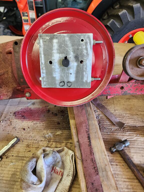

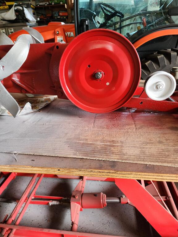

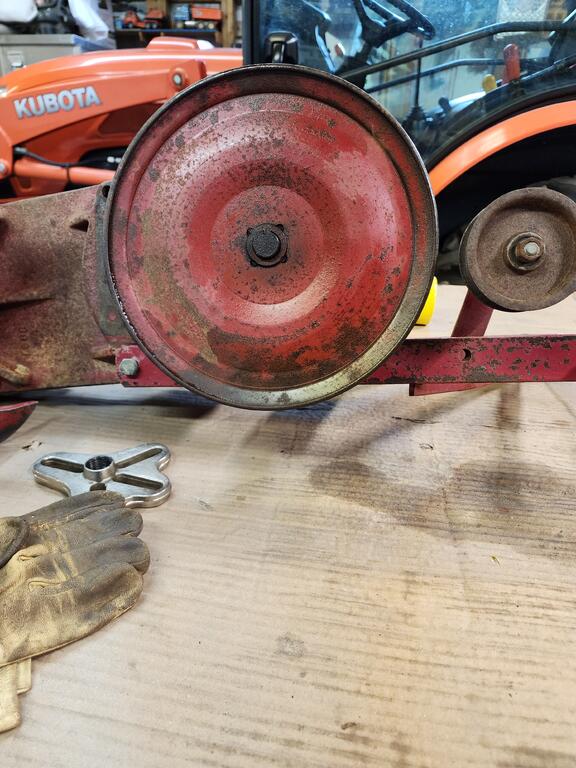

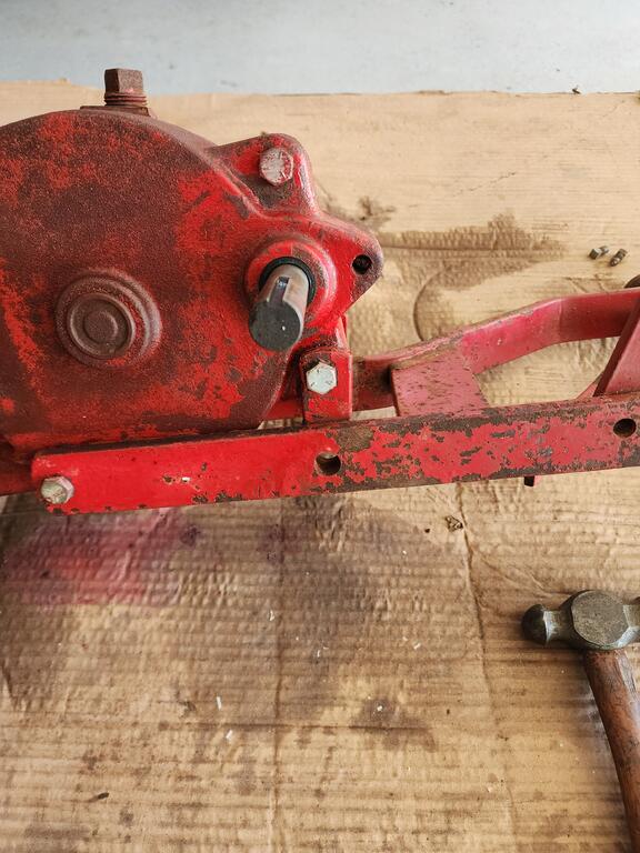

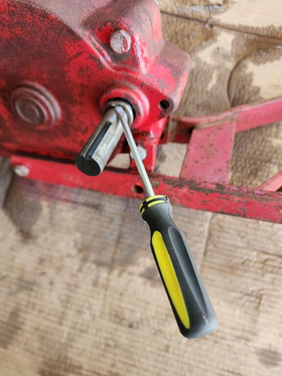

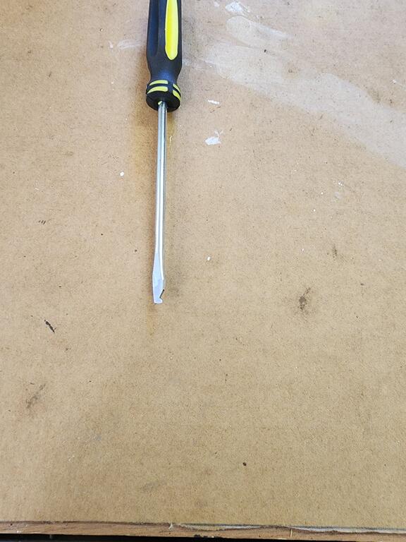

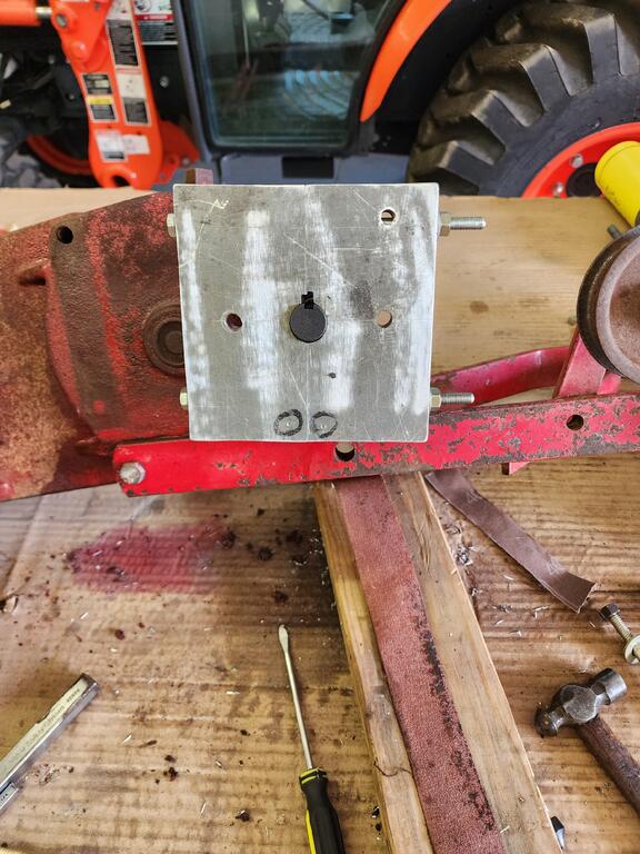

Since the input pulley is large, pulling it is a bit of a problem. I made a puller (plate) to be able to apply pressure to the hub. Using the plate for alignment I drilled two through holes in the pulley. That allowed for passing the puller bolts through the pulley and the plate. Now let me tell you, that hub was in love with the input shaft. The dummy who installed the pulley failed to use anti -  seize on it. I was not happy  :ranting: with him. I performed many cycles of heat and penetrant on it and finally got it apart. Made a seal puller from a small blade screwdriver and pulled the seal. Cleaned things up and installed the new seal. All back together now, ready for the hood.
In case you didn't guess it, I am that dummy.

I understand that the tine seal lip faces inward for the inner seal and outward for the outer seal, but which way should the lip face for the input shaft seal?
  • Like 1
Marv
in
  • Like 2
Woompa
2 hours ago, Marv said:
in
Thanks!
